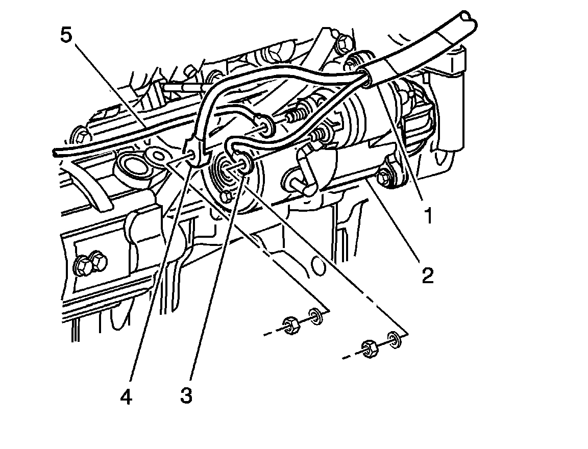

1. Disconnect the negative battery cable.
2. Raise and support the vehicle. Refer to vehicle lifting..
pic 1
3. Disconnect the electrical connectors (3,4) from the starter.

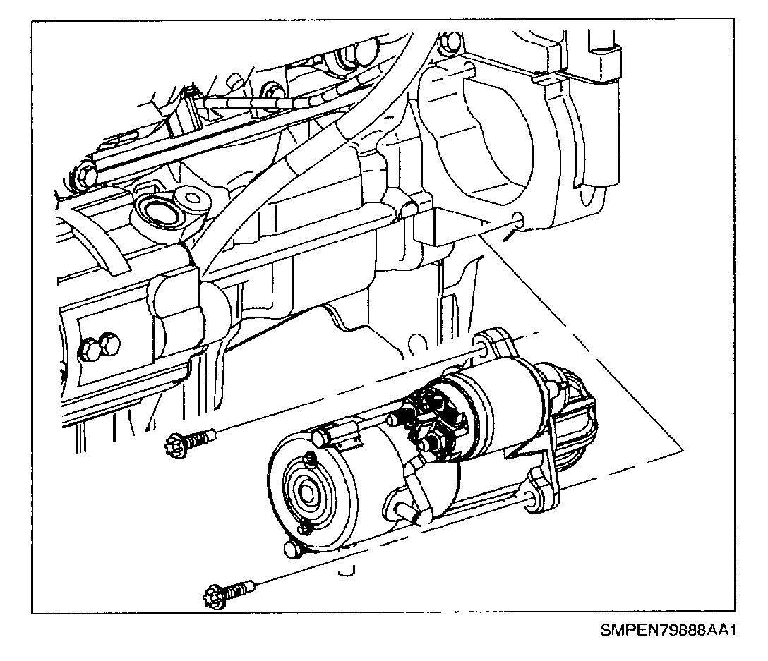

pic 2
4. Remove the starter bolts.
5. Remove the starter.
INSTALLATION PROCEDURE
pic 3
