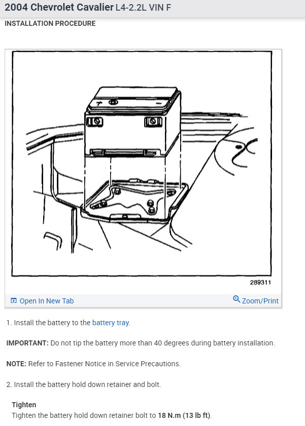

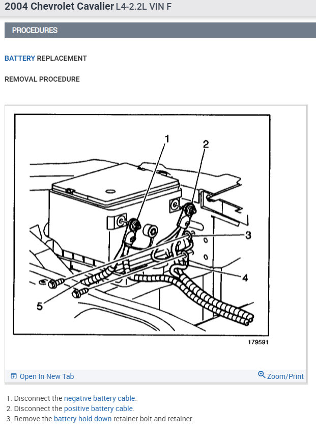

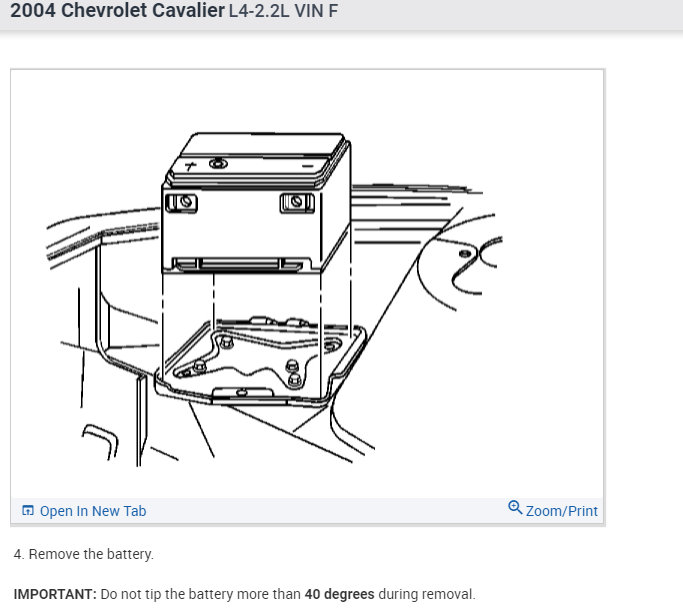

VIPER791
Got the battery load tested by a local auto part shop. My battery was the AC Delco 525 CCA. It was only giving out 243amps. I replaced it with Energizer PG108-75. Its 700 CCA.

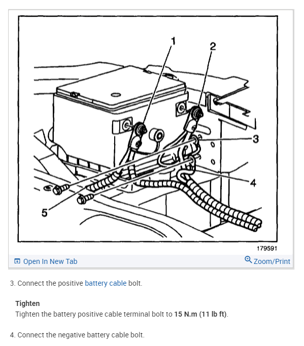

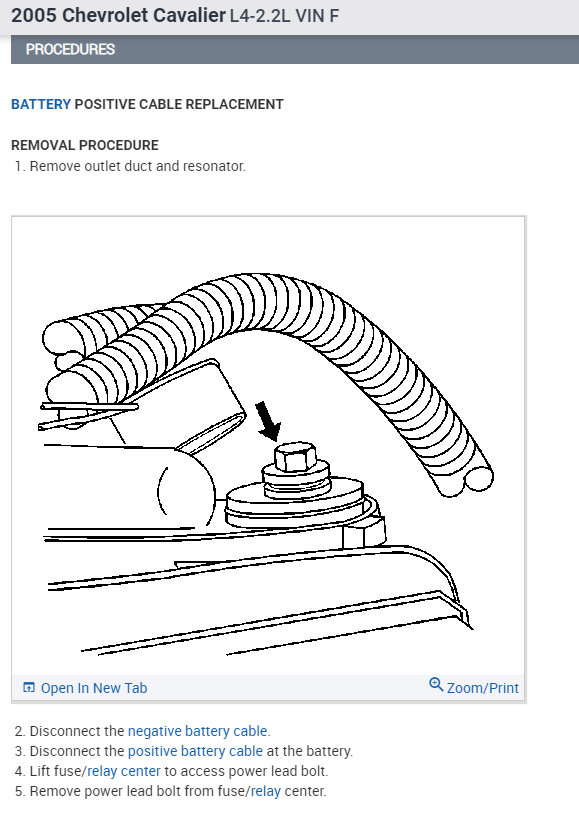

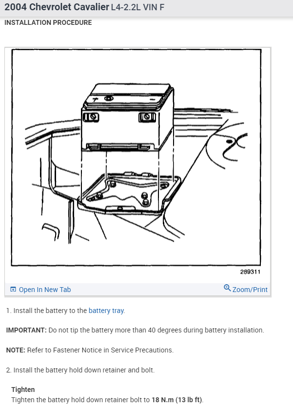

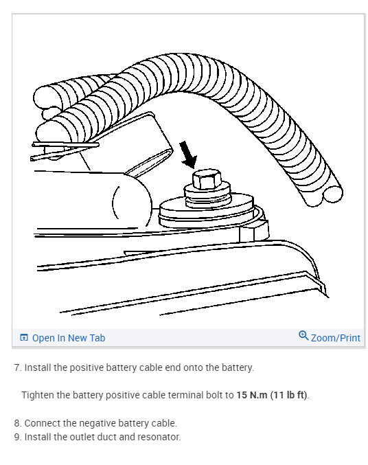

SQM
  • 6,383 POSTS

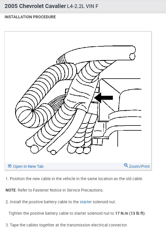

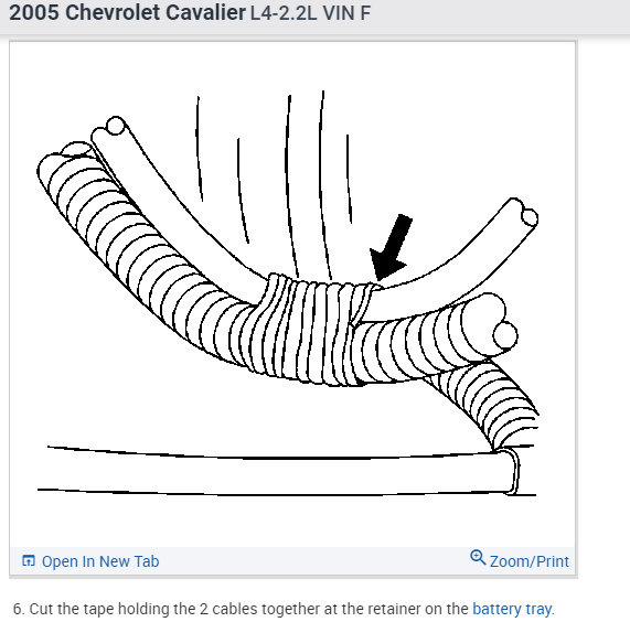

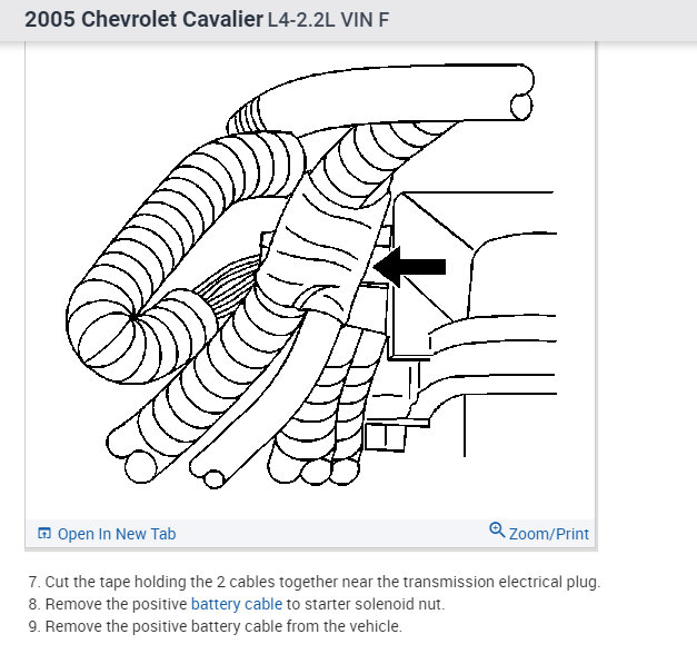

A lot of these vehicles have issues with battery cables being corroded or loose.
That can prevent the engine from starting.
So, it would be a good idea to check the cables and clean and tighten as necessary. The cable might even need replacement.
