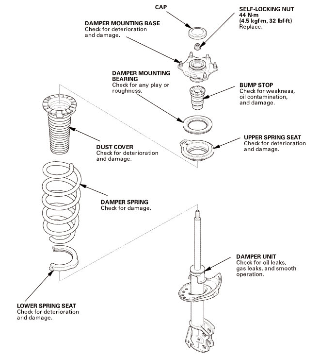

In March, purchased this car from dealer 48,000 miles. After purchase problems started appearing.
At times when hitting series of small bumps either accelerating or while driving front end bounces so many times the front end shimmies like it cannot grip the road. And the bouncing seem to become deeper bounces with each new bounce until the tiny bumps are gone. Shimmies so much you can feel the bounce to your foot on gas pedal. May bounce a dozen times and you feel each bounce.
May happen as I leave house may not happen again for two weeks as I leave house.

What you described sounds like bad struts. The strut assembly includes the shock. If the shock is bad, excessive bouncing will occur. A general rule that I follow is to this. Bounce the front of vehicle. When you stop, the vehicle should bounce no more than three times. If it does, the shock/damper need replaced.
Also, you can check if there are any excessive oil leaks from the shock which could indicate a problem. See the attached picture.
Check for oil leaks from the location indicated in the picture. You will be able to see the top of the strut assembly under the front fenders (behind the top of the tire).
Do this and let me know what you find. The only thing that is confusing me is when shocks/structs fail, it is usually all the time and not something that repairs itself.
Regardless, lets start with this.
Let me know what you find.

Thanks for quick response and information.
I tried pushing front down four to five times and once I stopped, it immediately stopped. Then I remembered it does the dancing bounce when hitting multiple small bumps - so I bounced it twelve times - and once I stopped it immediately stopped.

Since the shocks seem good, do me a favor. This may sound crazy, but check the air pressure in the front tires. Make sure they are not over inflated. Remember, tires absorb a lot of the shock when hitting bumps. If they are over inflated, they may be too stiff to absorb several shocks in a row as you described.

Have had a health issue and could not drive the vehicle. Finally got better and changed the air pressure - and it drives a lot better.
It no longer has occasions where it seems to have problems gripping the road when hitting multiple little bounces..
There are times the 2014 CRV still seems to bounce too much. But today I drove my 2000 S10 and it also seemed to bounce too much. I think after the problem with the 2014 CRV - I started watching for every bounce because I didnt trust the vehicle.
