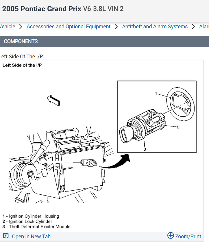

My car is stuck in anti-theft mode. The theft deterrent ring was ripped off from the circuit board. It was soldered back together. I found the key for a short time, but the car ran only a few miles and went back into anti-theft mode. Now that key is gone also. I'm trying to figure out what I need to get my car to run again and I'm on a very limited budget. I found the ignition online, but it looks like it doesn't come with the theft deterrent ring. Is it possible to get a theft ring from a parts car of the same make and model and put it on a new ignition and do the relearn process?

Yes, this is helpful. Thank you. The problem is that the master key is broken off in the lock cylinder and I no longer have the transponder part of the key. I'm not sure if there is a way to remove the broken part from the cylinder or not. That and the theft deterrent ring is broken. Can I get an ignition with the ring from the junkyard and order passkey three keys and then do the relearn procedure? Or will I have to replace the BCM or PCM from the parts car I get the ignition from?

You can get an ignition cylinder and theft deterrent (Passkey III) ring from a donor vehicle. The theft deterrent ring (antenna) simply reads the transponder chip in the key and sends the signal to the BCM.
You do not need to replace the BCM or PCM.
Insert the new key into the ignition and turn it to the "ON" position (do not start the engine).
Leave it in the "ON" position for 10 minutes. The security light on the dash should stay on.
After 10 minutes, the security light should go off. Turn the key to "OFF" and then back to "ON" for another 10 minutes.
Repeat the process one more time (three 10-minute cycles in total).
After the third cycle, the security light should stay off, indicating the system has relearned the key.
Start the vehicle to confirm. Let me know how it goes.
