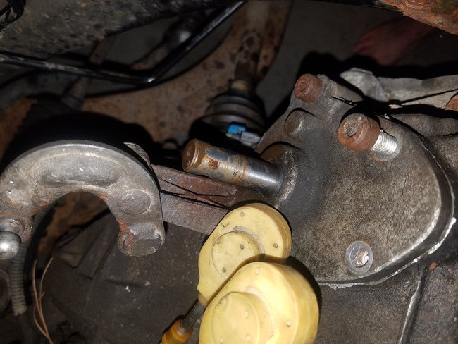

I took apart the shift fork and found the bolt that runs thru it into the shaft going into the tranny Is broke in 3 pieces so when it moves forward and backwards the shaft doesn't move with it
Aug 28, 2016 at 12:58 AM
TRAVIS JONES
  • 24 POSTS
This bolt is broke. I'm having issues removing the part lodged in there
Aug 28, 2016 at 1:01 AM

I had a feeling it was the linkage that's a bolt snapped off?If so you can try to use s punch to spin it out or a reverse drill bit to spin it out.
Aug 28, 2016 at 2:04 AM

Just drilled the bolt out that was in there. Now just trying to find a roll pin to put in its place.
Aug 28, 2016 at 7:50 AM

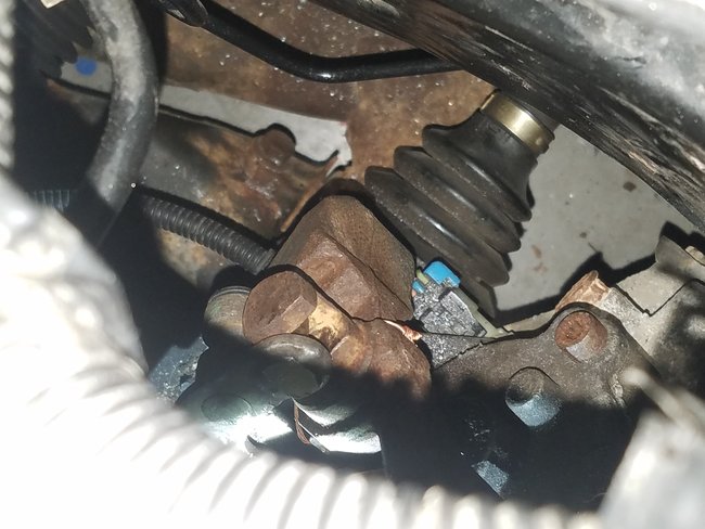

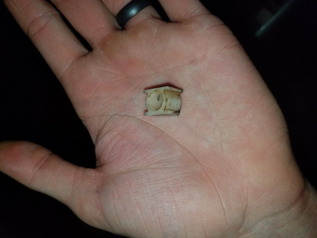

There was a plastic piece for when you move left and right that broke off on the transmission end. Likely that would cause this big of an issue? It's basically like it doesn't quite go all the way into gear unless it gets rammed in
Aug 28, 2016 at 12:21 PM
SATURNTECH9
  • 30,868 POSTS
Can you post some pictures that would really help.
Aug 28, 2016 at 12:24 PM

TRAVIS JONES
  • 24 POSTS
This piece
Aug 28, 2016 at 12:36 PM
TRAVIS JONES
  • 24 POSTS
Where the notch is where it goes

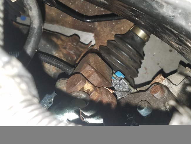

TRAVIS JONES
  • 24 POSTS
Another
Aug 28, 2016 at 12:37 PM

  • 30,868 POSTS
We need to replace that piece and lube everything up with deep creep.
Aug 28, 2016 at 12:48 PM

Aug 28, 2016 at 7:19 PM
SATURNTECH9
  • 30,868 POSTS
Can you try to take a nice picture of the assembly all bolted up and post it?Iam having trouble finding that part Iam still looking.I would call it the shift tower.
Aug 29, 2016 at 10:24 AM
