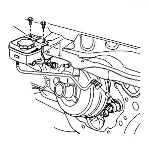

I want to find out were the clutch fluid goes? I only see brake and oil, cooling
Jul 29, 2019 at 5:16 AM (Merged)
BLUELIGHTNIN6
  • 16,542 POSTS
goes into resevoir that is pictured below
https://images.2carpros.com/forum/automotive_pictures/261618_Graphic_567.jpg

this resavouir is the same as brake
BLUELIGHTNIN6
  • 16,542 POSTS
yes it is the same, both brakes and clutch use DOT 3 hydraulic fluid
JUAN PéREZ
Same hydraulic fluid reservoir supplies both brake and clutch master cylinders.
