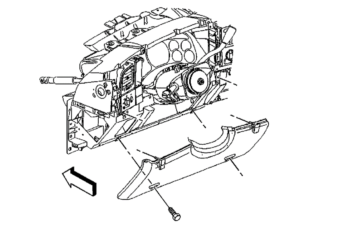

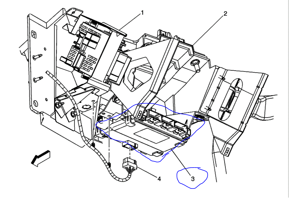

I just went through wiring schematic for the A/C, exterior light, and headlamps. Nothing it tied together for all of them except the body control module.
Before I suggest replacing anything, check the body control module (BCM) connection for corrosion, damage, make sure it's tight.
The BCM is below the steering column. You need to remove the plastic cover under the column to get good access. See pics 1 and 2.
Now, there are a number of fuses that can cause issues, but none of them will deal with all the issues you have. Also, the lights, A/C, headlamps have different grounding locations. So, that doesn't seem like the cause. That is why I'm suspecting something has happened at the BCM.

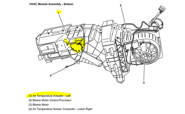

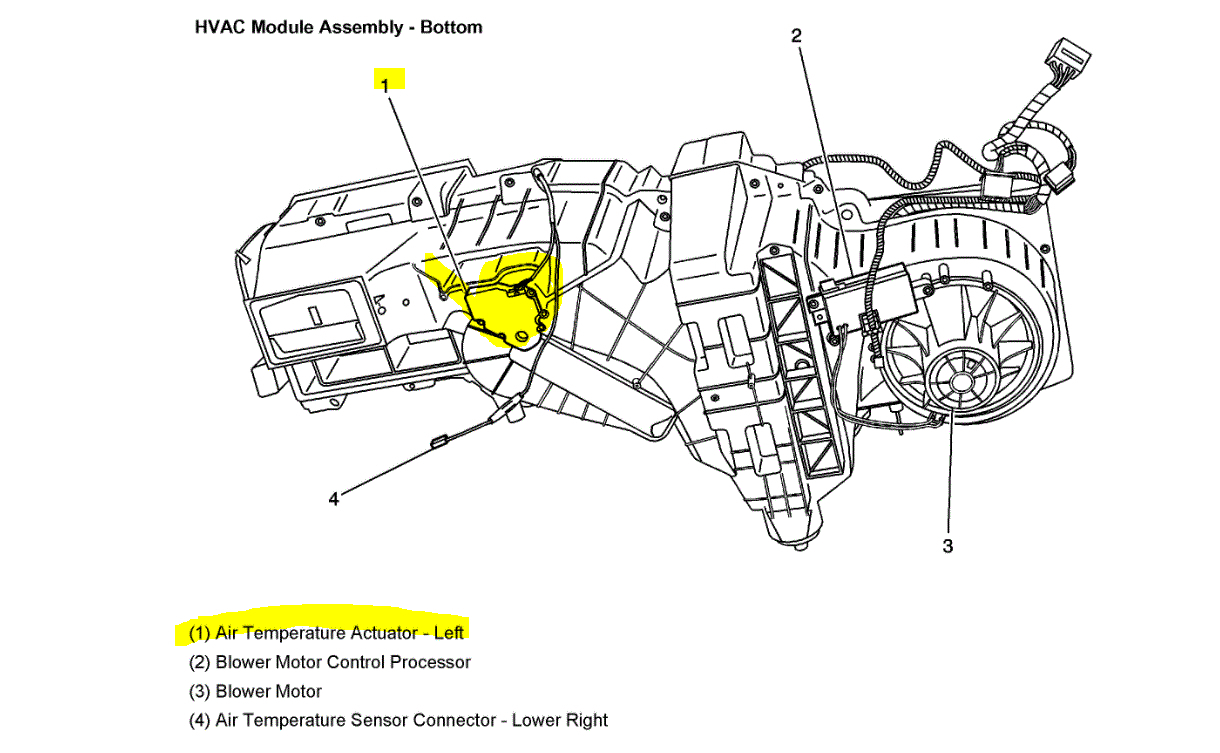

Just one more thing. air is coming on it's cold on passenger side but very hot on drivers side. just wanted to let you know. Still trying to check out DCM, but there is a hurricane going on right now in my area. so still hunkered down.

The heat on one side and A/C on the other is usually the result of a faulty blend air door. Here is a link that explains how in general to replace one:
I attached a pic below that shows where it is located on your truck.
Let me know if that helps.
