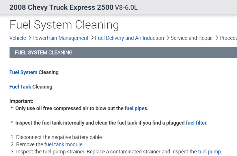

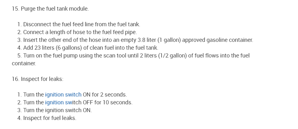

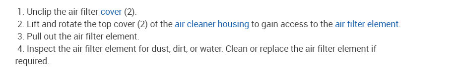

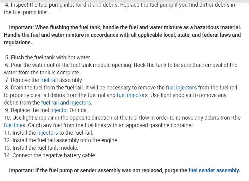

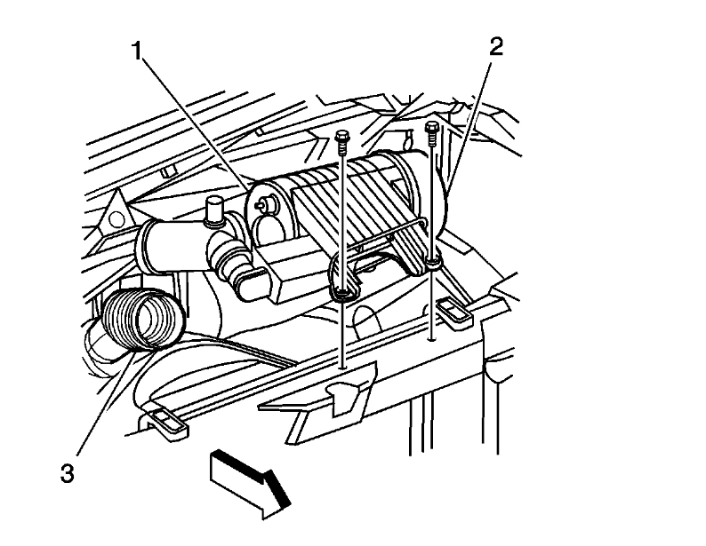

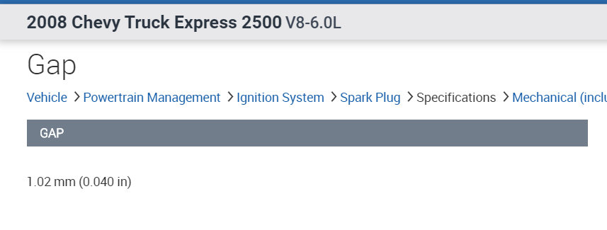

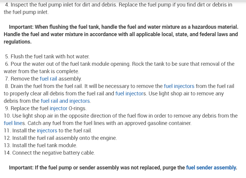

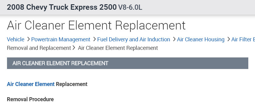

You might want to double check the spark plug gap which I have included in the diagrams down below. You might also verify that the air filter has been replaced and that the fuel system is clean and working as it should. I have also included in the diagrams down below the factory guides for replacing your vehicle's air filter and cleaning it's fuel system. Please go through these guides and get back to us with what you are able to find out.

I did find bad spark plugs and replaced them and a new set of wires. Pulled the fuel tank module and the tank is shiney clean inside, no debris. It runs and idles real good and smooth, but it still has a slow acceleration response. No engine codes. I also cleaned the throttle body. I'm just attempting to get away without having to pay a high cost of a shop diagnosis.

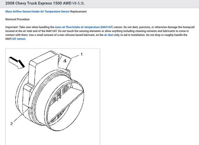

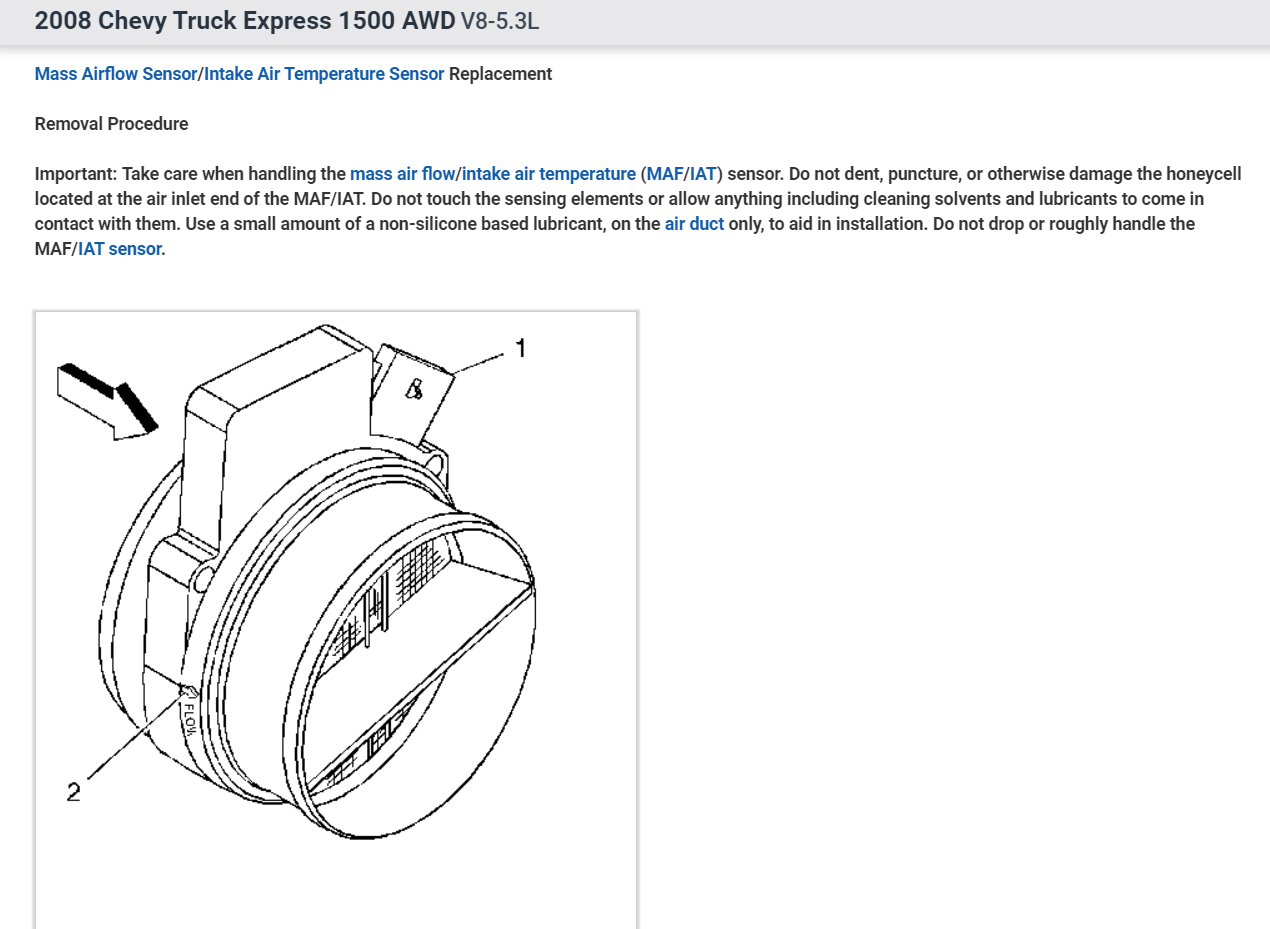

If I could jump in as well. I would check the catalytic converter and replace the MAF with a new unit. if the catalytic converter is okay here are two guides to help us find out:

I see he MAF reading and they can be a little low causing the PCM to think the amount of air entering the engine is less than it really is in turn reducing fuel and power. I would try a new MAF sensor which if you have not replaced with that many miles I would do it. This sensor is a normal service replacement item. Also check the air filter. Check out the diagrams (below). Please let us know what happens.
