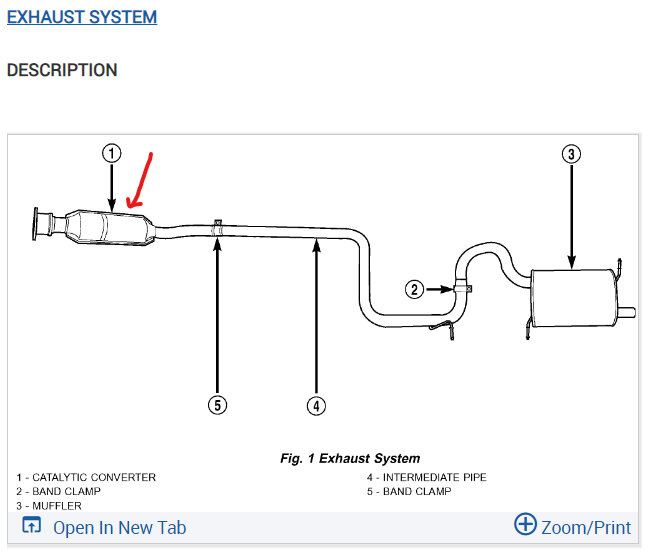

So, these codes don't have anything to do with engine power, to me it seems like the exhaust system is clogged due to a bad catalytic converter. But to be sure to read through this guide can help us:
You also can take a rubber mallet and tap the exhaust system to see if you can hear anything loose inside.

Check out the images (below). Please upload pictures or videos in your response to the problem so we can see what's going on.

if the cat is plugged or not working properly shouldn't it be setting a code?
Jan 17, 2024 at 8:07 PM
  • 55,447 POSTS

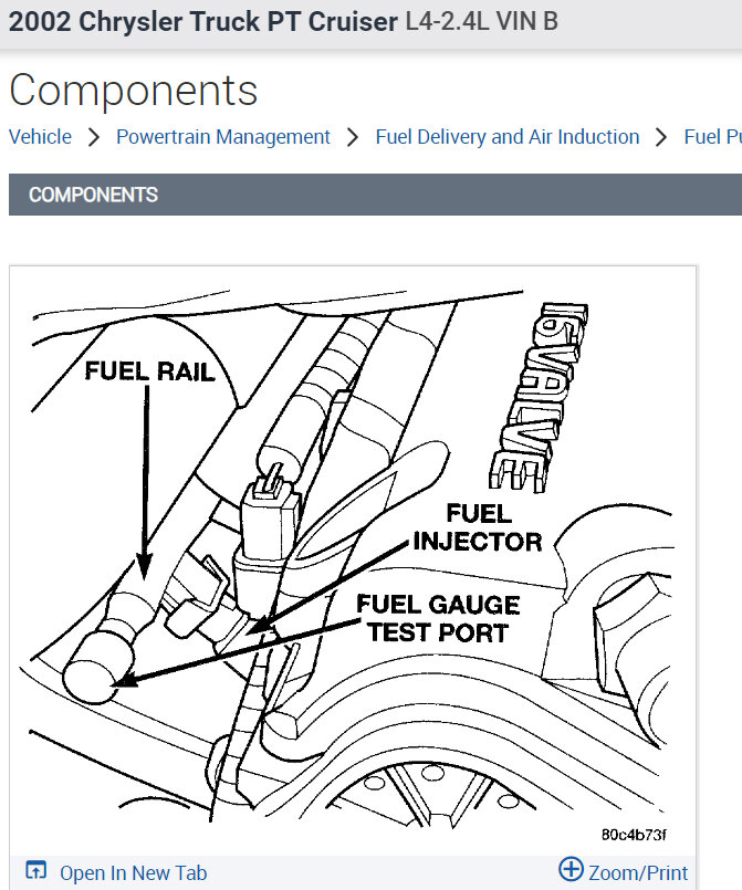

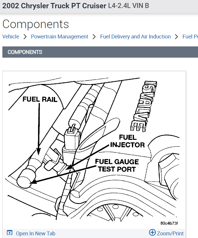

It should, but not always. The other problem could be is a fuel pump is starting to go out. When the engine is low on power, we can do a fuel pressure test.
Here are two guides to help us:
https://www.2carpros.com/articles/engine-has-low-power-output
and
Fuel System Pressure
Regulated Pressure 400 +/- 34 kpa (58 +/- 5 psi)
You can rent a gauge from the auto parts store for cheap or free. Check out the images (below). Let us know how it goes.
