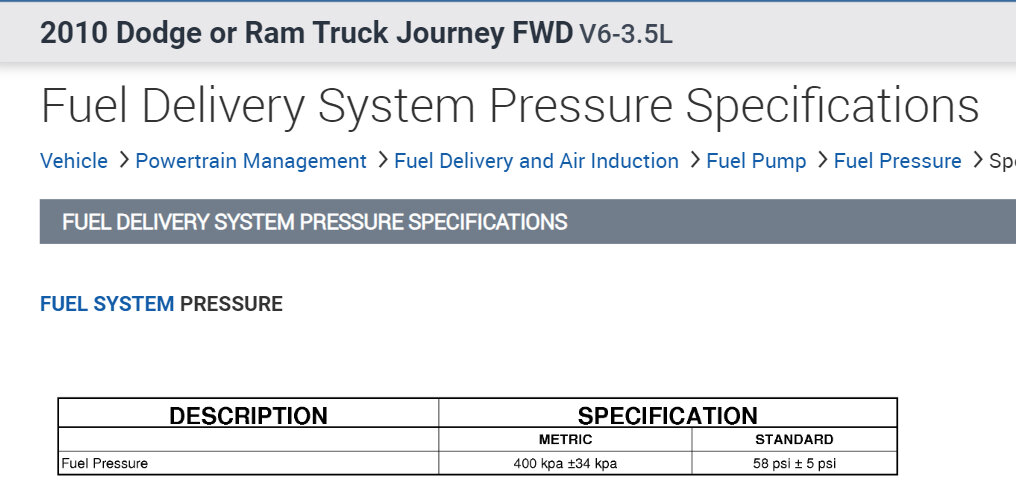

This weekend alone I've replaced the cam and crankshaft sensors, alternator, starter, and throttle body. It starts up first try until engine gets hot then shuts off Rev limit goes to around 4,000 RPMs and acceleration has low power. any help is appreciated. my next guess is fuel pump and filter.

As far as the fuel pump is concerned, before I would go to the trouble of replacing it and the filter, I would recommend checking fuel pressure.
Here is a link that explains how it's done:
You will need a fuel pressure gauge to do this, but if you don't have one, most parts stores will lend one to you. Also, I attached the manufacturer's fuel pressure specifications below.
See pic below.
