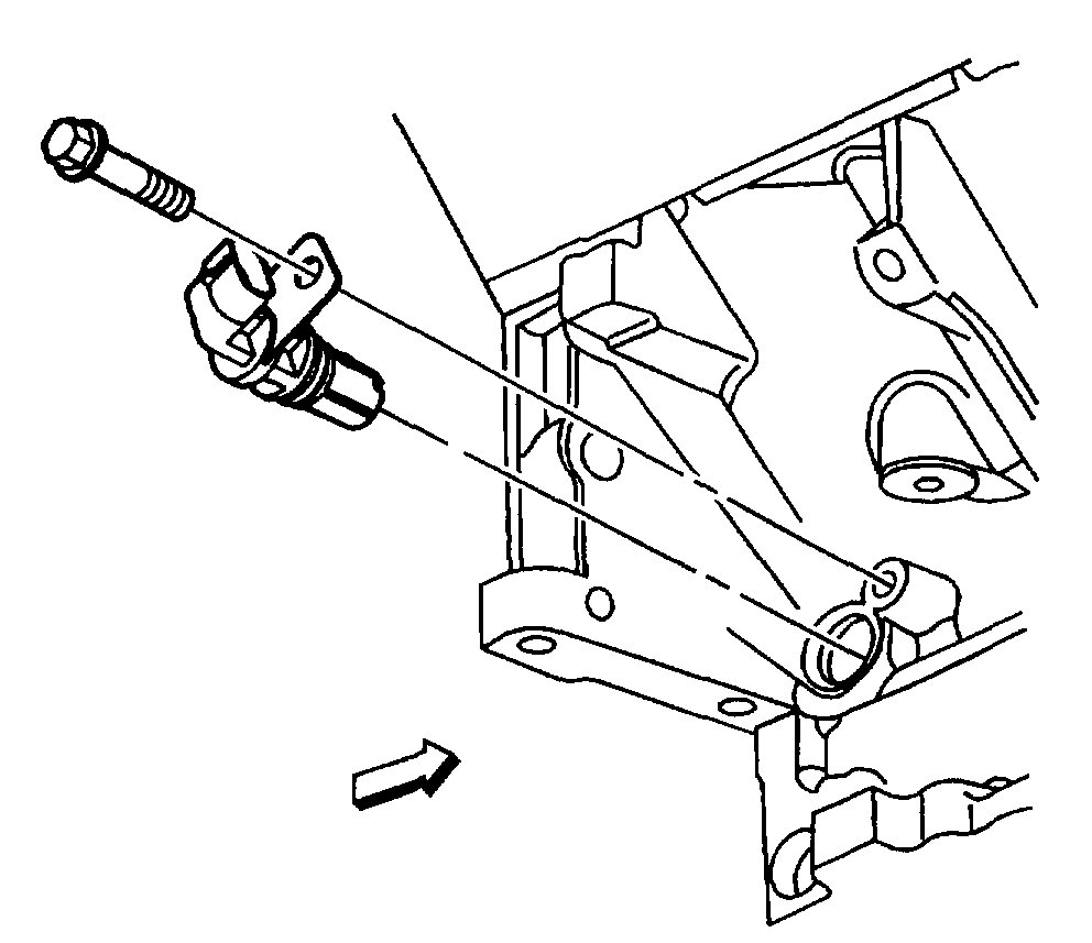

I bought the truck about 6 months ago. 2 weeks after I got it I had to replace the fuel pump. When my truck has been running for about 20 minutes and it's warm out it starts to bog out (lose power/hesitates honestly it sounds like a tractor) and backfire. I can press the gas to the floor and nothing happens. If I turn the truck off and let it sit for 15-20 minutes and start it back up it runs completely fine. I've also done a complete tune up plugs, wires, air filter, oil change. I've tried fuel injector cleaner i am at a loss. Where would start for replacing parts? Help please!

The idea that it runs properly when you allow it to cool off leads me to think it could be related to the crankshaft position sensor. When they start going bad, they are adversely affected by heat. Take a look through this link and let me know if it seems to mirror what you experience:
When you get a backfire, oftentimes it is related to a fuel-related issue (too much fuel), but that wouldn't only happen when it's hot. That is what is leading me in the direction I mentioned.
If you find the sensor is bad, here is a link that shows in general how one is replaced. It will help as a guide.
Here are directions specific to your vehicle. The pics below correlate with the directions. You will need to remove the starter to access the sensor, so make sure the battery is disconnected before you start.

REMOVAL PROCEDURE
IMPORTANT: Perform the CKP System Variation Learn Procedure whenever the crankshaft position sensor is removed or replaced.
pic 1

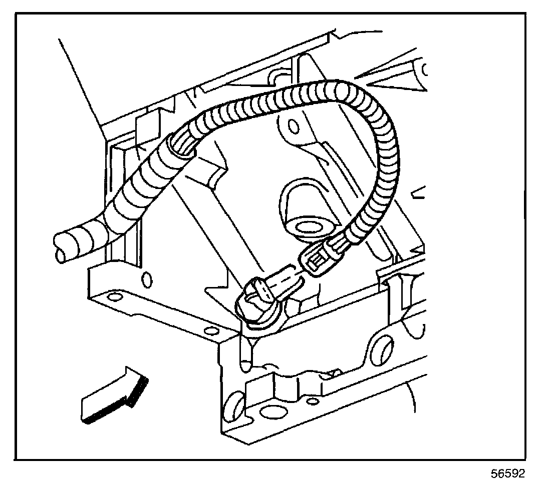

1. Remove the starter.
2. Disconnect the crankshaft position (CKP) sensor electrical connector.
Crankshaft Position Sensor (CKP)
pic 2
3. Clean the area around the CKP sensor before removal in order to avoid debris from entering the engine.
4. Remove the CKP sensor bolt.
5. Remove the CKP sensor.
pic 3
INSTALLATION PROCEDURE
1. Install the CKP sensor.
NOTE: Refer to Fastener Notice in Service Precautions See: Powertrain Management > Vehicle Damage Warnings > Fastener Notice.
2. Install the CKP sensor bolt.
Tighten
Tighten the bolt to .................................25 N.m (18 lb ft).
