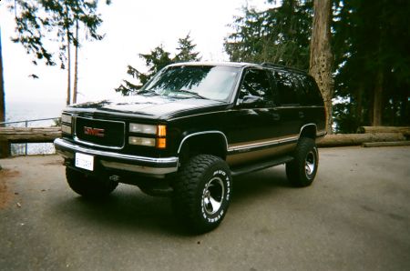

Run good until you fill the tank up then it seems to have loss of power under a load like up hills and you can hardly give it gas without it bogging out. When gas gets below half tank it seems to run better but still stalls a little when stomping on the peddle. No check engine light and it just passed emissions. Could it be the fuel pump or filter. It's just strange it gets worse with fill up PLEASE HELP ME!!

That is odd, what you need to do is get a manual fuel pressure gauge on it to see what its doing when the tank is full pressure-wise vs. Fuel pressure before the fill up, this will at least give some direction to go in
