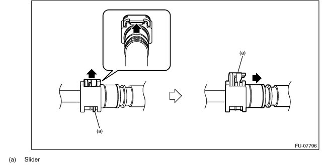

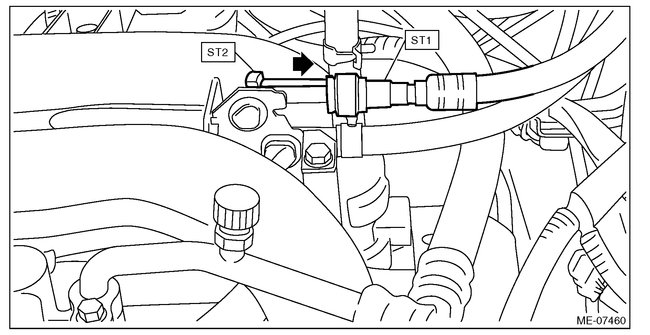

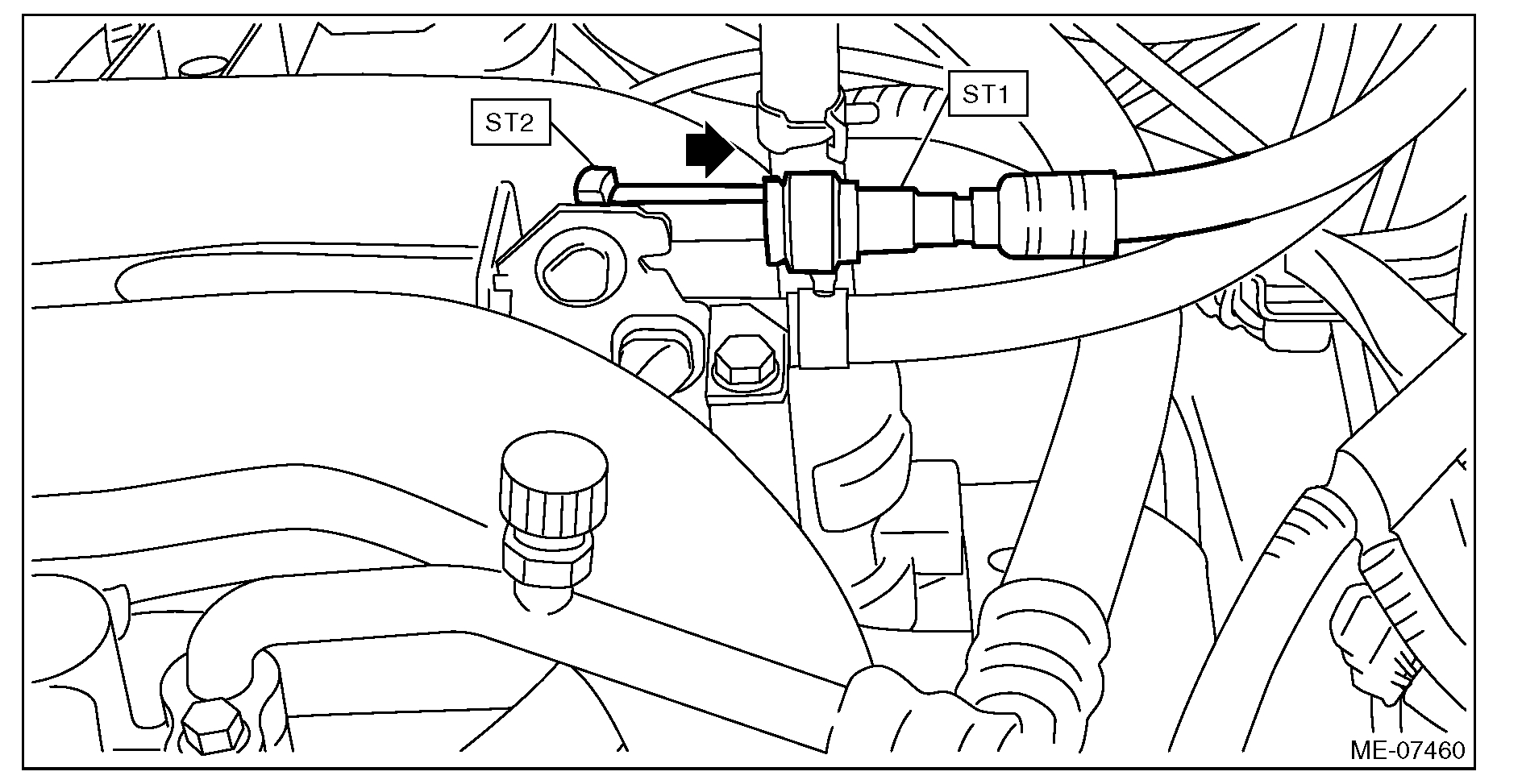

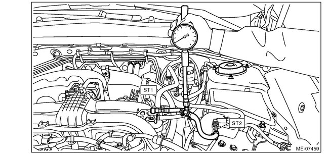

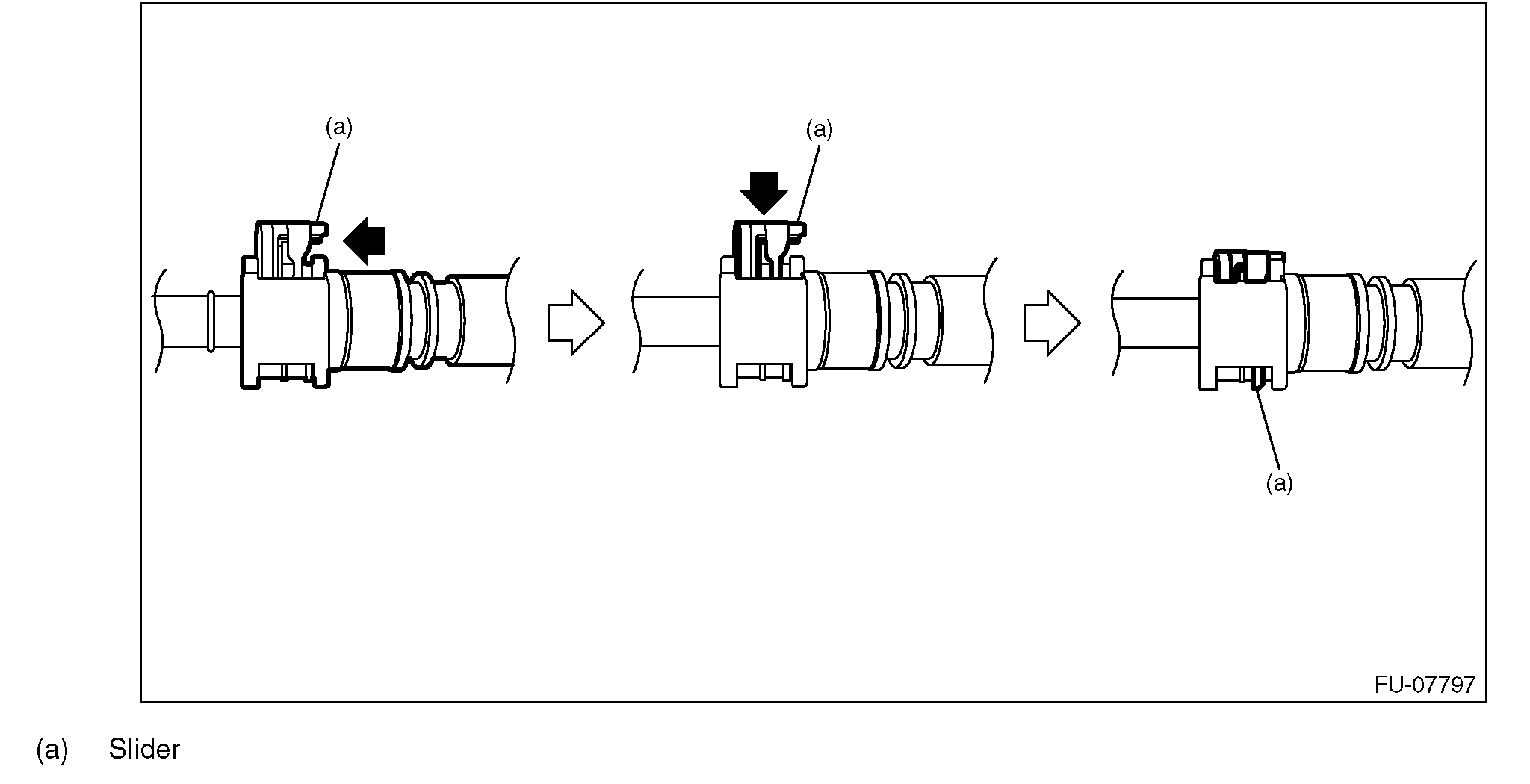

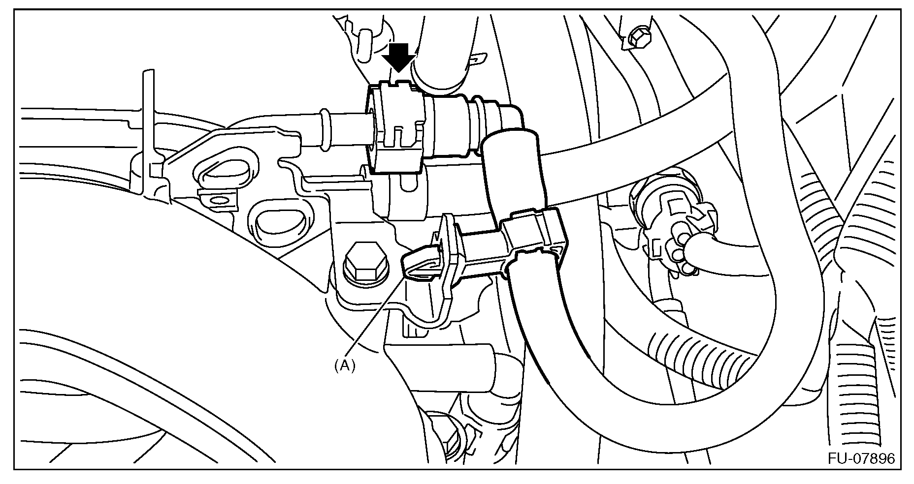

Here are the directions specific to your vehicle for testing fuel pressure. The attached pics correlate with the directions and the manufacturer's specs are included in the directions.

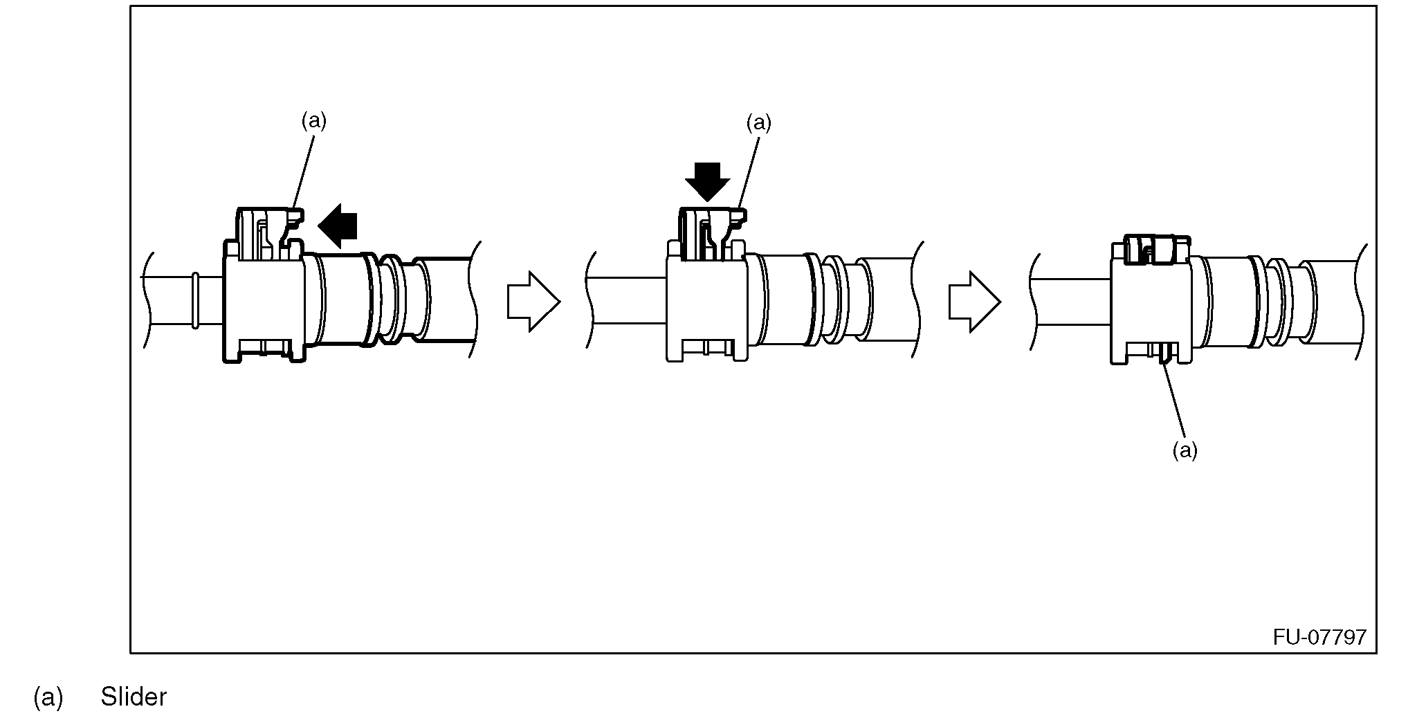

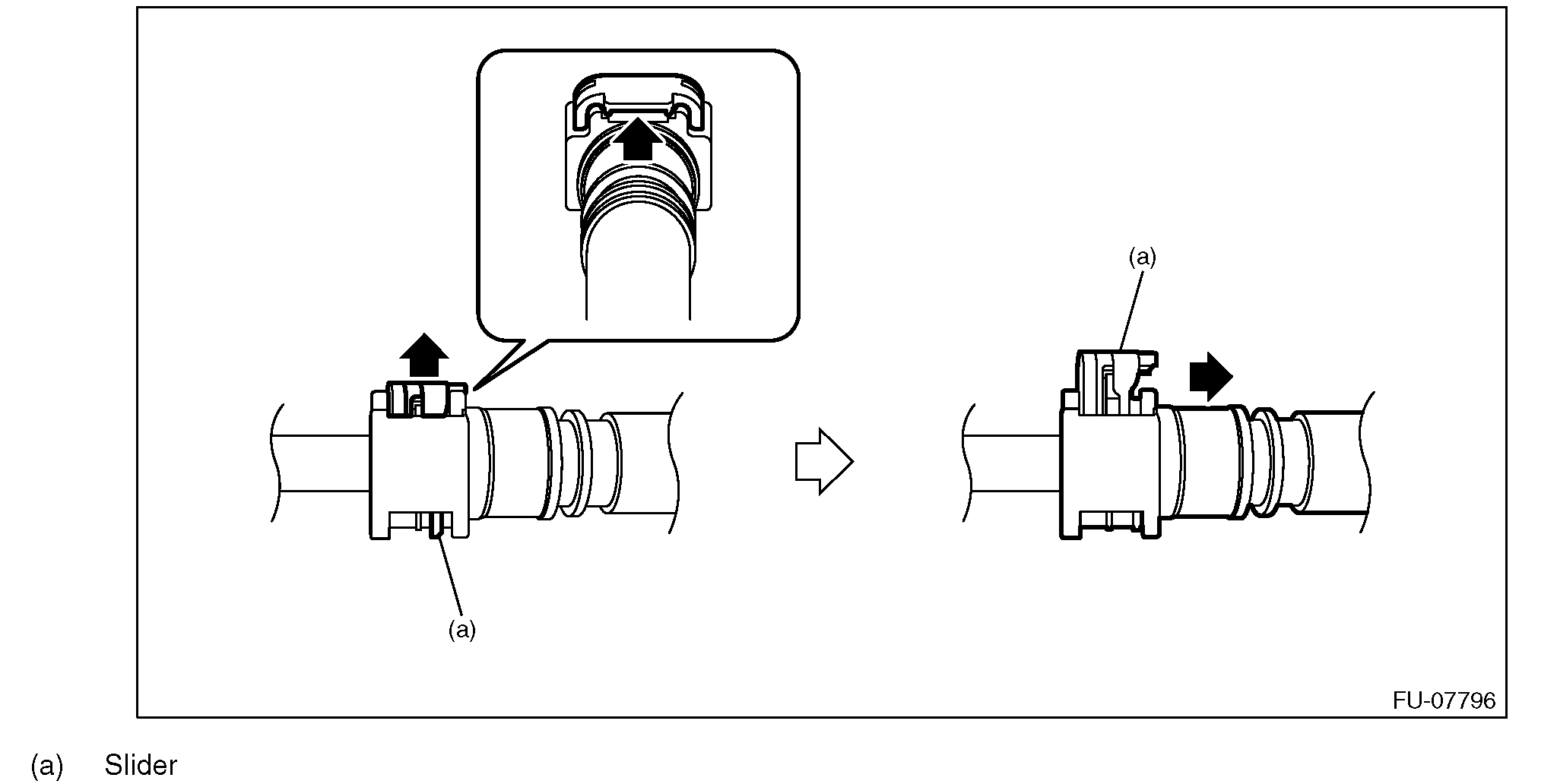

1. Disconnect the quick connector on the fuel delivery tube from the fuel pipe assembly, and remove the clip (A) securing the fuel delivery tube to the fuel pipe assembly.
NOTE: Disconnect the quick connector as shown in the figure.
pic 1
pic 2
2. Connect the fuel pressure gauge with ST1 and ST2.
CAUTION:
- Check that there is no damage or dust on the quick connector. If necessary, clean the seal surface of the ST2.
- Make sure that the quick connector is securely connected.
NOTE:
- ST1 is a SUBARU genuine part.
- When connecting the ST2 to the quick connector on the fuel delivery tube, connect as shown in the figure.
pic 3
ST1 42075AG690 FUEL HOSE
ST2 18471AA000 FUEL PIPE ADAPTER
pic 4
4. Start the engine.
5. Check the fuel pressure after warming up the engine.
NOTE:
- The fuel pressure gauge registers 10 to 20 kPa (0.1 to 0.2 kgf/cm2, 1 to 3 psi) higher than standard values during high-altitude operations.
- Check or replace the fuel pump and fuel delivery line if the fuel pressure is out of the standard.
Fuel pressure:
Standard: 340 - 400 kPa (3.5 - 4.1 kgf/cm2, 49 - 58 psi)

NOTE:
- When disconnecting the ST1, install the ST2 to the fuel pipe assembly, and press the ST2 in the direction of arrow to disconnect the quick connector on the ST1.
ST2 42099AE000 QUICK CONNECTOR RELEASE
pic 5
- Disconnect the quick connector on the fuel delivery tube as shown in the figure.
pic 6
- Connect the quick connector on the fuel delivery tube as shown in the figure.
pic 7
