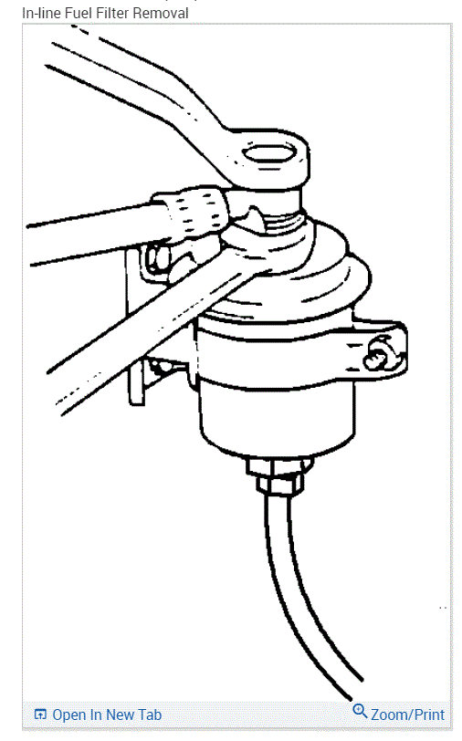

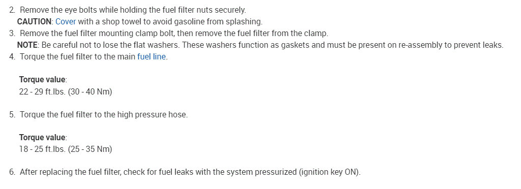

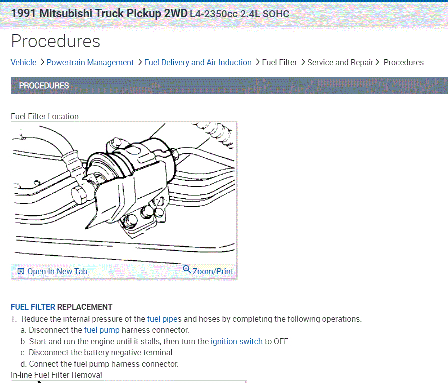

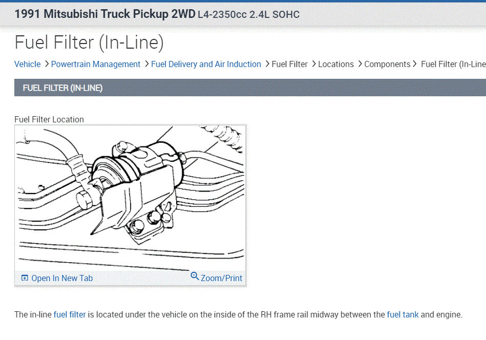

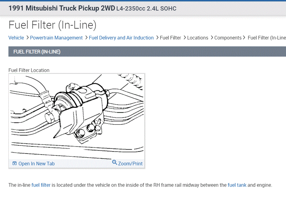

If the fuel filter has never been changed, it would be a good idea to do it. It may or may not be the issue, but it is basic maintenance. If you look at the pics below, it shows the location. Pics 2-4 are the directions for removal and replacement.
