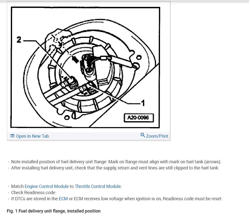

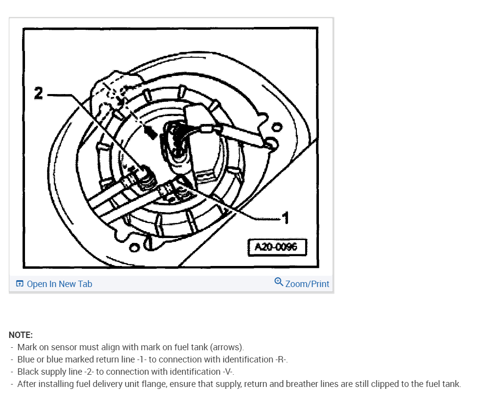

The car runs fine, then sputters and loses power. When the tank is full after gassing up it runs fine again but loses power again after a while. The scanner says 2 and 4 cylinders are not firing. O2 sensors etc... This happens intermittently. I think fuel pump or relay. Car starts fine, so maybe not??? Help!
Aug 4, 2022 at 1:53 AM
  • 55,273 POSTS

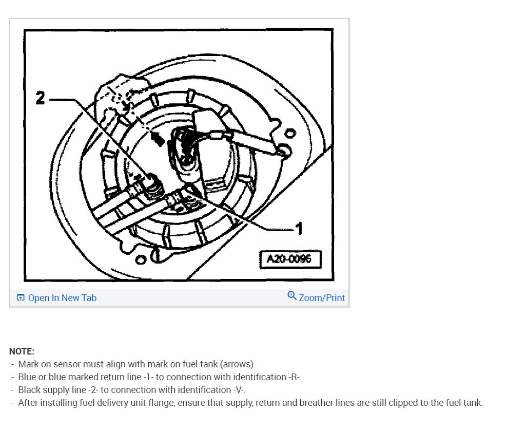

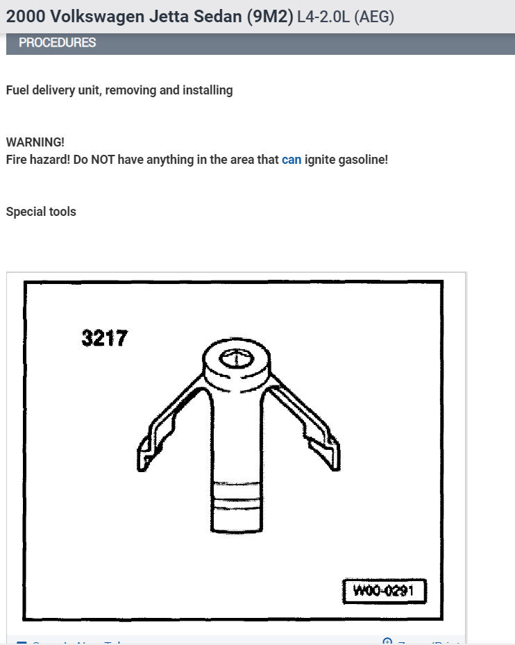

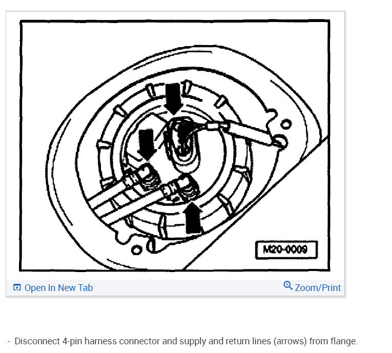

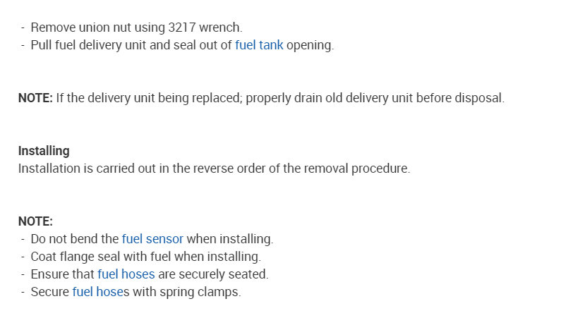

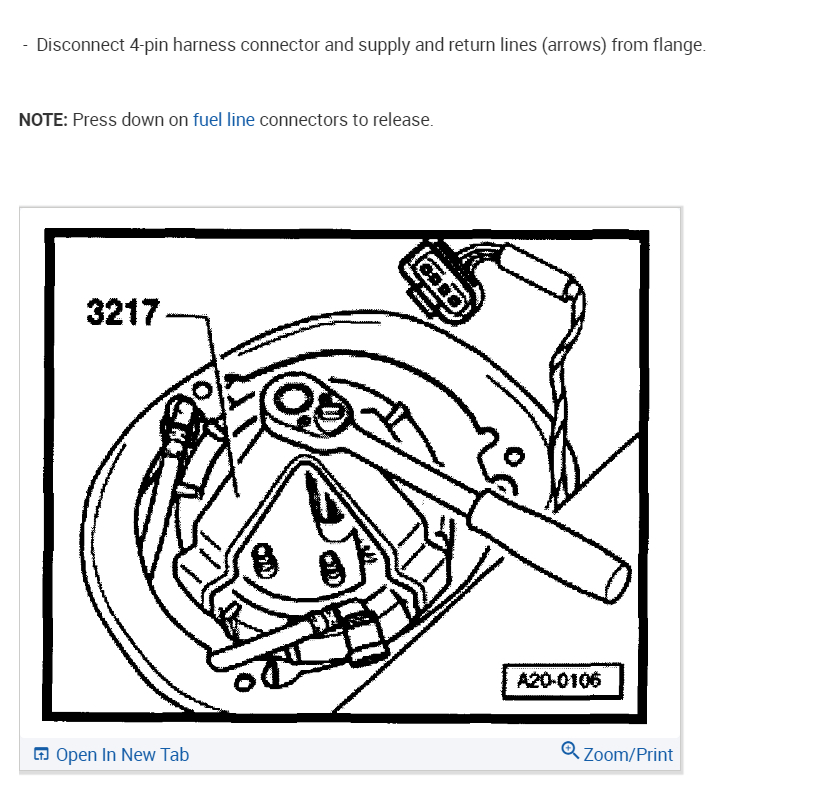

The fact that it runs okay when full of gas says fuel pump, here are the instructions on how to change it out in the diagrams below. Check out the diagrams (below). Please let us know if you need anything else to get the problem fixed.
