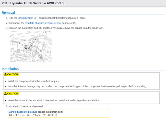

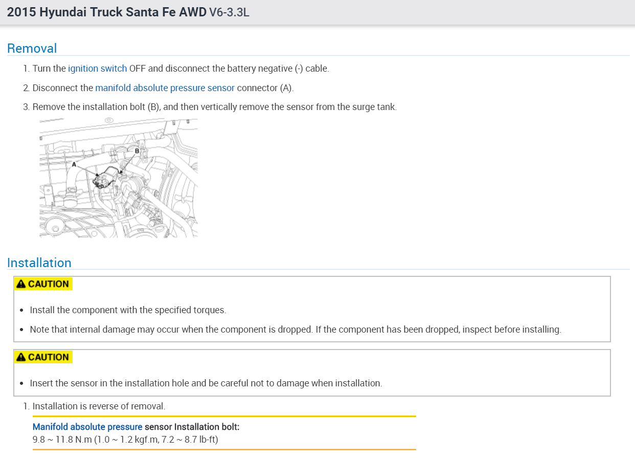

If I may jump in here. it sounds like the MAP sensor may have changed but not enough to cause a check engine light which is common. I would run the codes by following this guide.
Here is the location of the MAP sensor in case you want to swap it out. Below. Check out the diagrams (below). Please let us know what happens.
