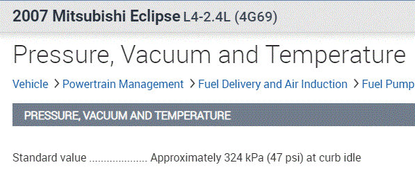

I watched your video, and it could be a fuel-related issue. By any chance, have you checked fuel pressure to see if it is within spec? Here is a link showing how it's done if you haven't:
Pic 1 below provides the manufacturer's pressure specifications.

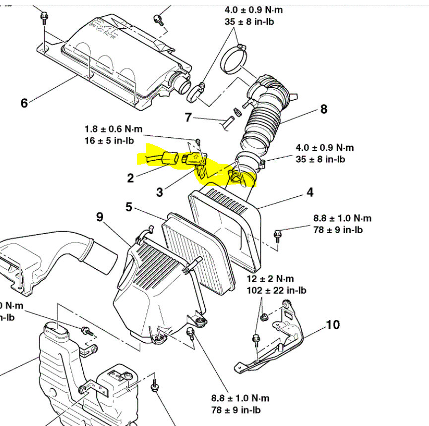

I want you to disconnect the mass airflow sensor and see if the issue improves or goes away. The MAF is located on the air intake tube between the air filter box and the throttle body. See pic 2 below.

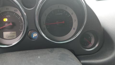

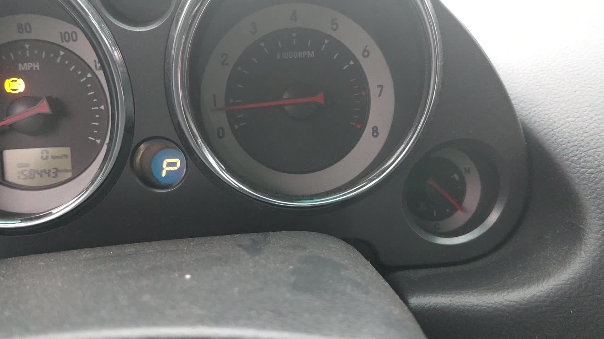

One last question. At the end of the video, the engine would hardly rev in park. Does the engine smell like it's running rich or is there any black or gray smoke from the exhaust?
See pic below.
