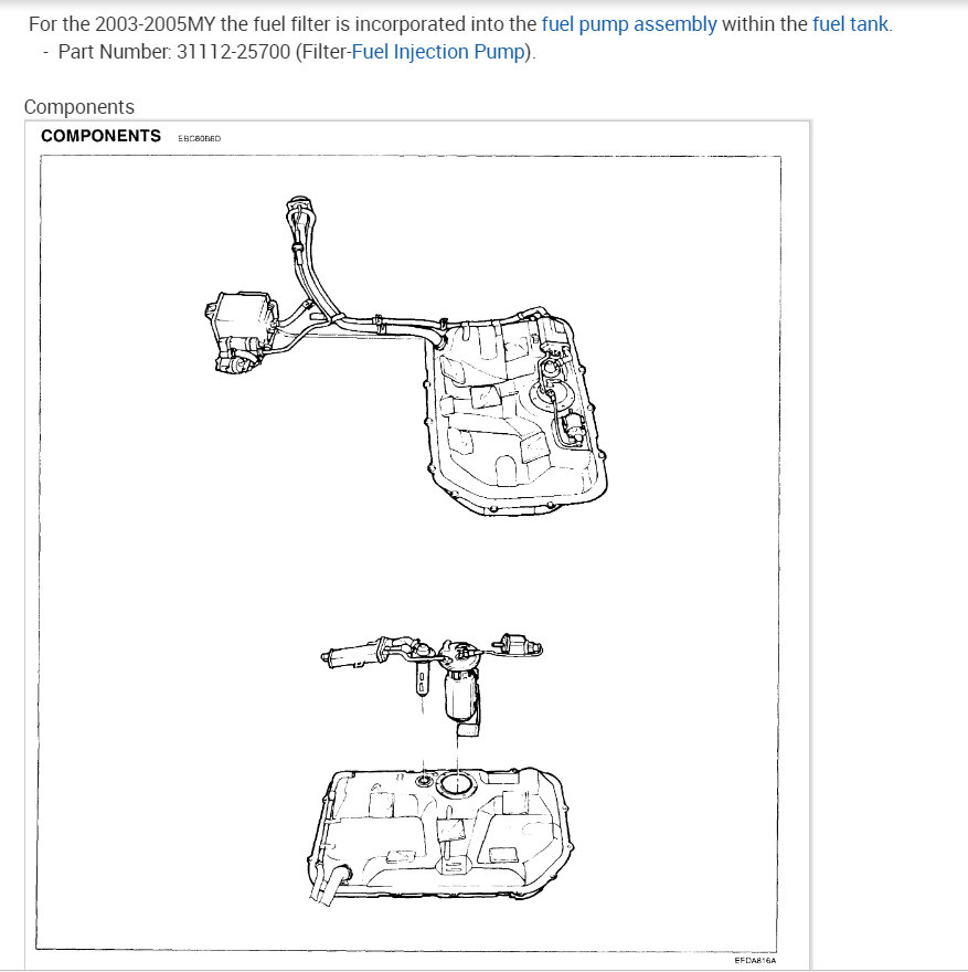

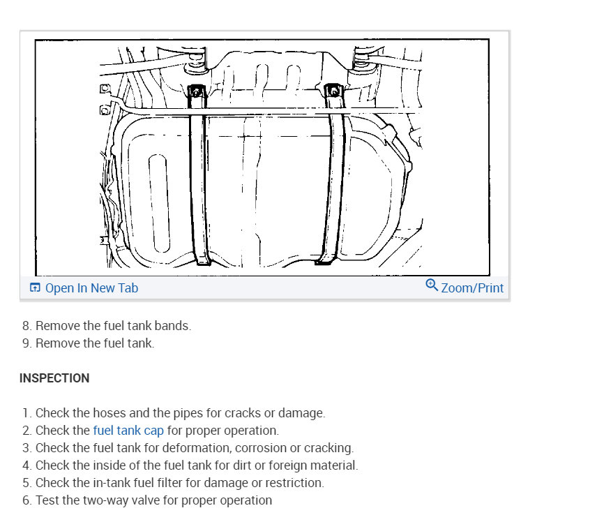

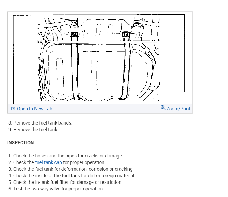

When you give it gas it tries to bog down, it runs okay for a few minutes then loses power again. it has been sitting for about a year.
Nov 27, 2022 at 11:41 PM
  • 55,464 POSTS

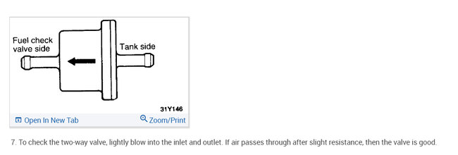

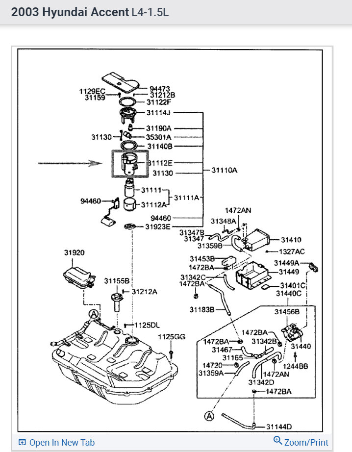

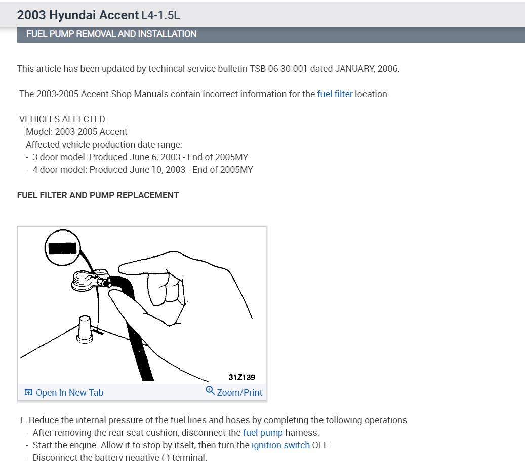

Yep, it sounds like a fuel pump is going out and you should drain the fuel and replace it with new. We can confirm the failure by doing a fuel pressure test. This guide can help, and you can rent a pressure gauge for cheap at the auto parts store.
General Specifications
Regulator pressure .................... 350 kPa (3.5 kg/sq.cm, 49.8 psi)

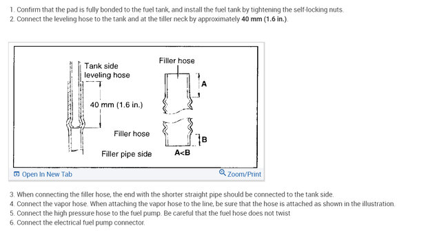

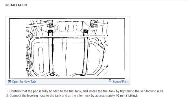

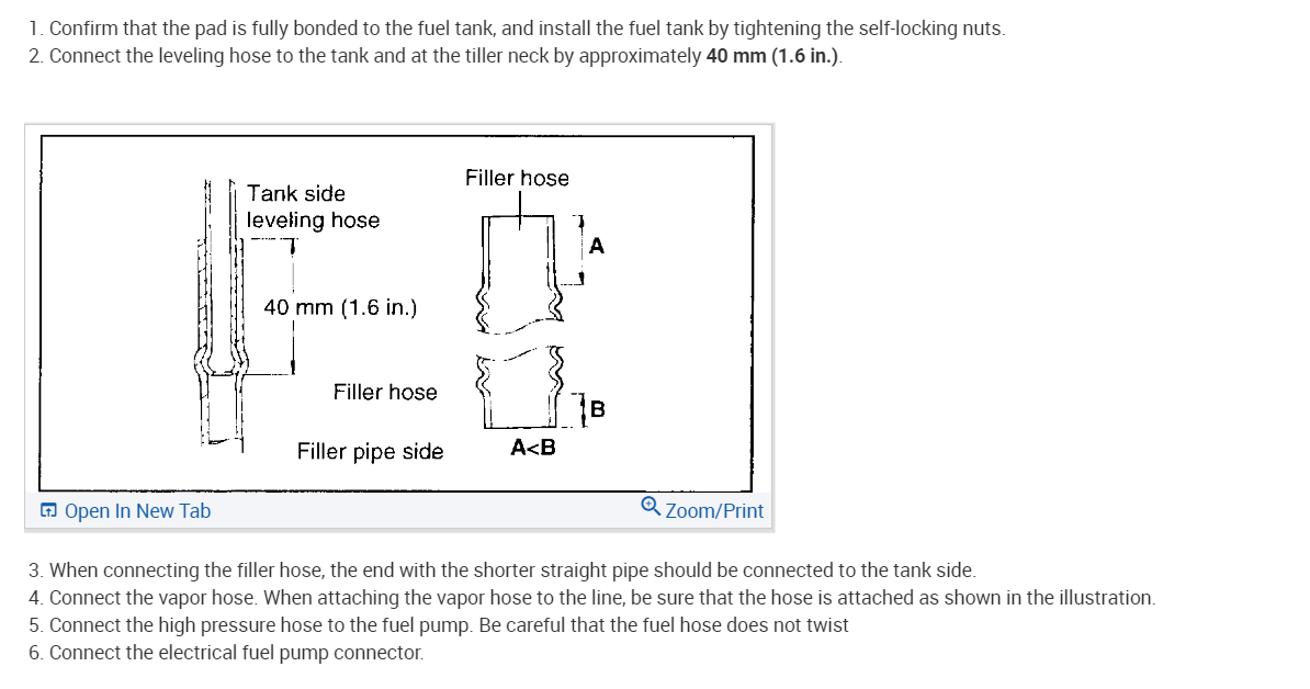

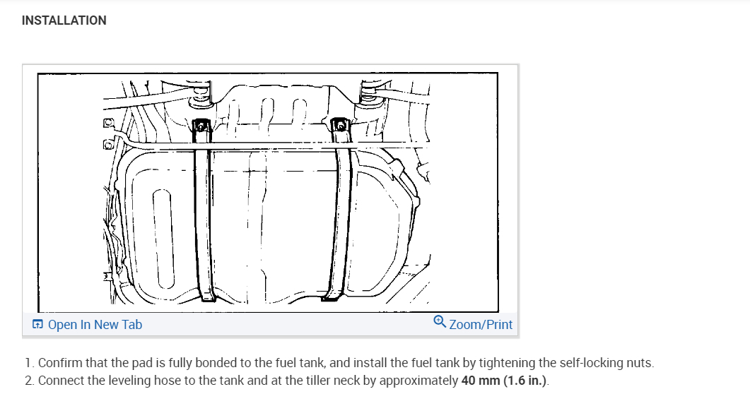

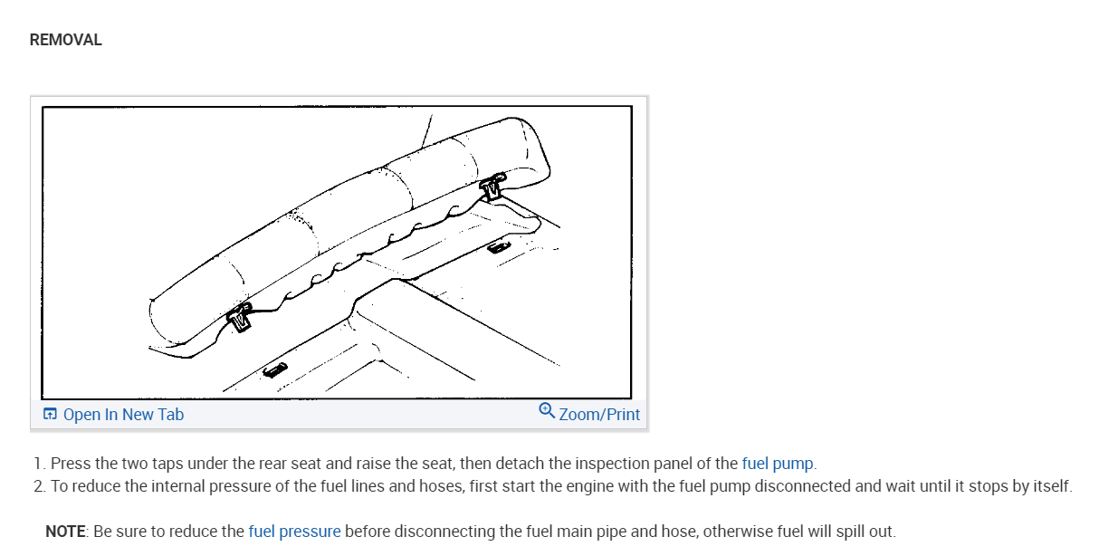

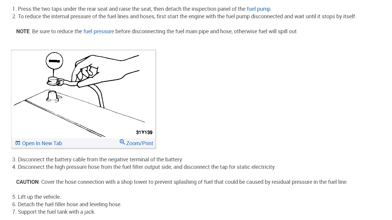

Here is how to change the pump out and drain the fuel as well:
https://youtu.be/Q5MH2gnyFH0
Please do not lower the fuel tank when it is full of gas, it is heavy, and you might lose control of it. Check out the images (below). Please let us know what happens.
