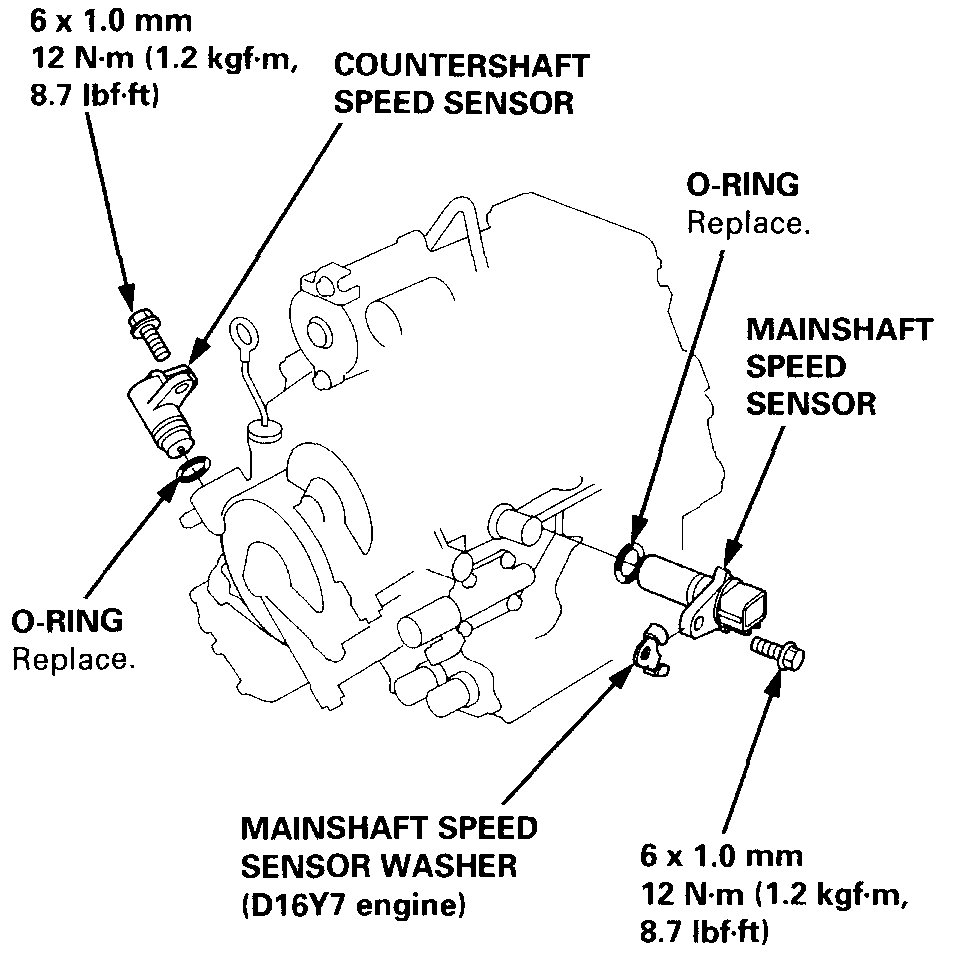

Got a code on my car P0715 that indicates that is the turbine speed sensor and I can’t locate it. please help me.

The code doesn't always mean there is a problem with the main shaft or counter shaft speed sensor. It could be a wiring problem, connection issue, or an internal transmission problem.
Picture 1 shows the location of both aforementioned sensors.
Before replacing one of them, confirm that there is no corrosion at the plug and the wiring seems to be in good condition. Also, make sure transmission fluid is clean and full.
