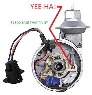

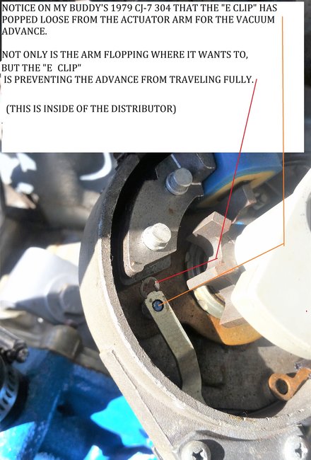

Ever tune it up recently? This may help, ask questions if need be! Got the timing dead on?
https://www.2carpros.com/questions/jeep-cj7-1985-jeep-cj7-stalls-when-hot
If the timing is having problems we will concentrate on getting it right.
Do you have a bunch of non-OE parts installed?
Can you remove the breather, lay the hood back on the windshield frame and take good, well lit pictures on the left side, right side, and overhead of the engine.
See if this may be a possibility?
See pictures below.
