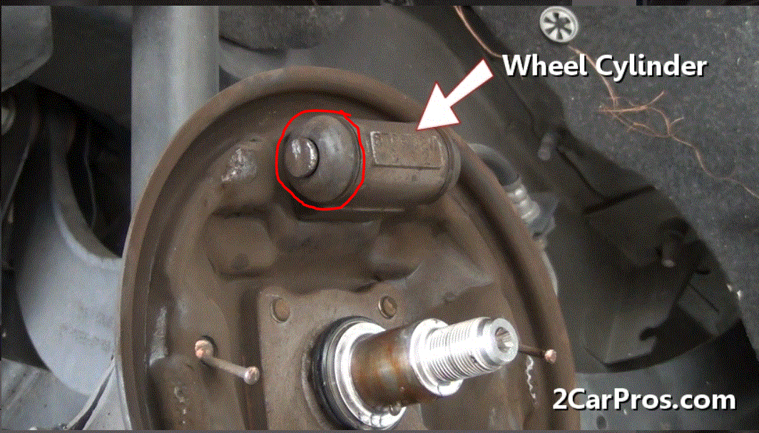

My vehicle listed above seems to lose brake fluid where I have to add some twice a month. I have checked all lines and put a new master cylinder on and bleed all the brakes. In fact I thought it might be a bad replacement master cylinder that I replaced it. same losing fluid. was wondering if power booster could cause this problem?

The booster won't cause it to lose fluid. Sometimes, a bad master cylinder will leak out the rear and into the booster, but that isn't the booster causing it.
I assume you checked wheel cylinders and brake calipers for leaks. If there are absolutely no leaks, the only thing that can be happening is the front brakes are wearing quickly and causing the caliper piston to be extended further. The extension requires more brake fluid to remain in the caliper.
Also, check around the reservoir for evidence of a slight leak. Also, remove the rear wheels and brake drums. Pop open the rubber boot on each side of the wheel cylinders to see if they are wet. See pic 1 below.

The rear seal at the back of the master cylinder can leak brake fluid into the power booster where it will be sucked into the engine and burned, but that isn't horribly common. You would have seen wetness there on the old one. To still have such a slow leak, the best suspect is a leaking rear wheel cylinder. When it's so slow, it's going to drip onto the drums, then be burned off or mix with normal brake dust to form a black sludge. You may never see wetness on the inside sidewall of the tire or even on the drum.
To verify this, you'd have to remove the drum, then peel both boots back on the wheel cylinder and look for excessive wetness around the pistons.
