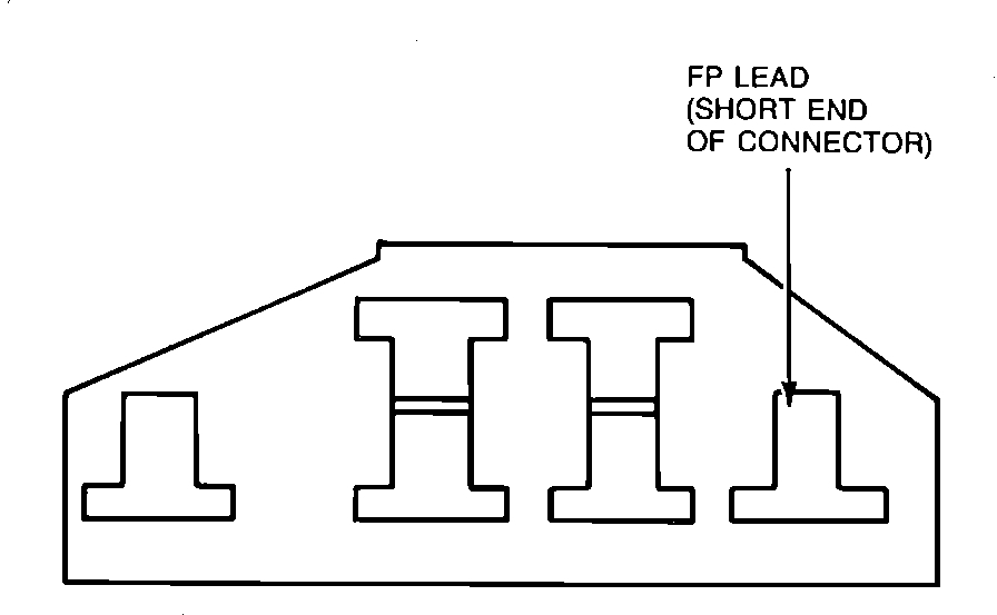

Hard loping start takes about ten tries then finally catches up and runs fine. It starts a little better when engine is warm.

If it takes several tries to get it to run, you may have an issue with fuel pressure drop off. Here is a link that explains how to check pressure, the regulator, and pressure drop off:
Here are the directions specific to your vehicle for testing pressure and performance:
STATIC PRESSURE TEST
1.Check for adequate fuel supply.
2.Turn key OFF
3.Install fuel pressure gauge to test port on fuel rail.
4.Install test lead to fuel pump lead of STO test connector.
5.Turn Key On Engine Off (KOEO).
6.Ground test lead to run fuel pump.
7.Check to determine if fuel pressure is within acceptable limits. Refer to SPECIFICATIONS.
