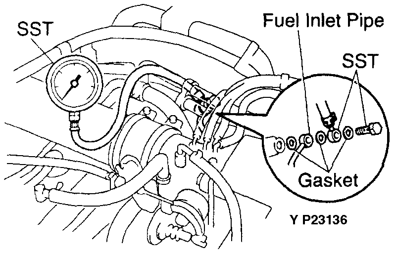

Here are the directions specific to testing fuel pressure on this vehicle. Note that there is no schrader valve to connect the gauge. You need to do it at the fuel line. See the attached pics.

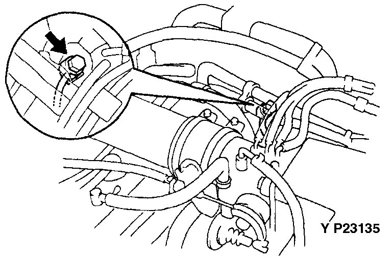

(c)Remove the union bolt and 2 gaskets, and disconnect the fuel inlet pipe from the delivery pipe.
HINT:
- Put a suitable container or shop rag under the delivery pipe.
- Slowly loosen the union bolt.

(d)Install the fuel inlet pipe and SST (pressure gauge) to the delivery pipe with the 3 gaskets and SST (union bolt).SST 09268-45012
Torque: 29 N.m (300 kgf.cm, 22 ft.lbf)
(e)Wipe off any splattered gasoline.

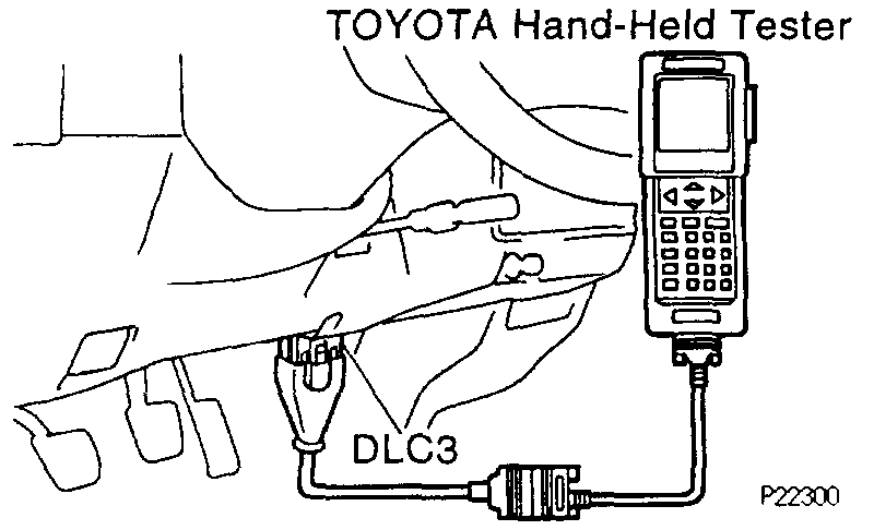

(f)Connect the Toyota hand-held tester to the DLC3.
(g)Turn the ignition switch on and Toyota hand-held tester main switch on.
Notice: Do not start the engine.
(h)Select the active test mode on the Toyota hand-held tester.
(i)Please refer to the Toyota hand - held tester operator 5 manual for further details.
(j)If you have no Toyota hand-held tester, connect the positive (+) and negative (-) leads from the battery to the fuel pump connector.

(m)Measure the fuel pressure.
Fuel pressure: 265-304 kPa (2.7-3.1 kgf/sq.cm, 38-44 psi)
If pressure is high, replace the fuel pressure regulator.
If pressure is low, check these parts:
- Fuel hoses and connections
- Fuel pump
- Fuel filter
- Fuel pressure regulator
- Injectors
(n)Remove the Toyota hand-held tester.
(o)Start the engine.
(p)Measure the fuel pressure at idle.
Fuel pressure: 206-255 kPa (2.1-2.6 kgf/sq.cm, 31-37 psi)
If pressure is not as specified, check the vacuum sensing hose and fuel pressure regulator.
(q)Stop the engine.
(r)Check that the fuel pressure remains as specified for 5 minutes after the engine has stopped.
Fuel pressure: 147 kPa (1.5 kgf/sq.cm, 21 psi) or more
If pressure is not as specified, check the fuel pump, pressure regulator and/or injector.
(s)After checking fuel pressure, disconnect the negative (-) terminal cable from the battery and carefully remove the SST to prevent gasoline from splashing. SST 09268-45012

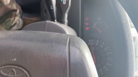

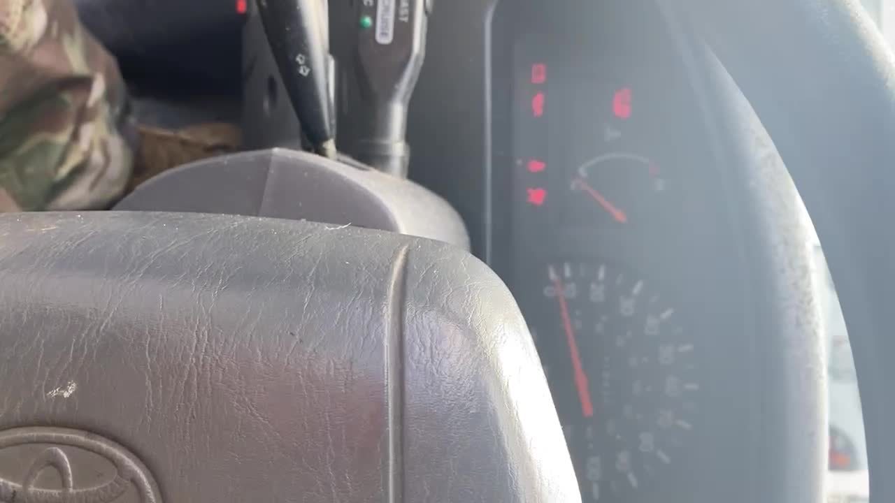

Here is a video of the start. It misses when no gas, then when I floor it the catch starts to happen.

Do me a favor. I want to see if it is a low fuel pressure issue. Do the following:
1) Turn the key from off to the on position (engine off) and count to five.
2) Turn the key off and then repeat step 1 three more times.
3) After you follow steps 1 and 2, see if it starts normally.
Let me know what happens.
Nov 12, 2020 at 11:41 AM
DOUGANDLAURA44
  • 16 POSTS
It did not help. And when it’s turning over when I push the gas pedal down it seems like the rpm slows down with the starter. Like I increase compression.

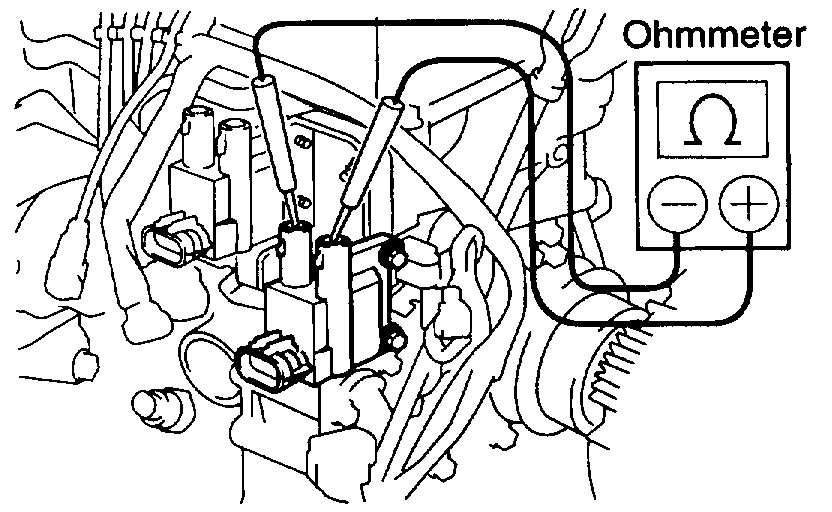

Yes, you can check the coils. Here are the directions. The attached pic correlates with the directions.
_________________
1997 Toyota Truck Tacoma Regular Cab 4WD L4-2693cc 2.7L DOHC MFI
Component Tests and General Diagnostics
Vehicle Powertrain Management Ignition System Ignition Coil Testing and Inspection Component Tests and General Diagnostics
Component tests and general diagnostics
Ignition coil inspection
1. Disconnect high-tension cords from ignition coils
2. Disconnect ignition coil connectors
pic 1
3. Inspect secondary coil resistance
using an ohmmeter. Measure the resistance between the positive (+) and high-tension terminals.
cold: 9.7 - 16.7 k ohms
hot: 12.4 - 19.6 k ohms
if the resistance is not as specified, replace the ignition coil.
4. Reconnect ignition coil connectors
5. Reconnect high-tension cords from ignition coils

12.18 on one and 12.47 on the other.
Dec 2, 2020 at 7:05 AM
  • 110,251 POSTS
Is that the resistance with it cold? If so, the coil is out of spec. If it is when it's hot, it seems good. Did you check it both cold and hot?
Dec 2, 2020 at 10:08 AM
DOUGANDLAURA44
  • 16 POSTS
No, I just checked cold. But your message earlier said between 9.7 - 16.7 cold. I thought 12 would have been good cold?
Dec 2, 2020 at 11:39 AM
  • 110,251 POSTS
Yes, you are correct. That is within spec. I was asking because if it was hot, then it wouldn't have been.

So I pulled the coils out completely and tested the secondary’s which came out in the 12’s.
When I tested the primary’s where the connectors plug in. I put the multimeter to the constant and then checked the other three prongs. I was getting 56.4 k ohms. I was reading that it should have only been somewhere around 6.
