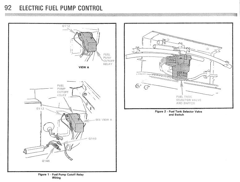

I have heard of those trucks having a problem with the switching valve if you have more than one tank, I think it sucks air into the injection system. The valve is located under the bed on the drivers side I believe.

It does have dual tanks. That could explain it sounding like it is starving for fuel, know a way of testing it? I do not want to have to keep throwing parts at it if I do not have to.

It was very difficult to test, I just remember it from back in the day when my buddy at Ford told me about it.

I have this and will send pictures on how to do this. Read both pages first though.
