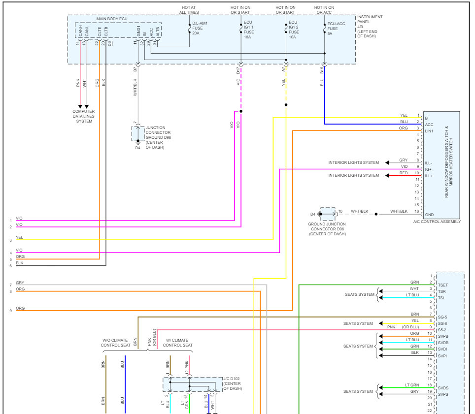

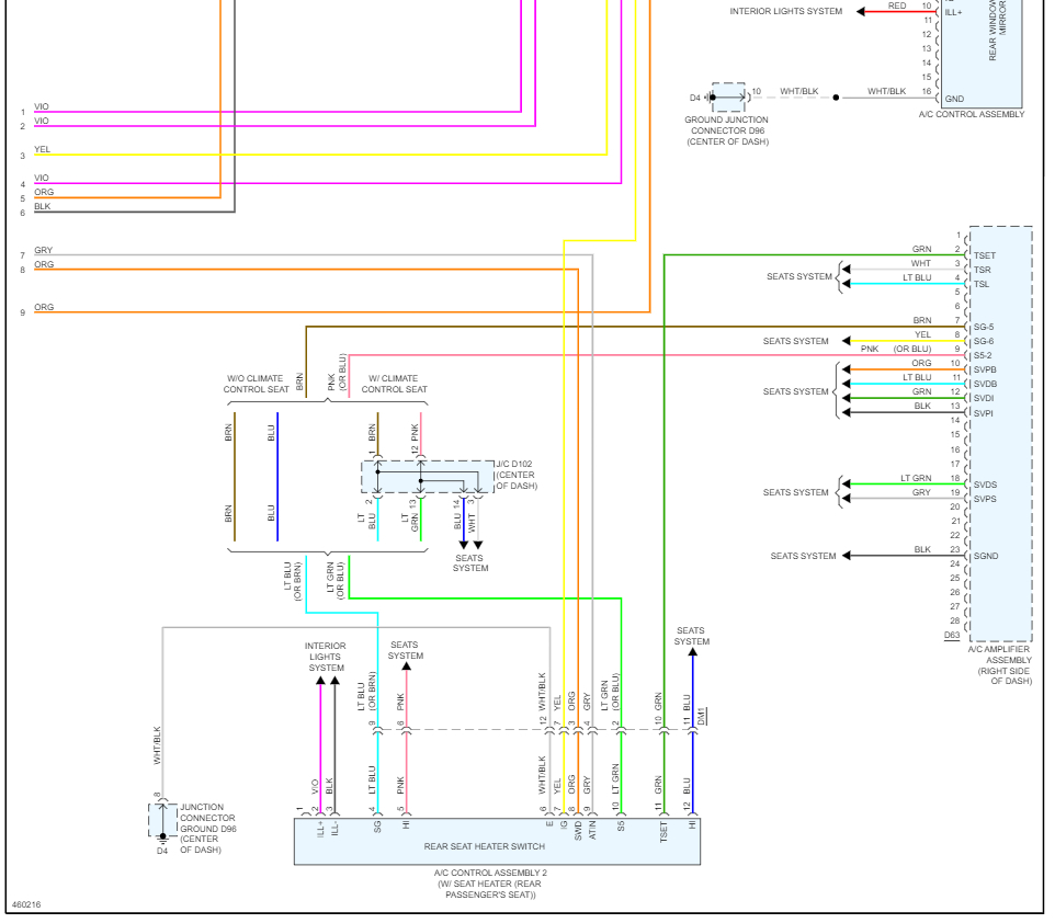

A/C pump isn't seized. fuse 13 and 27 good. can't find relay switch? If not relay what else should i check and how?
Apr 23, 2023 at 1:48 AM
  • 55,423 POSTS
Is the system full of refrigerant? This would be the first thing I would check because the system will not turn on when the system is low.
Here is a guide to help see if that is the problem:
https://www.2carpros.com/articles/air-conditioner-how-to-add-freon
This guide may help as well:

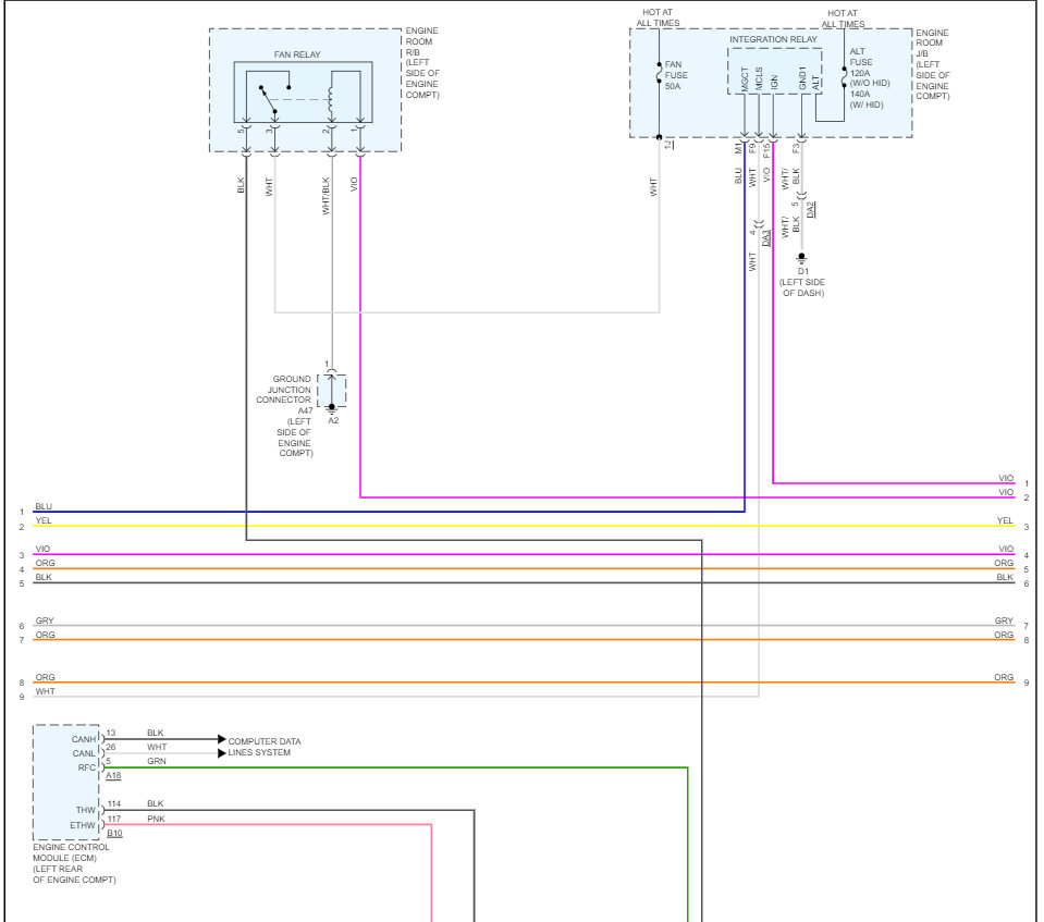

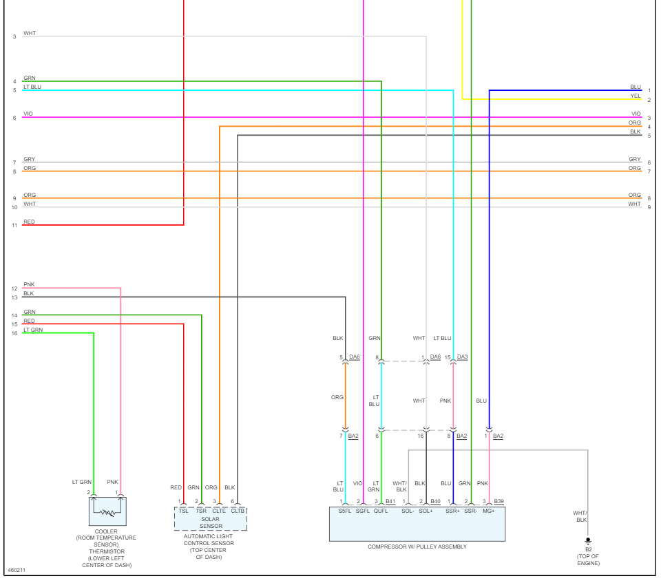

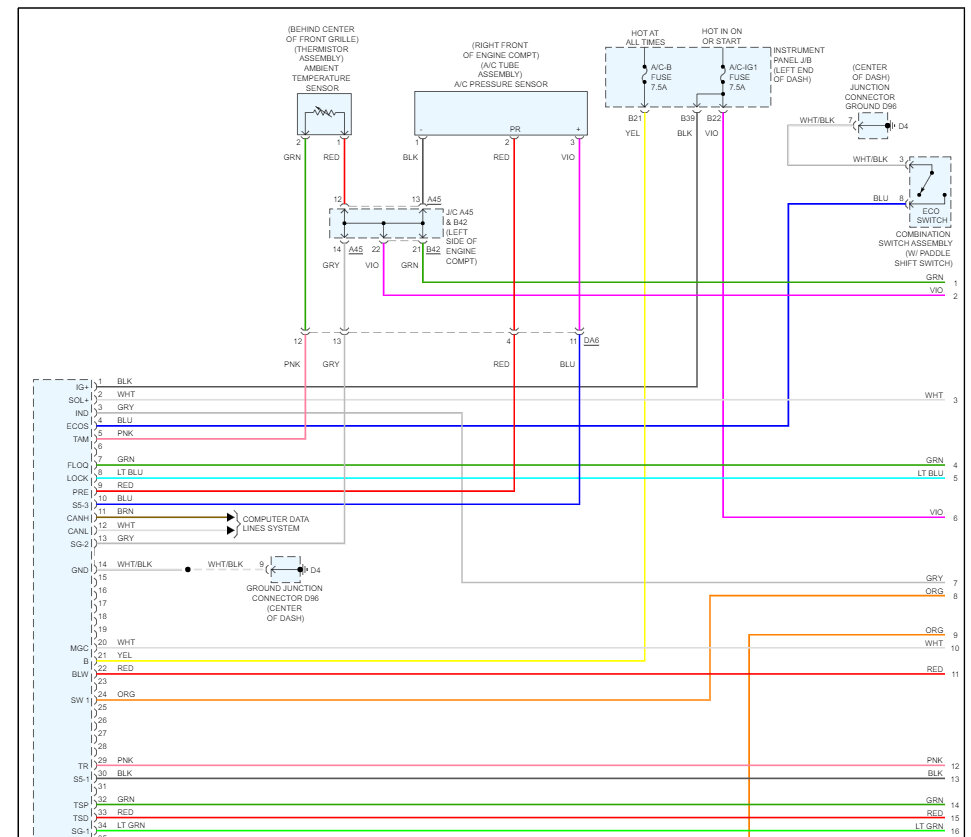

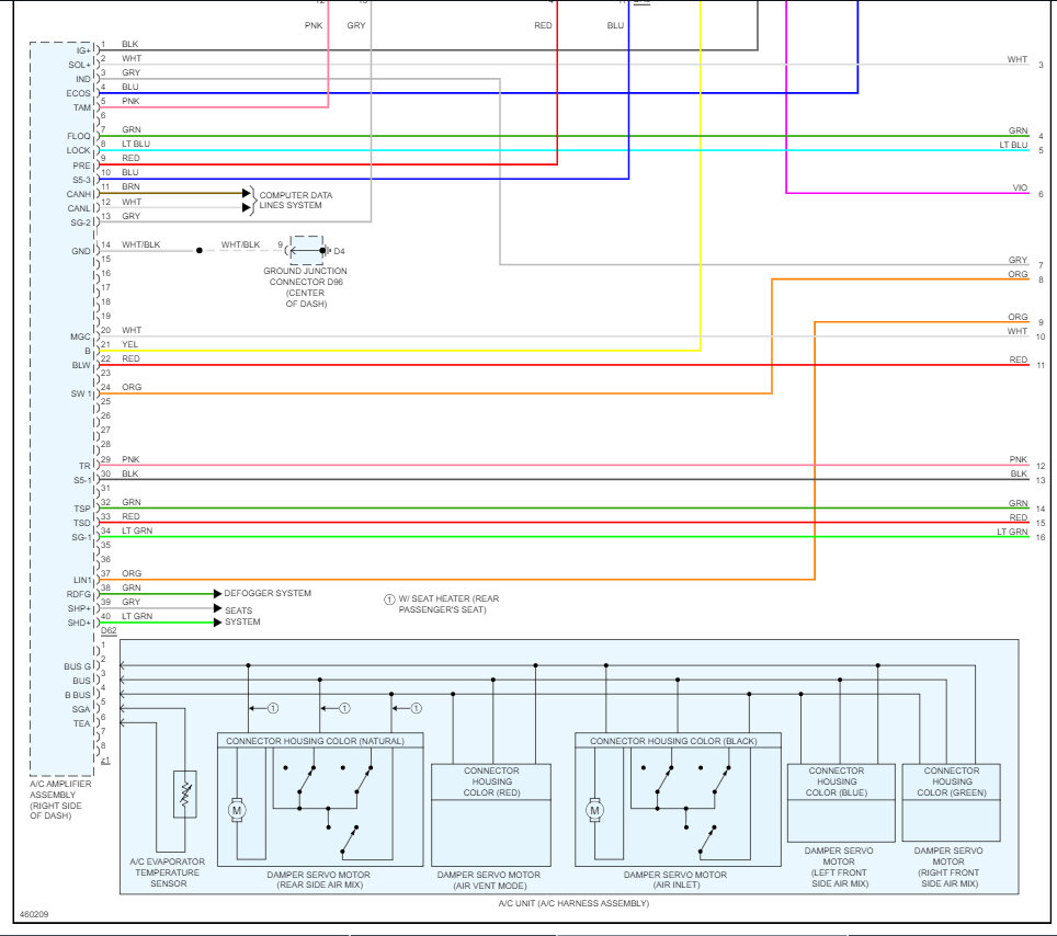

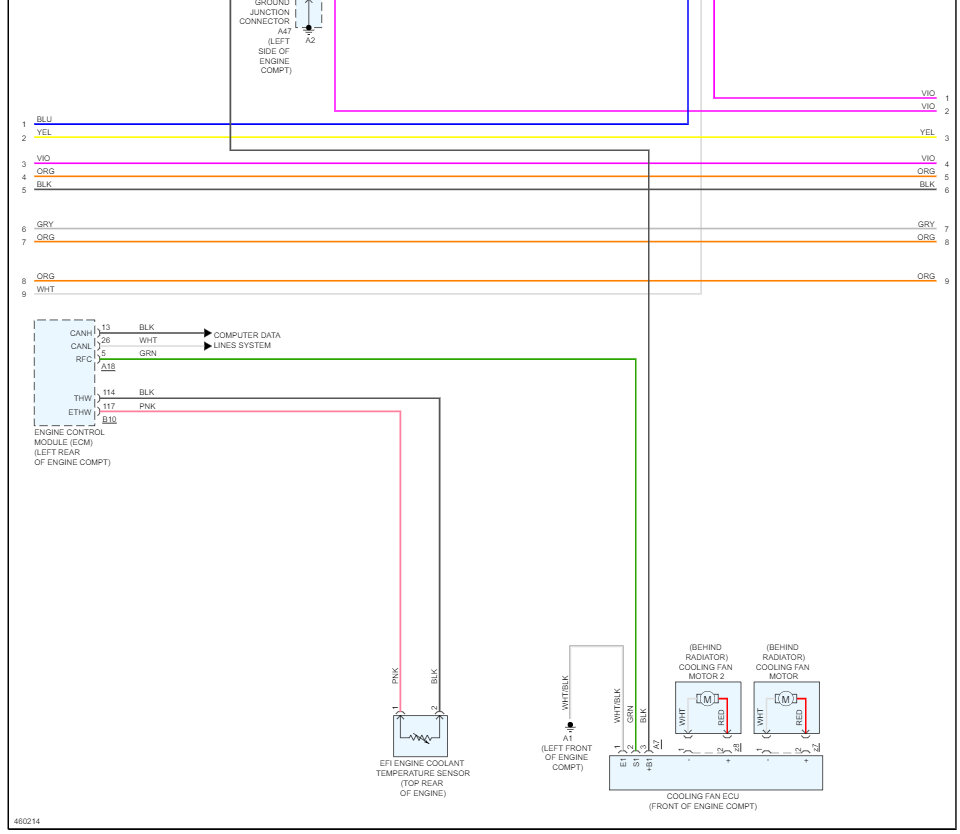

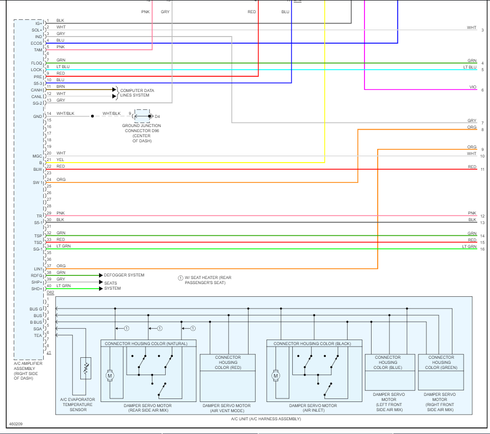

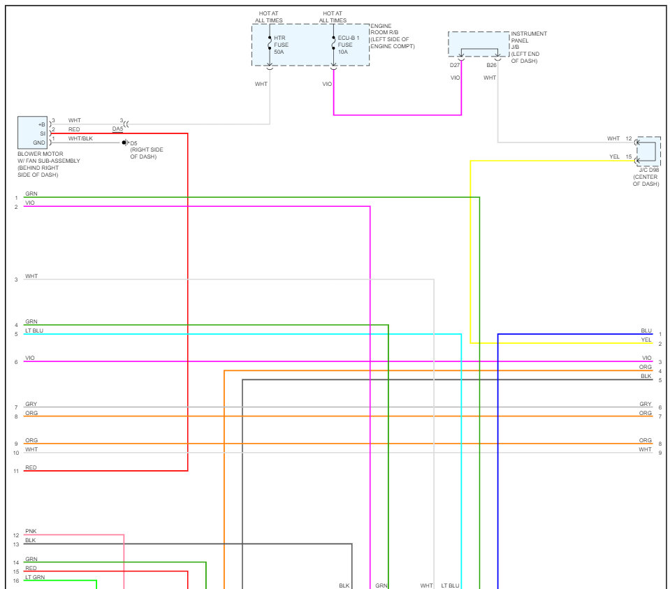

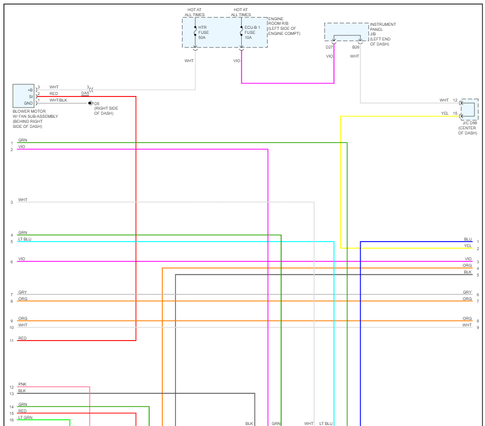

Here are the air conditioner wiring diagrams so you can see how the system works and which fuses to check. If the system is empty here is a guide to help you find the leak:
https://www.2carpros.com/articles/air-conditioner-leak-detection
Check out the images (below). Please let us know what you find. We are interested to see what it is.

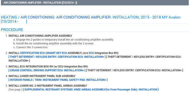

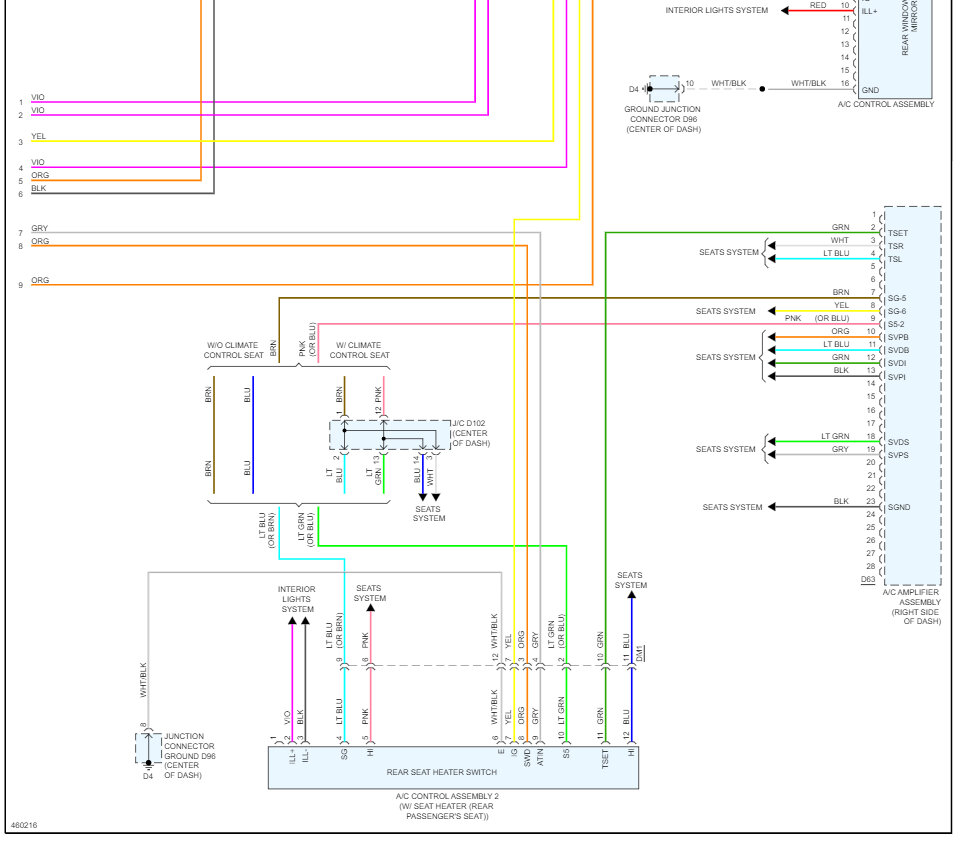

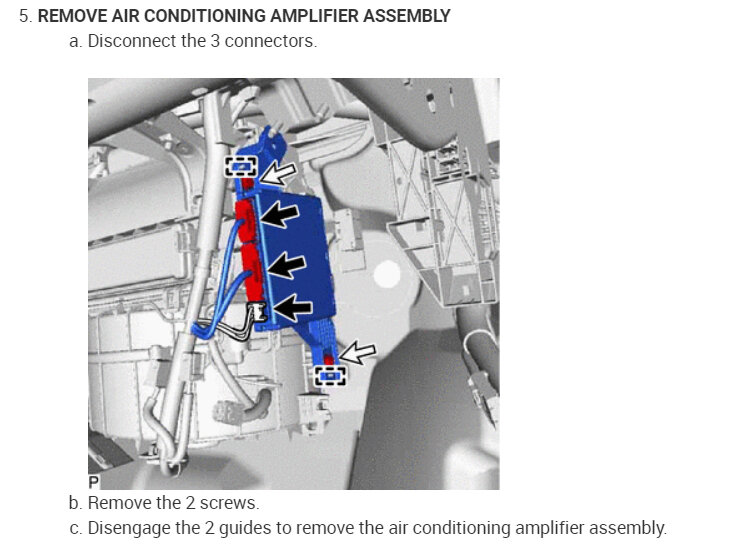

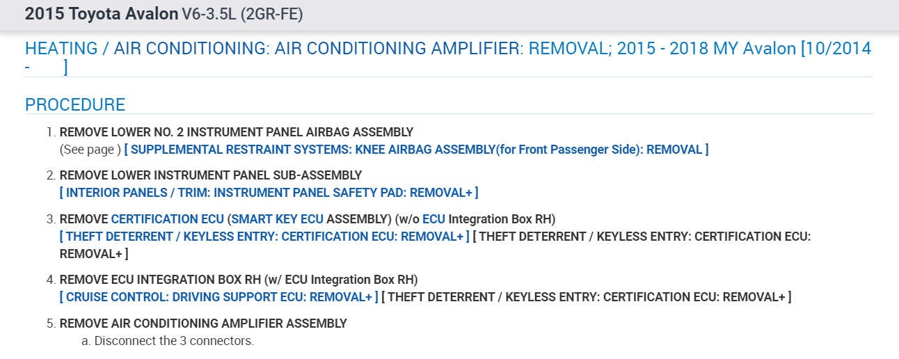

That might be normal if the system is not turning on. At least it has a charge. There are more fuses that run the system than 2, please use the wiring diagrams above to see all of the fuses and then check them, if the fuses are okay, we need to do a CAN scan because it sounds like an A/C amplifier has gone bad. the CAN scan should be able to confirm the problem. You can get a CAN scanner (Controller Area Network) which will work on most cars from Amazon.

Here is the location of the A/C amplifier in case you need it. Check out the images (below). Please let us know what happens.
Apr 25, 2023 at 1:38 AM
