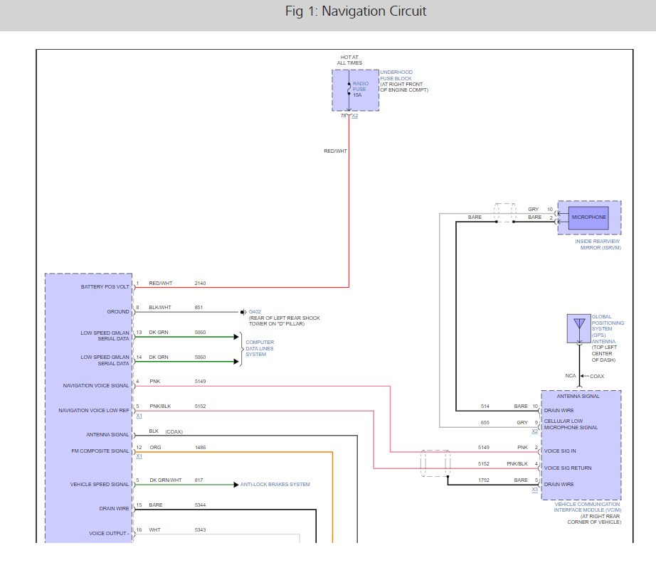

Where is the VSS wire located?
102,000 MILES • 4.6L • V8 • 2WD • AUTOMATIC
JPRIETZ
  • 11 POSTS

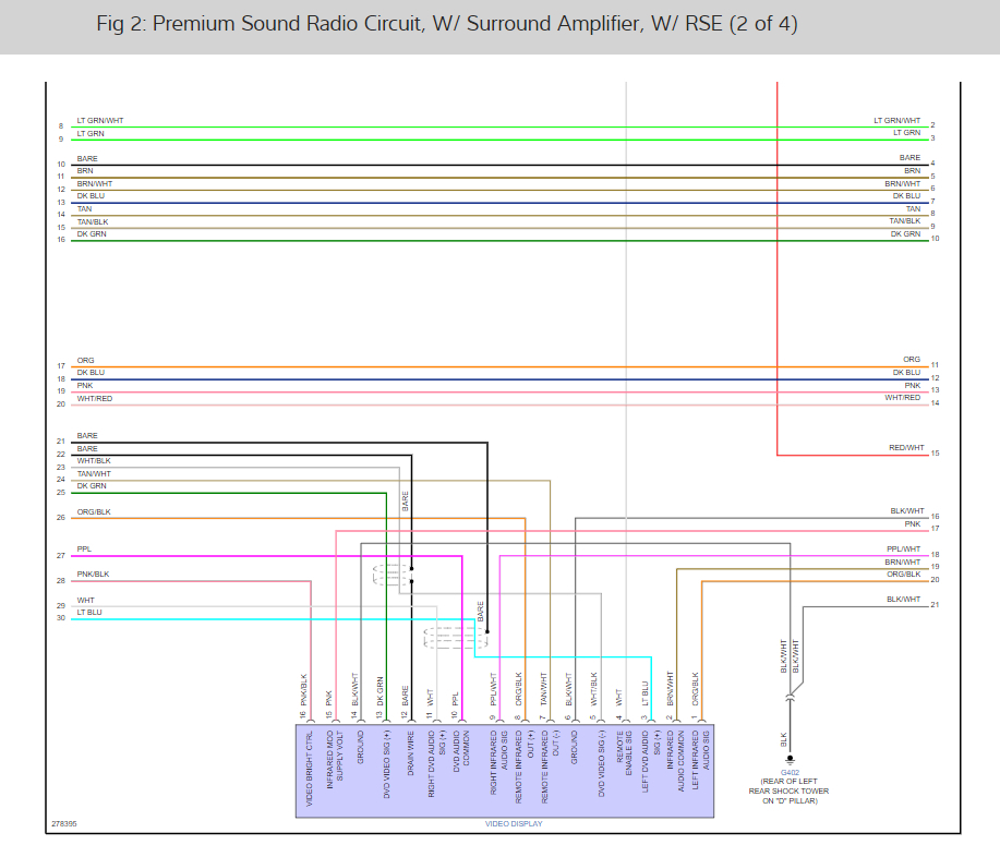

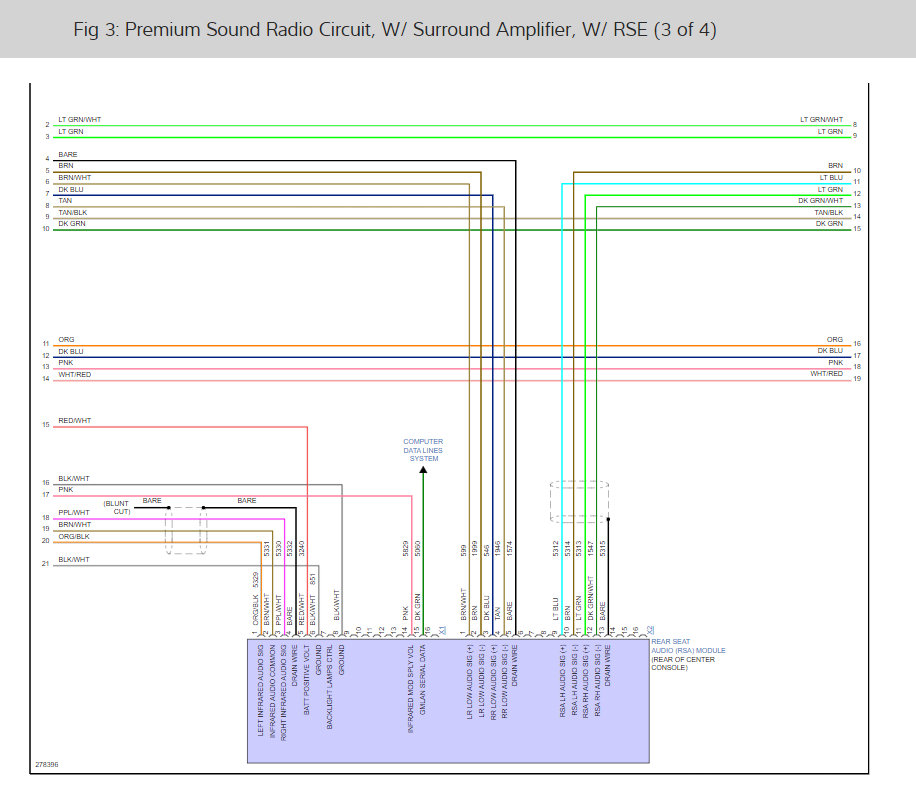

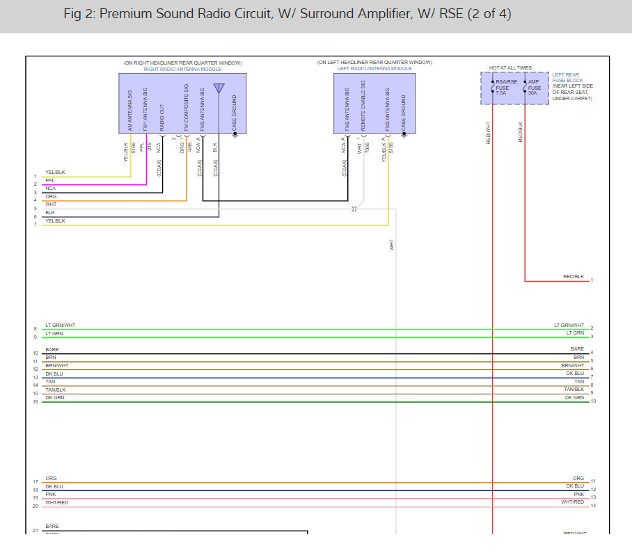

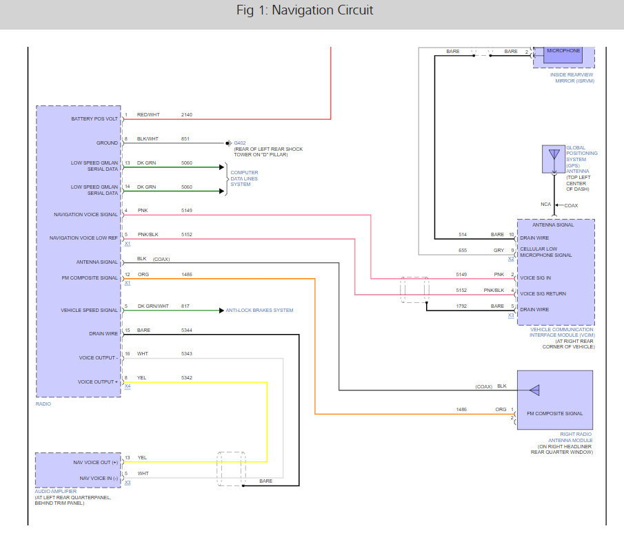

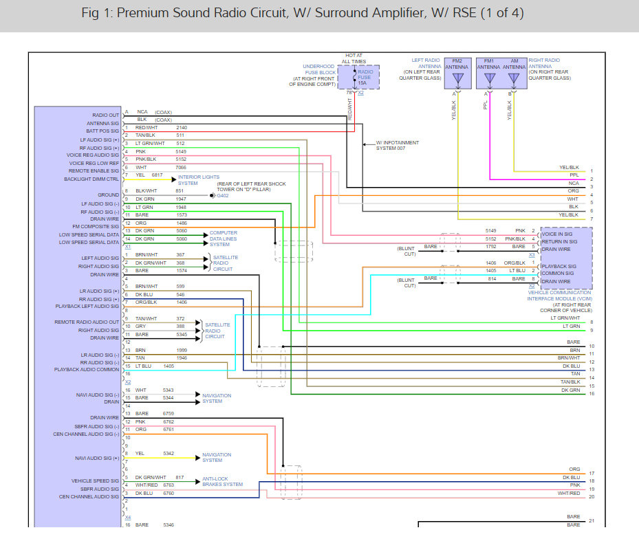

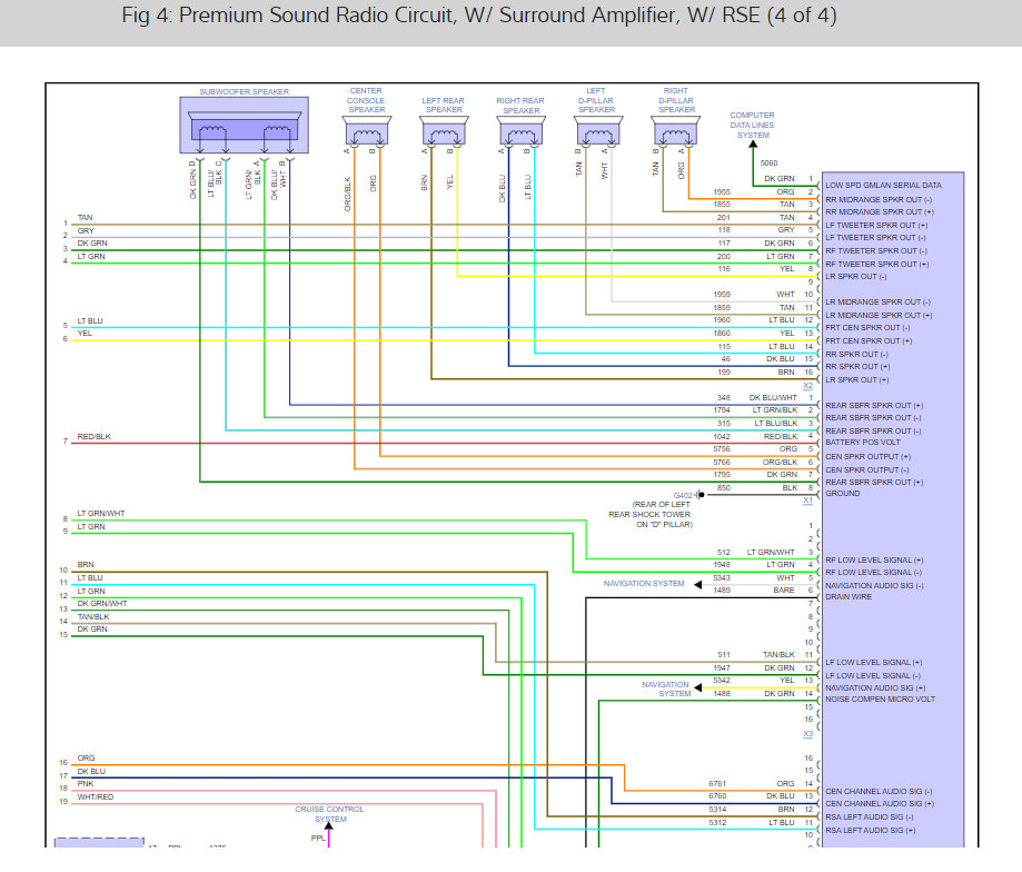

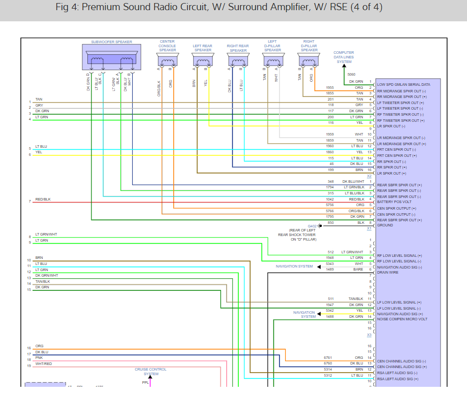

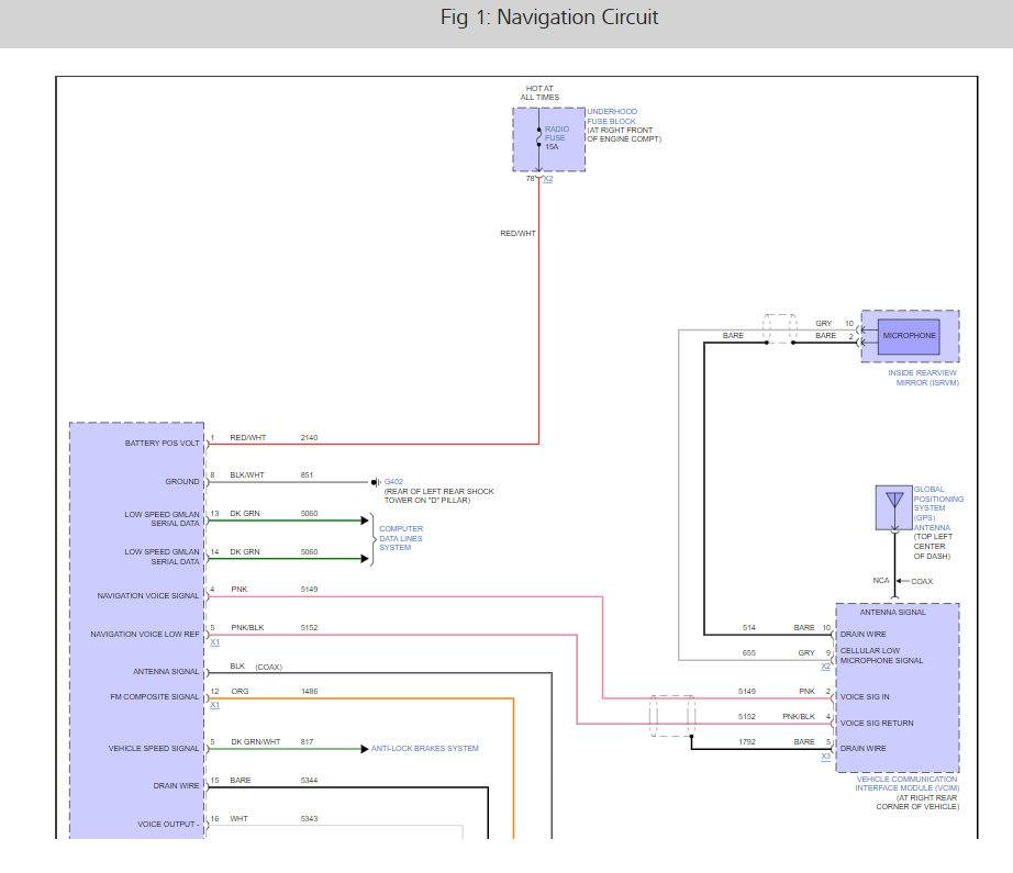

The car has the OEM AM/FM/CD/XM radio and will get installation the OEM sat nav radio, much of it will swap over. but need the VSS signal to work correctly. I'm trying to find a location to get the VSS wire. Any help is appreciated.
Jeff
Jun 26, 2022 at 11:26 AM
  • 55,588 POSTS

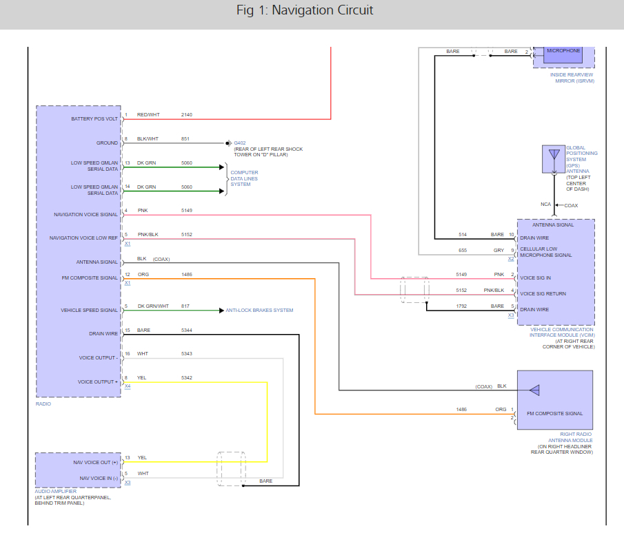

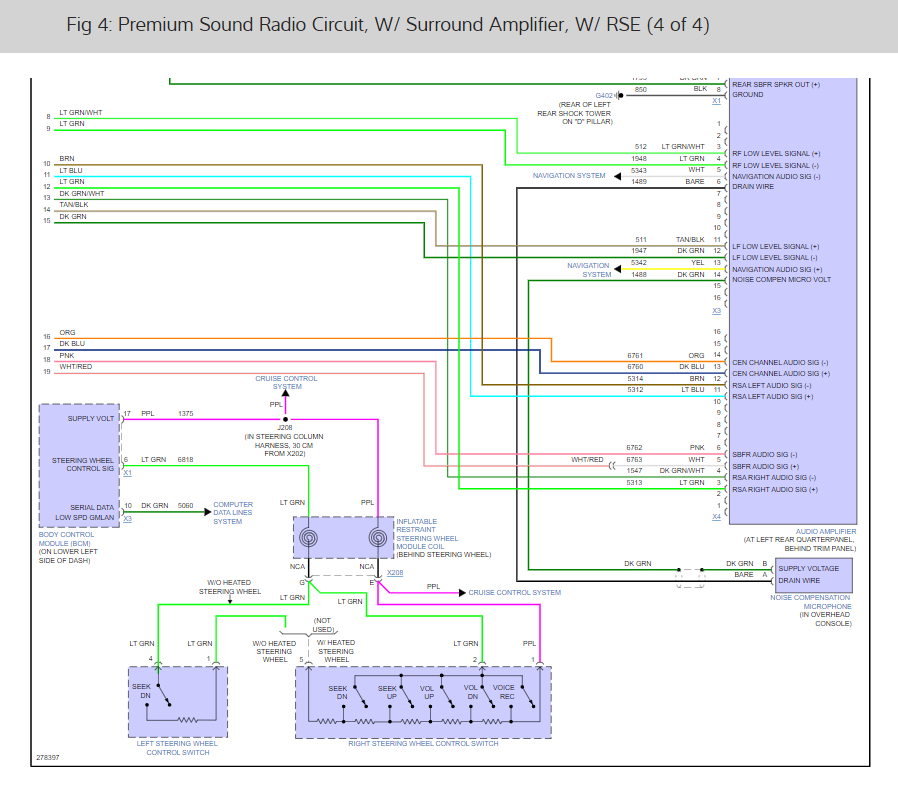

The VSS signal wiring from the ABS system (dark green and white wire) I would think this information is available in the CAN system which is where the NAV system would pick it up. It should be present in the radio/Navi wiring harnesses. Here are the wiring diagrams for the NAV and radio I have found to help you with the job. Check out the diagrams (below). Let us know what happens and please upload pictures or videos of the problem.
