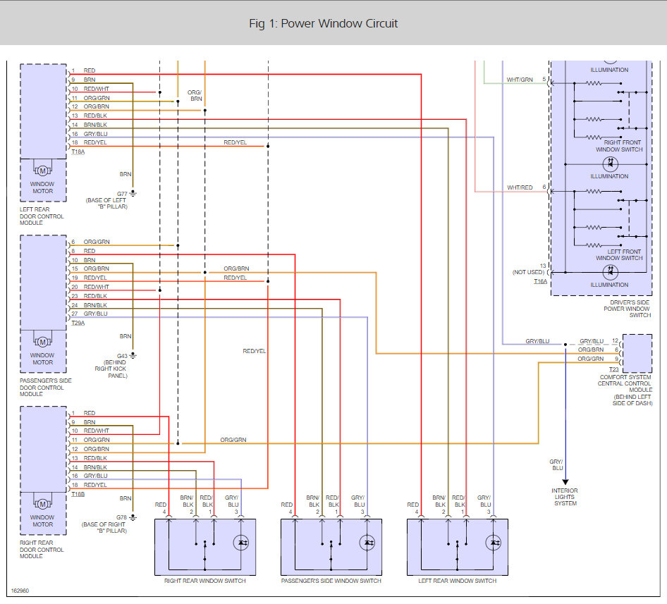

Hi, All windows and central locking system stopped working. i checked all fuses and they were okay, but i read some forums i heard some talking about a power window relay or power door relays which could be the culprit. i checked under the driver side and saw some relays, but cannot tell which is either power window or power door relay. can someone please tell me the location of this relay(s) and the number written on it?any help is appreciated. Thanks

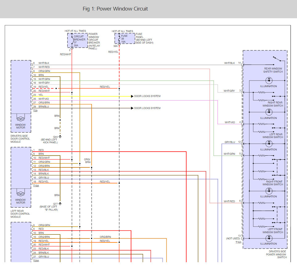

This sounds like the main (drivers) window switch is bad becasue these is no relay, here is a guide and a wiring diagram to help you confirm the problem and get it fixed.
https://www.2carpros.com/articles/electric-window-repair
and
Check to see if the switch is getting power, if so try replacing the switch

Lets get back to basics before we go any further, here is a guide that will show you how to check for power at and through the switch

Hello, Mr. Ken. Before i proceed i would like to express my sincere appreciation to you and your efforts. you drew my attention to checking power through the switch the last time. indeed there was power and the brown wire was the ground. but when the car got frozen,(i mean the glasses and the central lock) i tested and now there was power in another wire again ( a small brown wire with a blue strip,it passes through all the doors to the ccm) so I'm sure there is some kind of bad ground somewhere. but to solve my problem temporarily, i decided to disconnect only one wire(that small brown wire gaining power) from the switch in the back door and voila!,it worked, the problem went away. i wanted to inform you earlier but i wanted to be sure before. So what do i do next? and remember, Thanks in advance
Nov 3, 2017 at 2:04 AM
  • 55,432 POSTS
I think you found the problem if you look at the wiring harness the brown wire is ground and the reason it has power is becasue it was looking for ground. Check out the wiring diagrams about to see what I am talking about.
