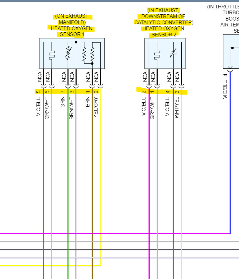

Hello, may I have diagram showing the location of the O2 sensors on the car listed above?
Apr 17, 2023 at 11:36 AM
AL514
  • 5,587 POSTS

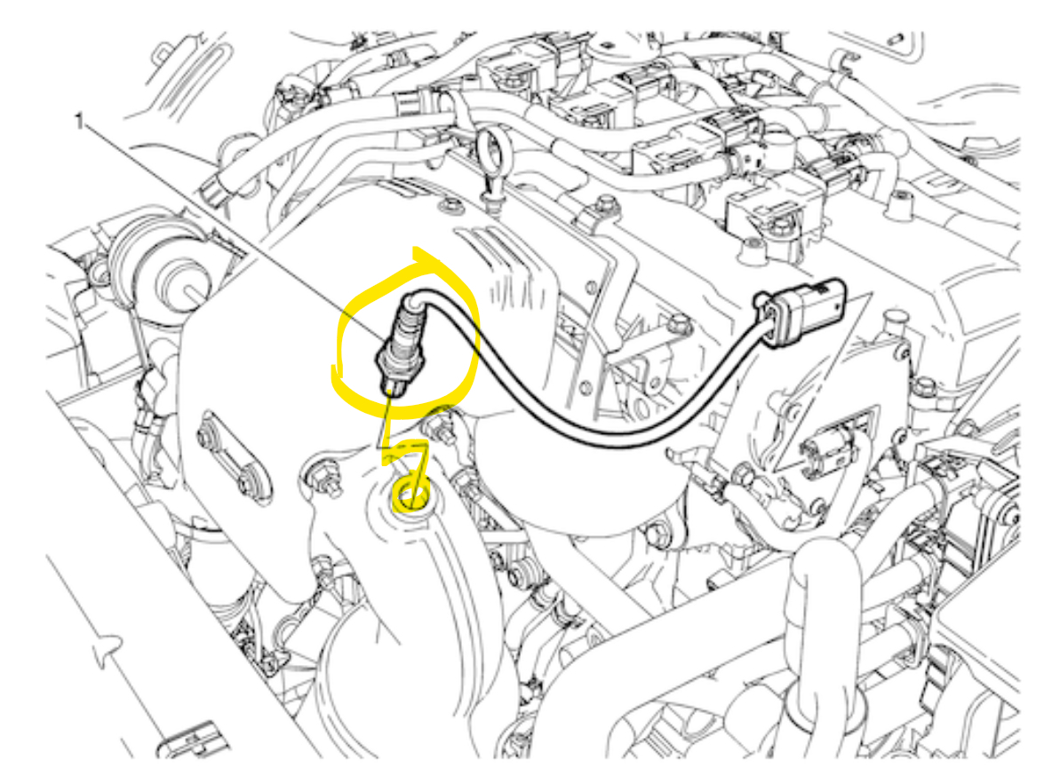

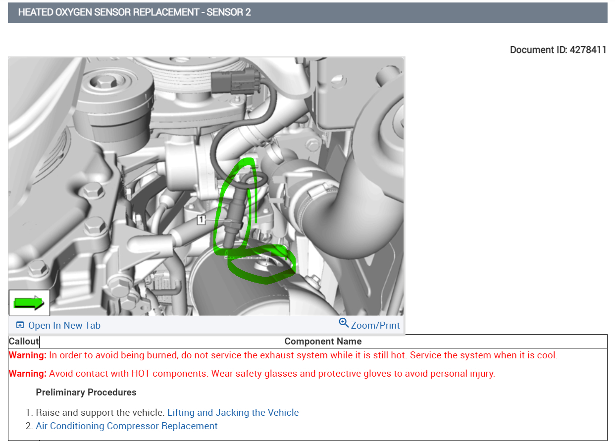

Hello, are you getting certain codes for either oxygen sensor? There are 2 in this vehicle. I will post diagrams for both. But the front oxygen sensor is a pretty advanced sensor, it has a built-in temperature sensor along with a heater circuit which all oxygen sensors have. So, if you are getting a check engine light and certain code, it would be good to look up the code setting criteria for them. And is this a 2.0-liter engine?

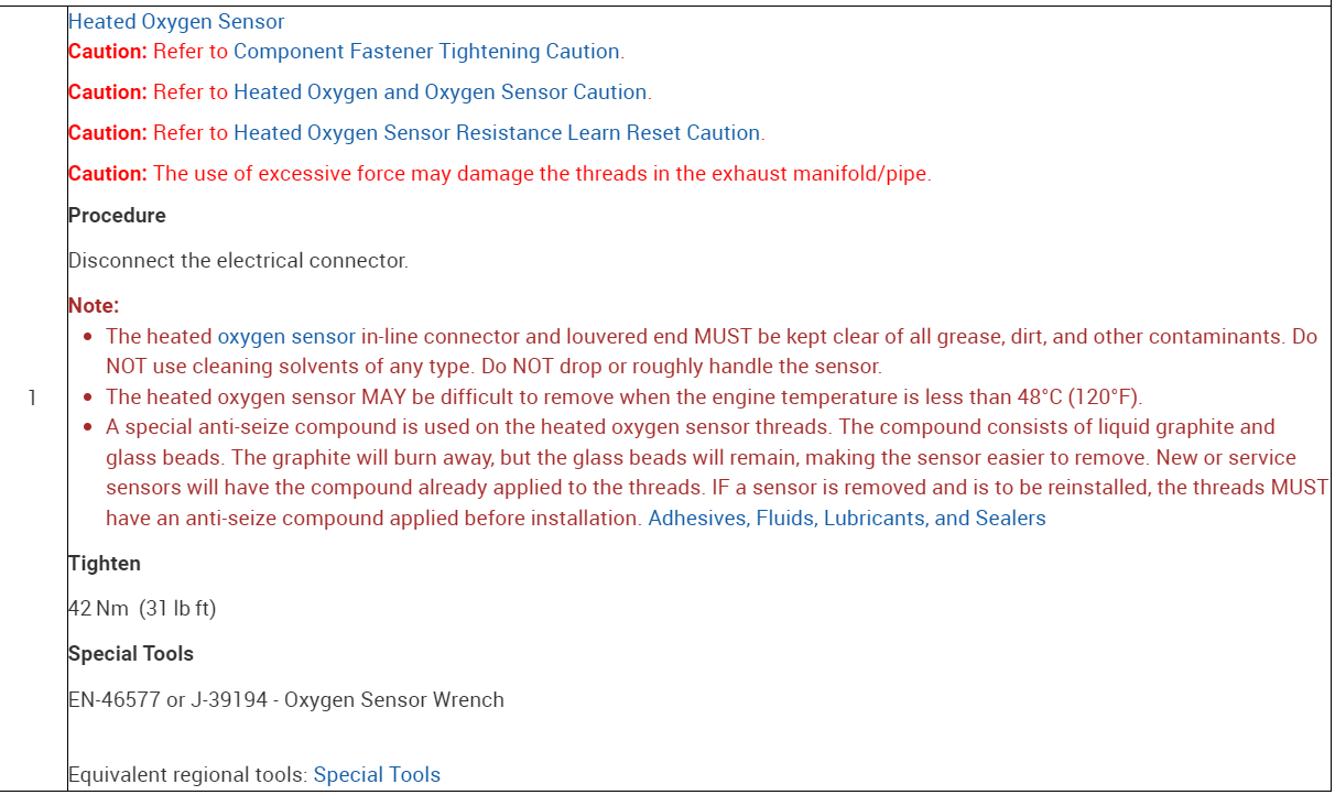

The rear Oxygen sensor needs a specific socket to remove the sensor. The part number is on the 4th diagram.

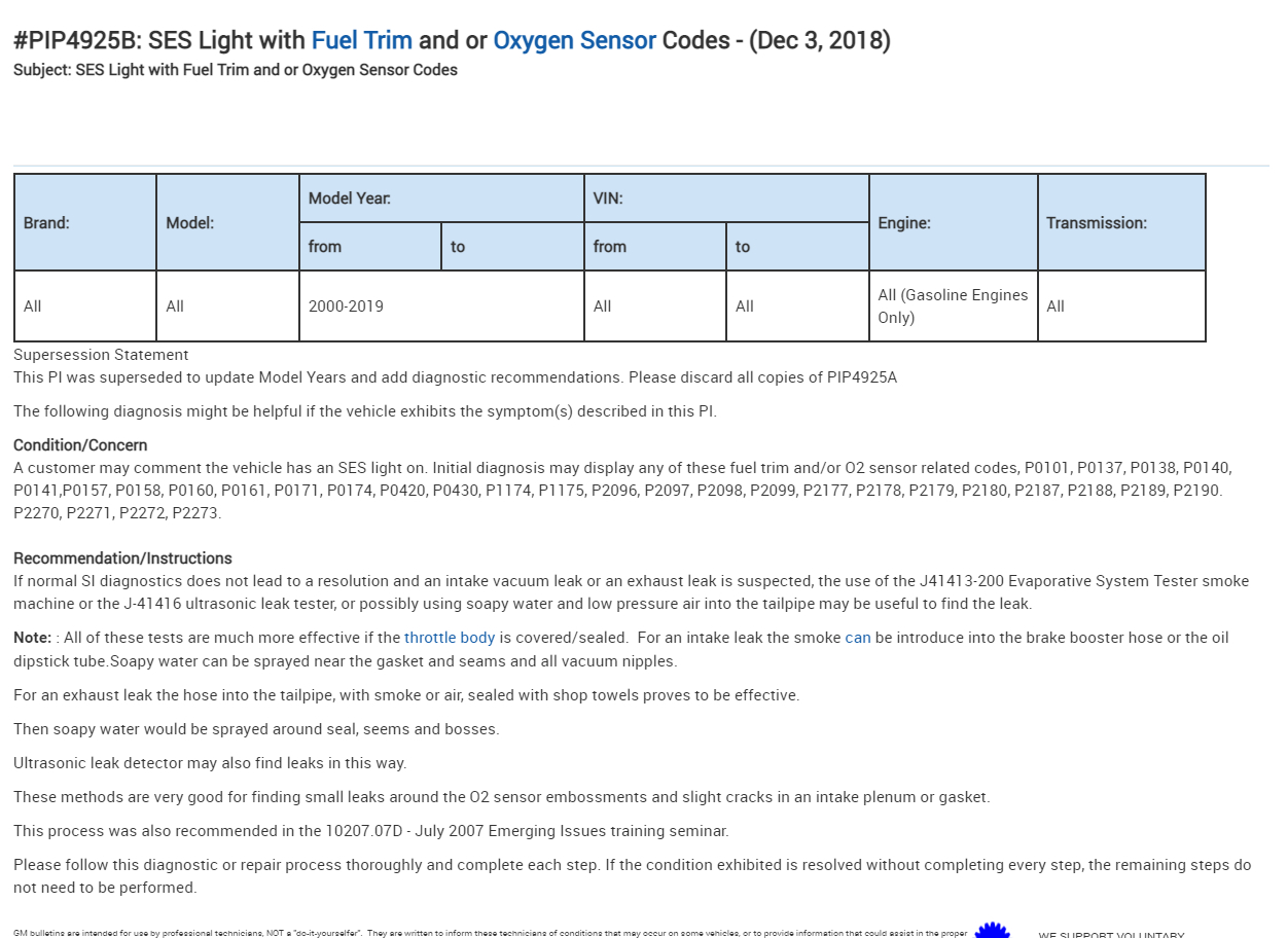

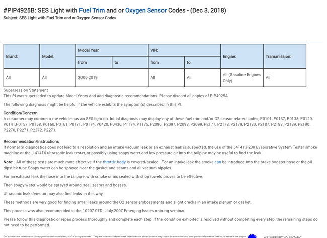

There is also a Technical Service Bulletin about other causes of Oxygen sensor codes (5th diagram).
