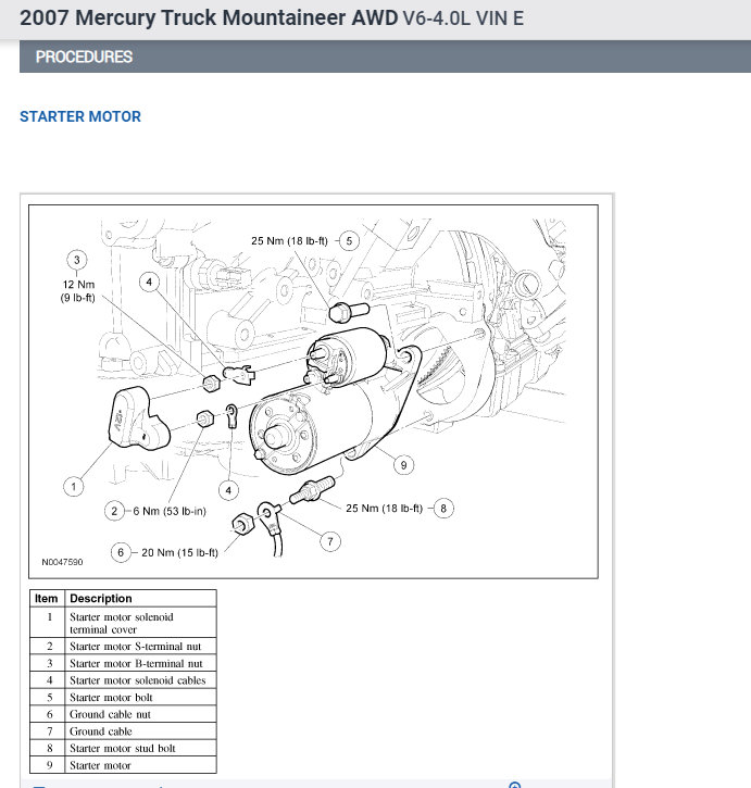

Where is the starter located?
2007 MERCURY MOUNTAINEER
197,000 MILES • V6 • 4WD • AUTOMATIC
LINDA ROGERS
How do I get to the starter located?
Aug 7, 2022 at 7:13 AM
SQM
  • 6,383 POSTS

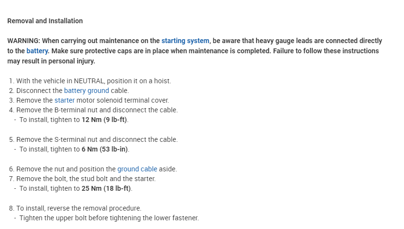

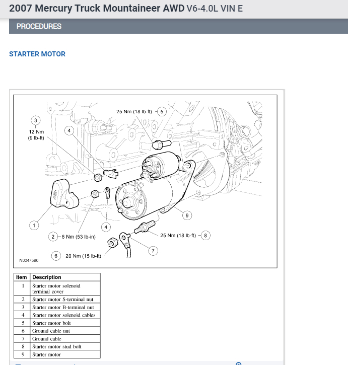

The starter is located on the lower left side of the engine.
Before getting the starter, you want to make sure to disconnect the battery.
The starter is mounted with 2 bolts.
Before removing the bolds you want to first remove the wire.
Here is a helpful guide:
I have attached the replacement procedure below for your reference.
Let me know of any questions.
