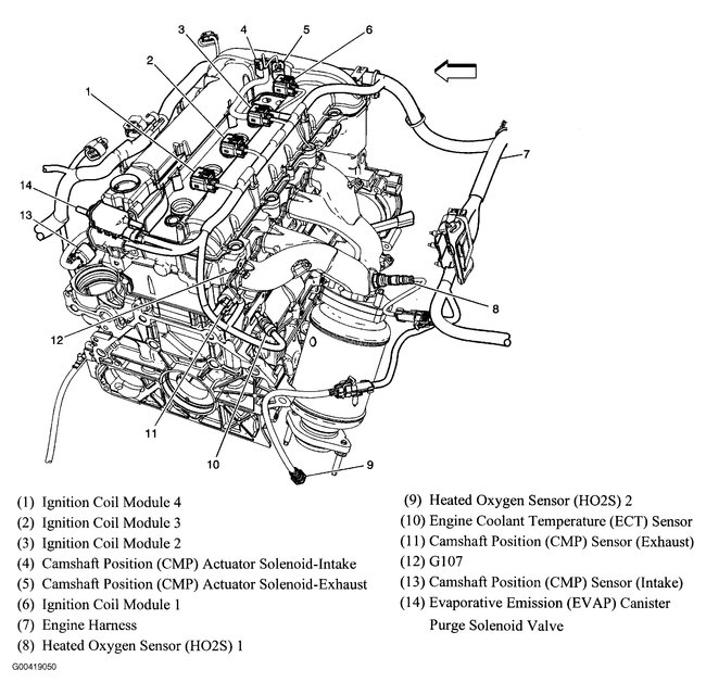

Location of camshaft position sensor
75,000 MILES • 2.0L • 4 CYL • TURBO • MANUAL
MICHELLE GOODWIN
camshaft position sensor code poo17. is this a sensor issue only and if so which one? where is location?
Feb 26, 2017 at 10:29 AM
CARADIODOC
  • 34,413 POSTS
That fault code refers to "crankshaft position sensor and exhaust camshaft position sensor correlation", meaning the sensors' signals are not showing up at the right time. That is detected through properly-working sensors.
