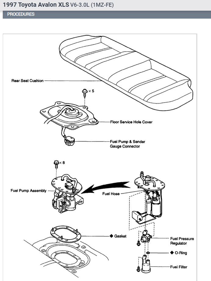

The car cranks and starts, running for about 2 seconds before choking off. I have replaced the fuel pump; but the car continues to do the same thing. I know it's a fuel delivery issue because the car runs a little longer with starter fluid. My research tells me to check the fuel pump relay which is called Circuit Opening relay. I get conflicting info about where it is located exactly. My car is made to California emissions standards if that makes a difference. Is the relay immediately visible or do you have to dig past a bunch of wires?

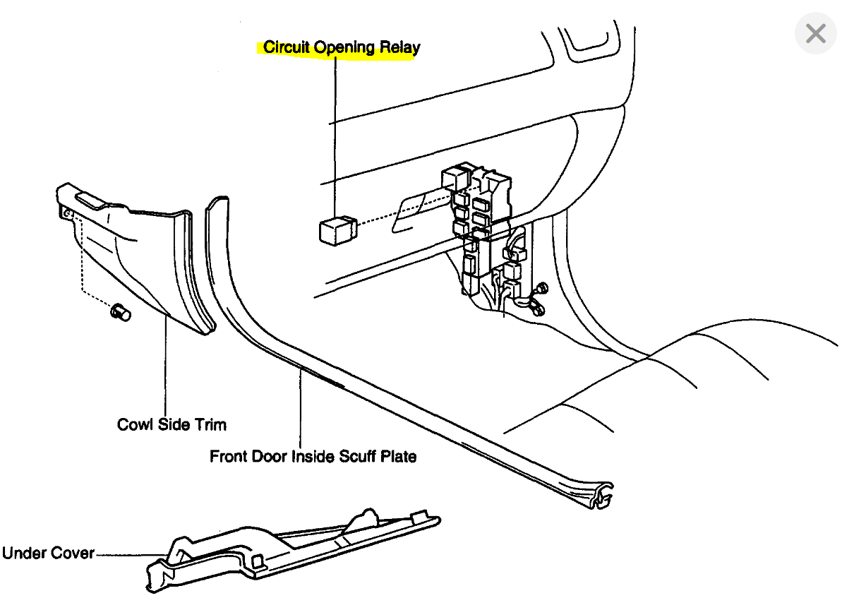

Do you hear the fuel pump when the key is turned to the on position?

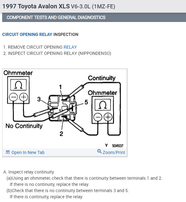

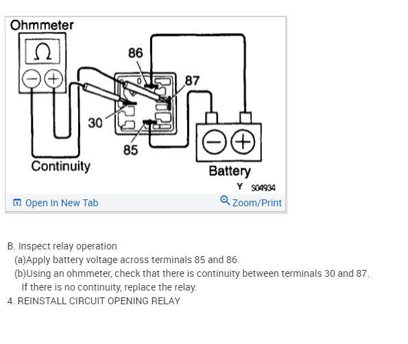

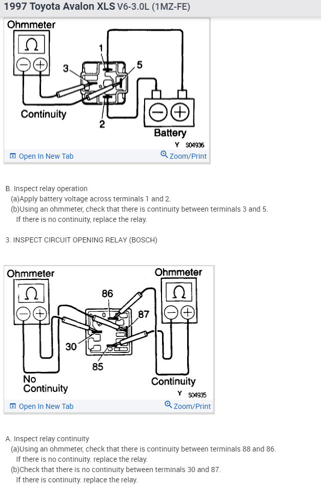

The fuel pump relay (circuit opening relay) is located on the fuse panel on the passenger side footwell fuse panel (see diagram below).
Here is a helpful guide on how to test the relay:

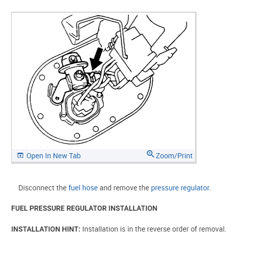

Another possibility is if the pump is functional and the relay is good, then there could be a fuel flow issue at the injectors. Which could be due to a bad fuel pressure regulator.
This vehicle should have 44-50 PSI of fuel pressure with the key on and engine off.

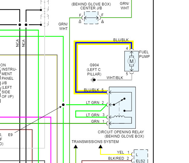

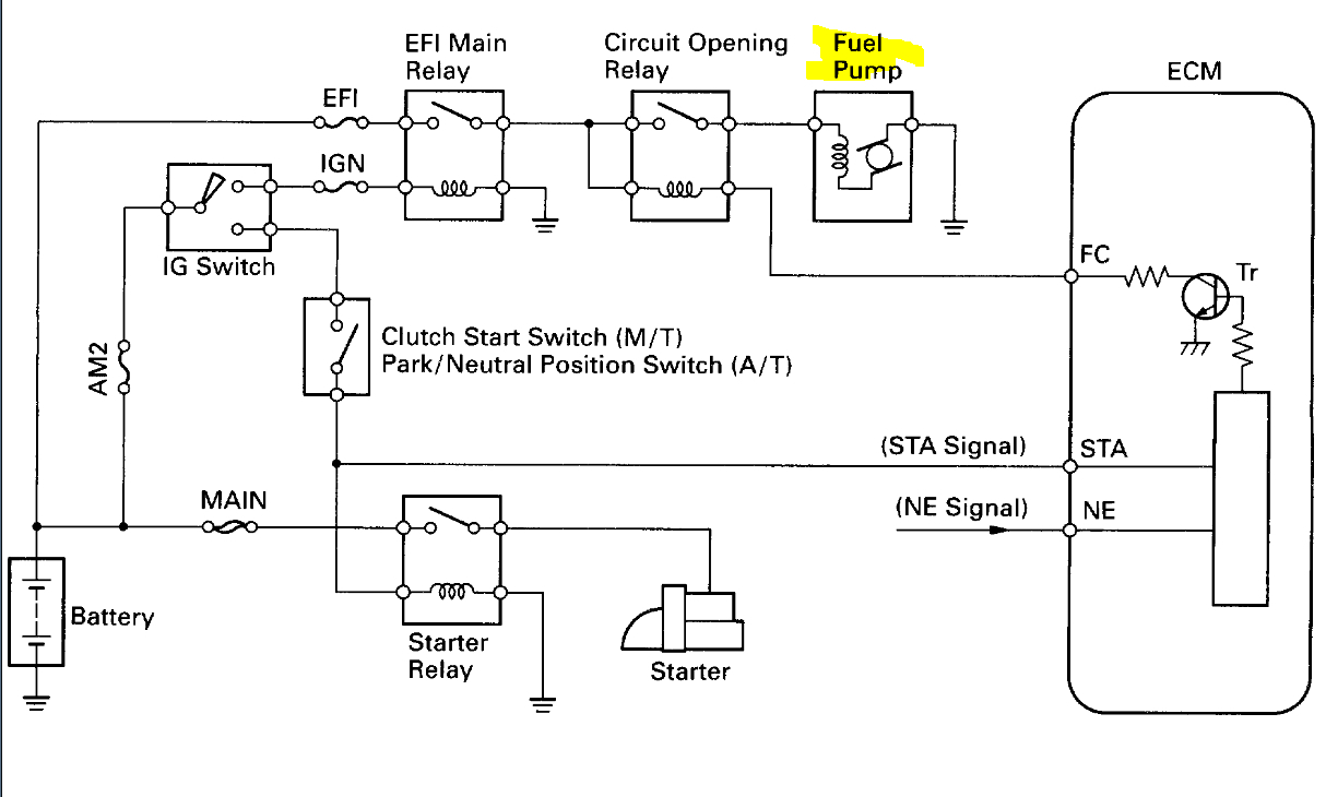

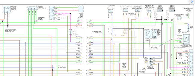

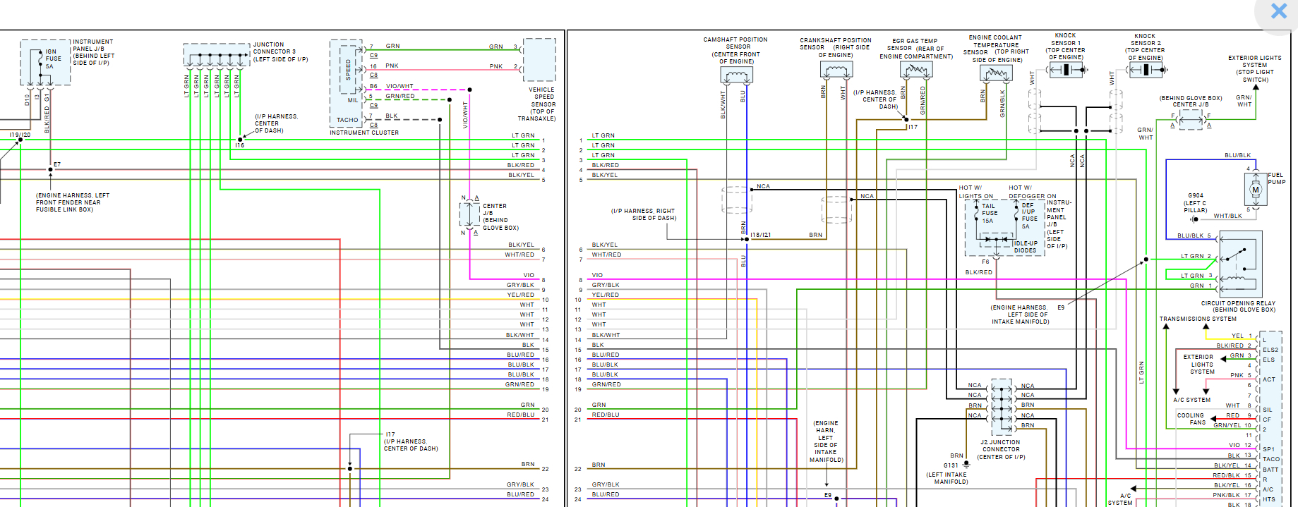

So, if you are not getting power and you have a known good pump, and relay is good and have power, then the issue should be the wiring to the pump. It could be power wire or a bad ground, which is on the left C pillar.
I have attached the wiring schematics below.

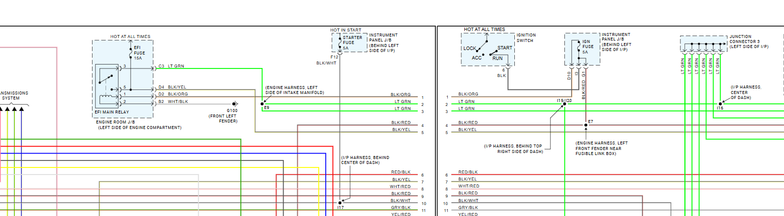

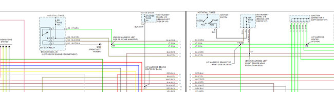

  • 55,763 POSTS
So, the circuit open relay its its power from the EFI main relay, with the key on please check both lt-grn wires at the circuit open relay they both should have 12 volts, here is the wiring diagrams so you can see how the system works and what I am talking about. Check out the images (below). Let me know how it goes
Jul 28, 2026 at 5:41 PM

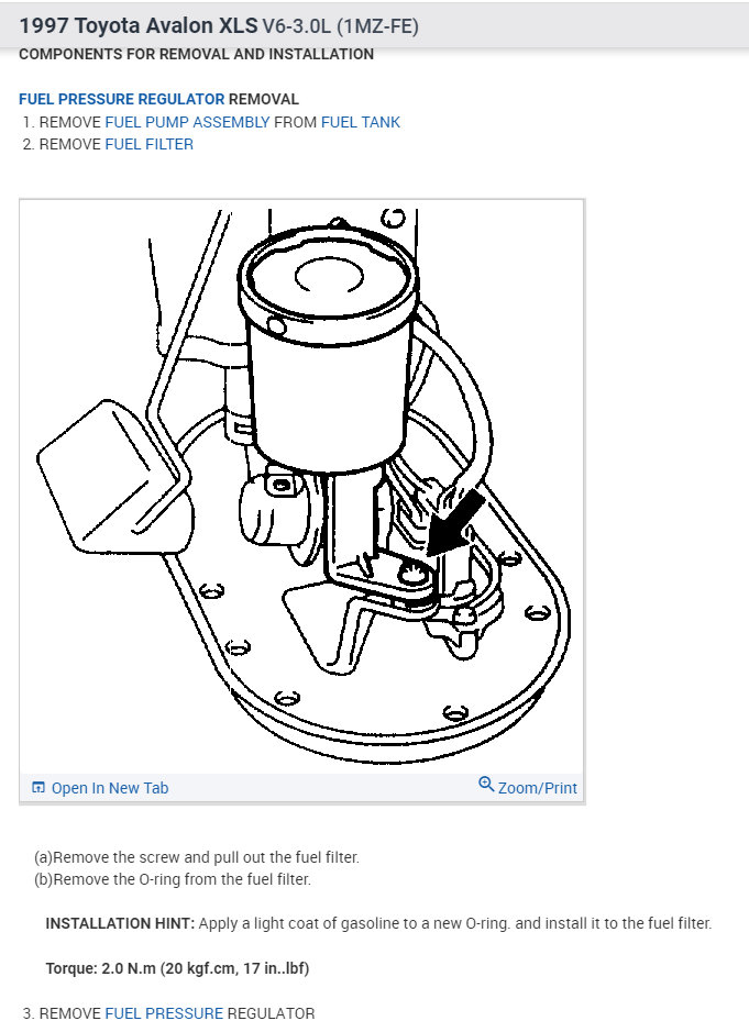

Question #3 The circuit open relay should have 3 wires going to it, blu/blk, lt/grn and green.
Question #4 with the key on the lt/grn wires should have power, the blu/blk should have power as well which goes to the fuel pump, the green wire grounds from the engine computer, please upload an image when you get home and have a nice day!! Let me know.

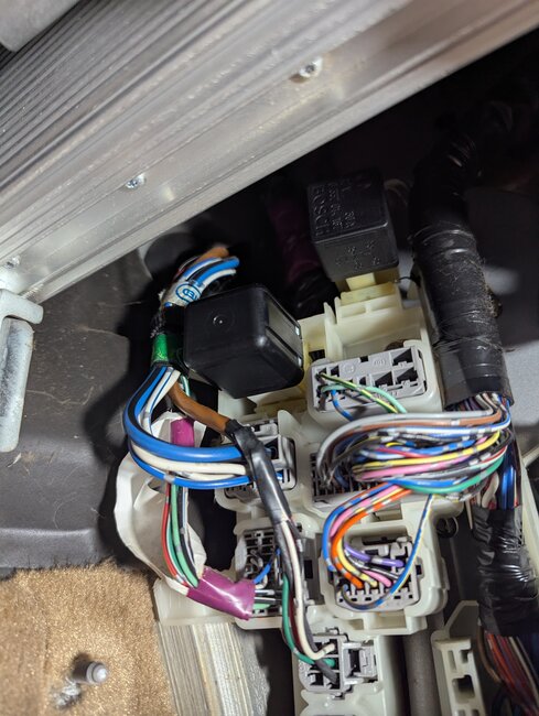

CONJH13
  • 10 POSTS

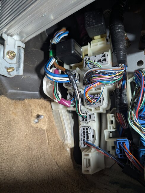

Ok, so the EFI relay is definitely activating. I was able to confirm that.

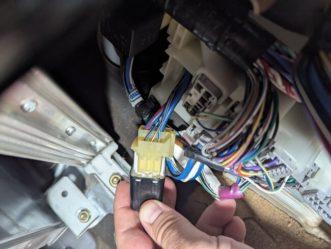

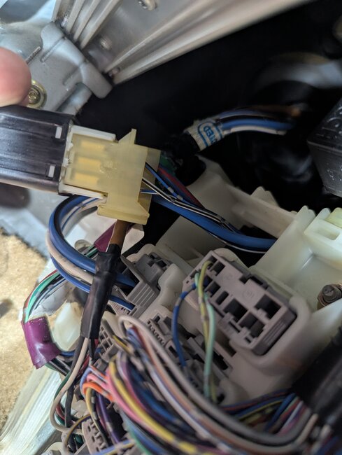

Here are some photos of what I believe is the open circuit relay. The wire colors just don't match what you're saying, so I'm not sure what's what.
Jul 29, 2026 at 3:07 PM
CONJH13
  • 10 POSTS
I did some testing with my multimeter, which left me even more confused. On that relay in the photos, when turning the key to On, I do get 12 voltage on the blue/black wire. I get a good ground on the middle (white/black) wire. But on the white/blue wire, I get some grounding, but over 700 ohms of resistance, at the socket. But on the back side of the socket, I get a solid ground with almost no resistance. When I tried temporarily grounding that pin, what changes is that the fan comes on for the heating/cooling. I'm not sure how to make sense of that.
Jul 29, 2026 at 3:34 PM

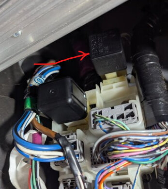

  • 55,763 POSTS
The EFI relay gets its power from the EFI fuse which is in the fuse panel under the hood. Please check the relay I have marked here.
Jul 30, 2026 at 8:19 AM

CONJH13
  • 10 POSTS
Ok, here's what I learned.
1. That is definitely the correct relay. Thank you!!
2. When I check voltage from the lt grn to ground, I get 12v when the key is turned On.
3. When I check voltage from lt grn to green, I get about 2.5 - 3v when the key is turned On.
4. Checking resistance from the green to ground with my multimeter set to 2000k ? it shows a value of about 900.
5. When I made a temporary ground from green to ground, turning the key to On caused the fuel pump to run, but the relay still did not activate. Also, the car did not start.
6. Checking resistance on the green wire from the relay socket to the ECU socket showed 0.
Jul 30, 2026 at 4:04 PM
