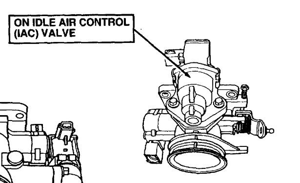

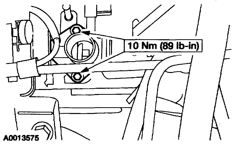

I need to know where the IAC valve is exactly.
May 11, 2019 at 6:47 PM
EASTTOSAYTHELEAST01
This is a 03/04 Ford f150 5.4 Triton.
May 11, 2019 at 6:49 PM
  • 110,194 POSTS
Welcome to 2CarPros.
I'm not sure if you mean an 03 or an 04. I will provide info on both. First is related to the 04.
The IAC is part of the throttle body assembly. I attached the only pic I could find that may help you. The IAC valve assembly is not adjustable and can not be cleaned.

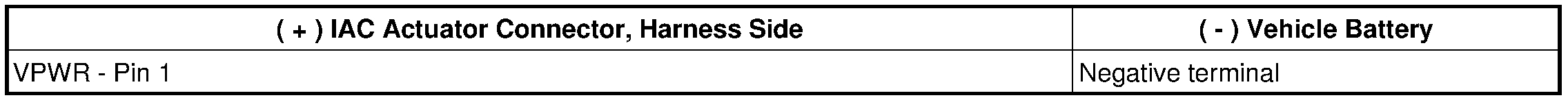

KE2 DTCS P0505, P0506, P0511, P1504 OR P1507: (OR STARTS ONLY AT PART THROTTLE) CHECK THE VPWR VOLTAGE TO THE IAC VALVE
Note:If EGR DTC P0402 was output during the self-test, diagnose it first before continuing with this pinpoint test.

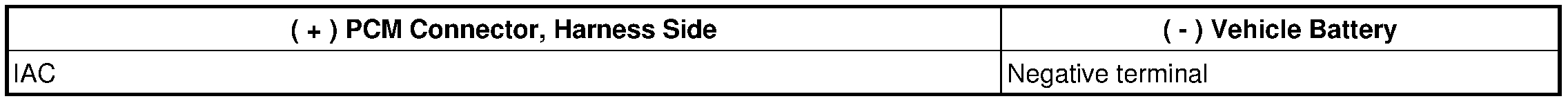

- IAC Actuator connector disconnected.
- Key in ON position.
- Measure the voltage between:
picture 1
Is the voltage greater than 10.5 V?
- Key in OFF position.
- GO to KE3
- Key in OFF position. REPAIR the open circuit.

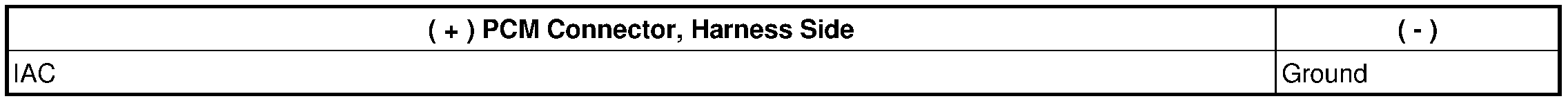

KE3 CHECK THE RESISTANCE OF IAC VALVE
- Measure the resistance between:
picture 2
Is the resistance between 6 ohms - 15 ohms?
- GO to KE4
- INSTALL a new IAC Valve.

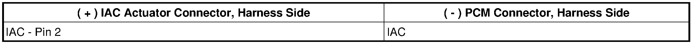

KE4 CHECK THE IAC VALVE FOR AN INTERNAL SHORT TO THE IAC CASE
picture 3
Is the resistance greater than 10K ohms?
- GO to KE5
- INSTALL a new IAC actuator.

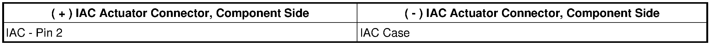

KE8 CHECK THE IAC CIRCUIT FOR A SHORT TO POWER IN THE HARNESS
picture 5
Is the voltage less than 1 V?
- GO to KE9
- Key in OFF position. REPAIR the short circuit.

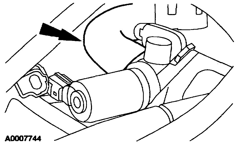

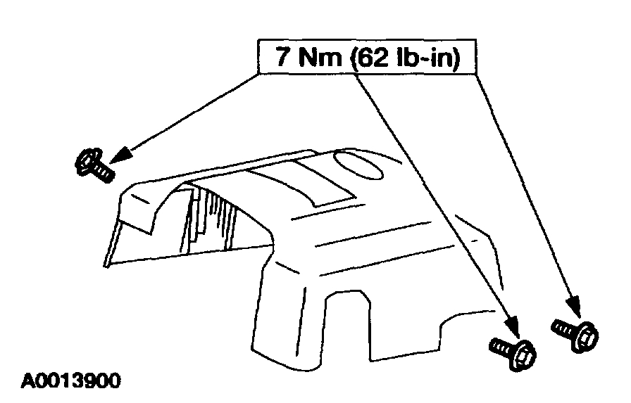

Next, I will review the 2003.
Again, the IAC is located on the throttle body. Here are directions for removal and replacement. The location is indicated in the directions. The remaining 4 pics correlate with these directions.
____________________________________________
PROCEDURES
REMOVAL
1. Disconnect the battery ground cable.
picture 10

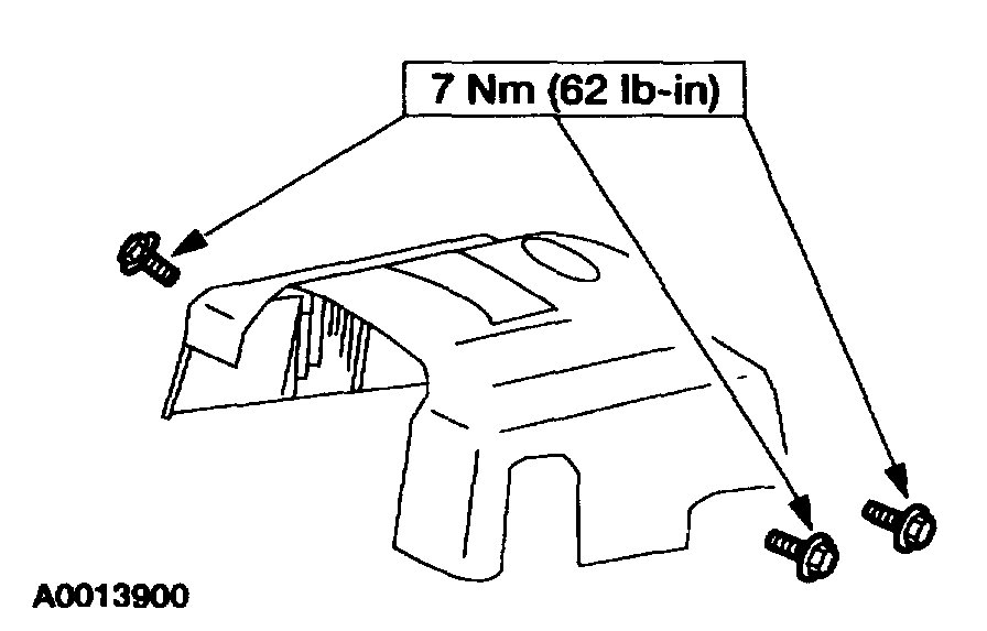

2. Remove the bolts and the accelerator control splash shield.
picture 11

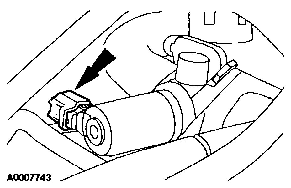

3. Remove the Idle Air Control (IAC) valve electrical connector.
picture 12
4. Disconnect the throttle bypass hose.
picture 13
5. Remove the bolts and the IAC valve.
INSTALLATION
1. To install, reverse the removal procedure.
Let me know if this helps. Also, if you let me know the symptoms and if there are any codes, I may be of more help.
May 11, 2019 at 7:22 PM

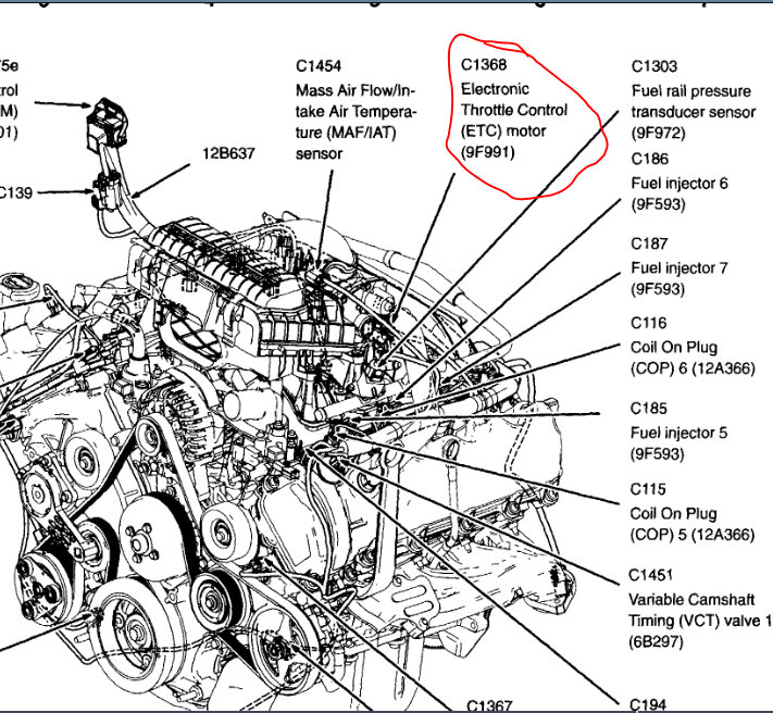

DANNY L
  • 5,648 POSTS
Hello, I'm Danny.
I'm not showing an IAC valve on that motor however, it does show An Electronic Throttle Control Motor. I've attached a picture below and circled in red.Hope this helps and thanks for using 2CarPros.
