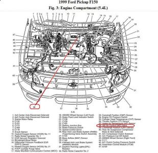

Where is the IAC unit on the intake manifold located at of a 1999 Ford F150?
Apr 1, 2009 at 4:19 PM
BLUELIGHTNIN6
  • 16,542 POSTS
4.2L , 4.6L or 5.4L engine ?
Apr 1, 2009 at 4:22 PM
STEVEN_BARFIELD
  • 7 POSTS
Where is the IAC unit on the intake manifold located at on a 1999 Ford F150 V8 5.4 L Automatic?
Apr 1, 2009 at 4:31 PM
BLUELIGHTNIN6
  • 16,542 POSTS
It is located on the left side of the intake manifold, pictured below..
