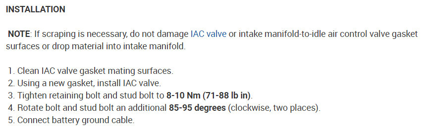

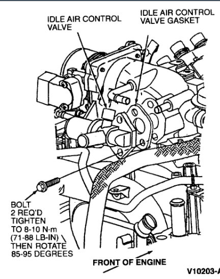

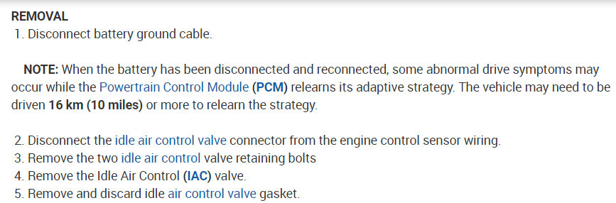

Here is a tutorial for you to view on idle air control valve replacement:
https://www.2carpros.com/articles/how-to-replace-an-idle-speed-control-motor-iac
I've attached below picture steps and the location for replacement on your car. Hope this helps and thanks for using 2CarPros.
May 5, 2021 at 6:19 AM
Suggested Repair
Replace the idle air control (idle speed control) valve, using the location and replacement steps provided.
