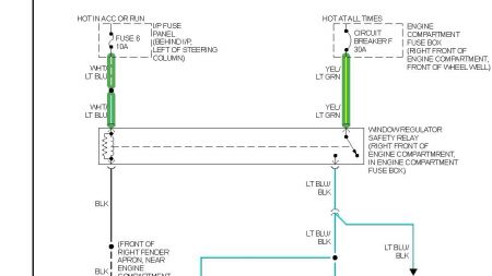

I have a 1993 Lincoln Town Car Executive Series with a V8. The power windows, clock, and radio all have quit working. Do you have any idea what fuse or relay it could be or if something else it could be. Thank you.

Check the fuse/breaker/relay look below for location
https://images.2carpros.com/forum/automotive_pictures/12900_NOOOOO_1.jpg
