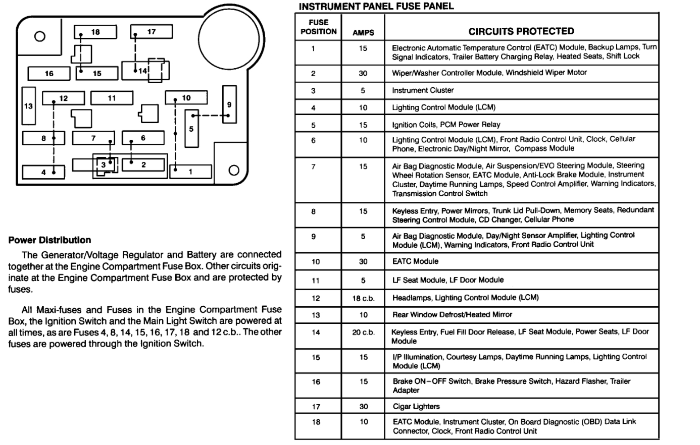

I have a 1995 Lincoln Towncar Signature series, 196,000. When I turn my headlights on, my clock turns off. Any ideas?
Aug 26, 2006 at 2:41 AM
COURTNEYB
It's best to start with the simplest things first. Have you checked your dimmer switch? The dash lights, including the clock, will automatically get dimmer when the headlights are turned on but can be brightened by adjusting the dimmer switch. If that checks out, you can check the fuse panel next to make sure you don't have any blown fuses which could be affecting the clock. I've posted a diagram of the fuse panel below. Please let us know what you find out and if you need more help please don't hesitate to ask!
