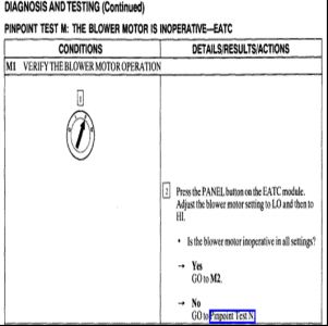

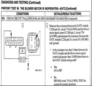

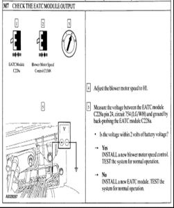

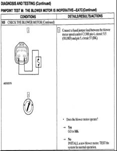

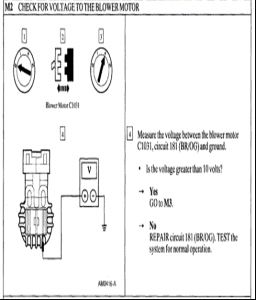

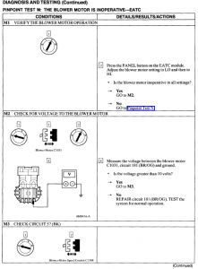

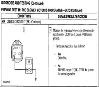

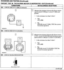

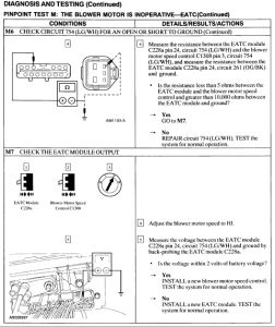

My car is the "Signature Series" w/Electronic Automatic Temperature Control. The blower does not run but the temperature regulates perfectly (makes heat and runs the AC compressor). I checked with ohmmeter and full +plus voltage is present on the red wire but there is no ground on the black. If I connect a ground directly to the connector, the blower runs but at full speed only.I have taken it to various mechanics with no luck but I am trying to avoid going to the $117.00/hr dealer.
Anyone help me out?

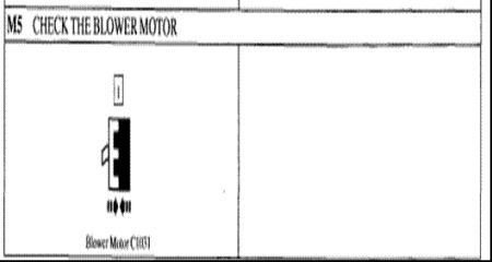

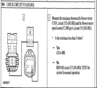

Hello - I have attached a troubleshooting chart for you.............see how this does......... If you cannot see it after you copy and paste.....let me know and I will try something else so you can see.
https://images.2carpros.com/forum/automotive_pictures/248015_1_157.jpg
https://images.2carpros.com/forum/automotive_pictures/248015_2_105.jpg
https://images.2carpros.com/forum/automotive_pictures/248015_3_73.jpg
https://images.2carpros.com/forum/automotive_pictures/248015_4_48.jpg

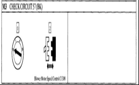

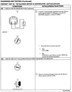

The text from the car manuel you sent is too small for me to read. Please send in a larger font.

Hello - I had to break it up some....see how this does. Also, it appears this may have distorted it. Did you try right clicking on it, copy and paste or right click and save picture as to another location and then bring it closer?
https://images.2carpros.com/forum/automotive_pictures/248015_Picture1_45.jpg
https://images.2carpros.com/forum/automotive_pictures/248015_Picture2_36.jpg
https://images.2carpros.com/forum/automotive_pictures/248015_Picture3_24.jpg
https://images.2carpros.com/forum/automotive_pictures/248015_Picture4_20.jpg
https://images.2carpros.com/forum/automotive_pictures/248015_Picture5_18.jpg
https://images.2carpros.com/forum/automotive_pictures/248015_Picture6_18.jpg
https://images.2carpros.com/forum/automotive_pictures/248015_Picture7_17.jpg
https://images.2carpros.com/forum/automotive_pictures/248015_Picture8_15.jpg
https://images.2carpros.com/forum/automotive_pictures/248015_Picture9_9.jpg
https://images.2carpros.com/forum/automotive_pictures/248015_Picture10_9.jpg
