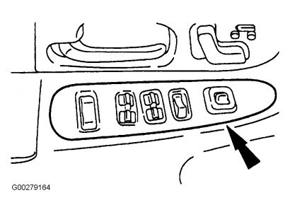

The switch that controls all the windows on the drivers side needs to be replaced. It will put the window down but not up. (That is not without coaxing on my part).
The part is pricy...that's understandable. The R & R is too. That, I would like to save on. I can't imagine it's more than removing a switch assembly and replacing it. Getting the panel off that holds the switch has got me puzzled. So, am I on the right track, and if so how do I go about accomplishing this task.
[img:6f3d3b3353]http://www.2carpros.com/forum/automotive_pictures/534233_Panel_1.jpg[/img:6f3d3b3353]

According to my software,the bezel just pops out of there. Carefully pry up to pop the switch housing out of the door (see pic). Then the switch should just be a plug-n-play item
https://images.2carpros.com/forum/automotive_pictures/1639_Graphic_9.jpg
