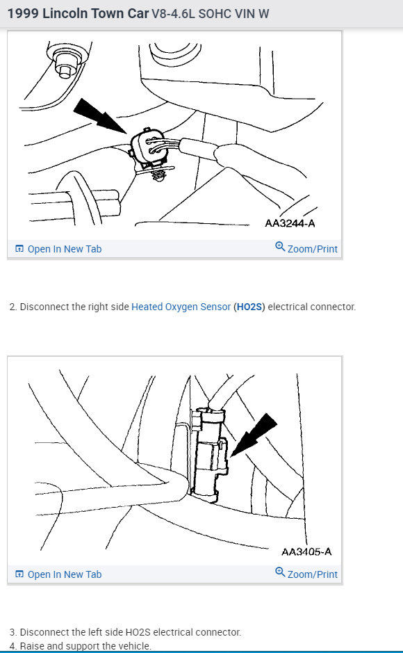

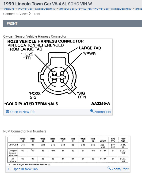

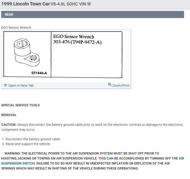

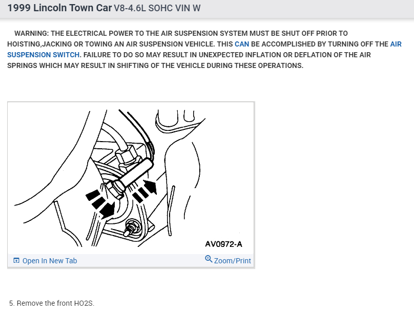

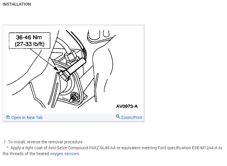

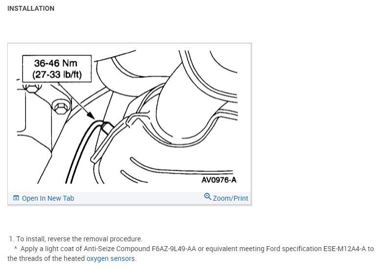

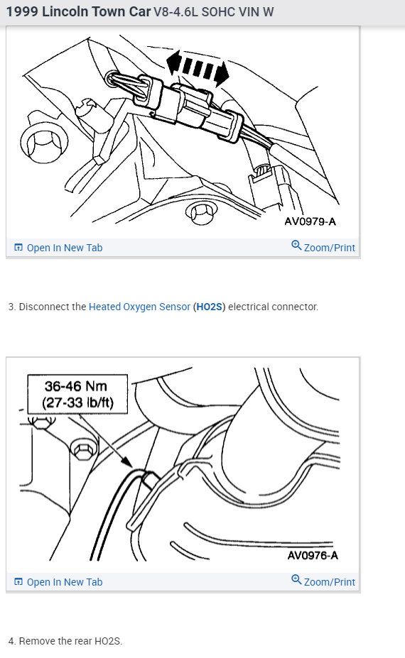

The oxygen sensors can be replace easily.

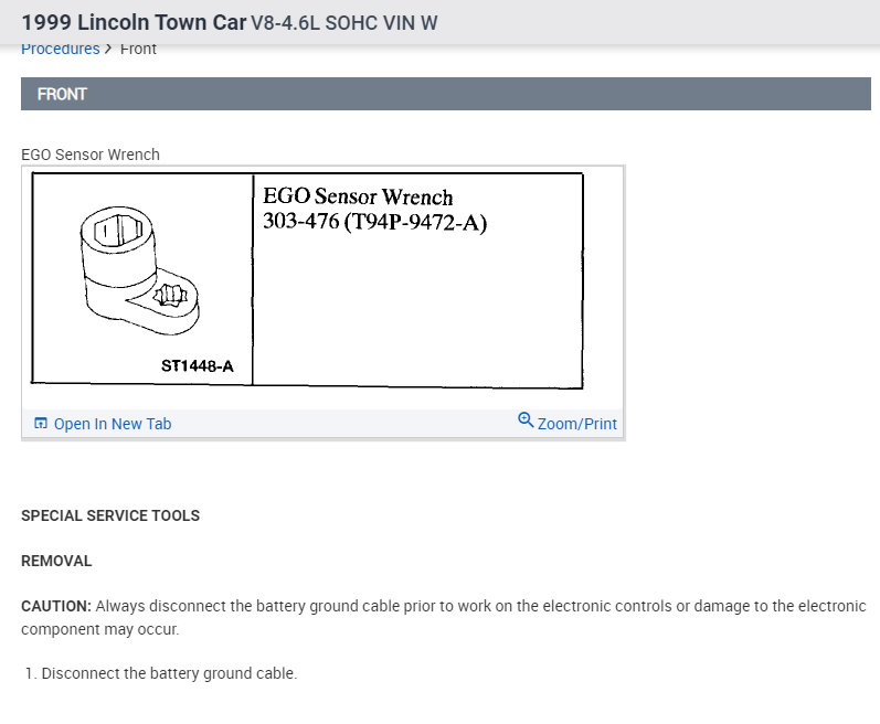

Before getting started you want to make sure that the engine is cool so you don't get burnt from the hot exhaust.
You will need a oxygen sensor socket to perform this task.
Here is a helpful guide on how to replace the sensor:
https://www.2carpros.com/articles/how-to-replace-an-oxygen-sensor
I have attached the complete replacement procedure below.
