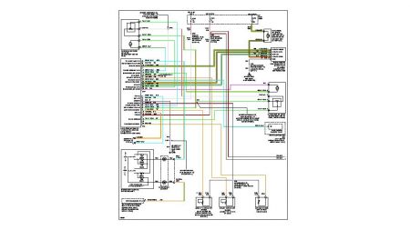

Check the fuse no.2 30amp at instrument panel fuse panel. If okay test the blower motor speed control in right rear of engine compartment on the evaporator.
Also the electronic automatic temperature control module behind center of dash. See below circuitry
