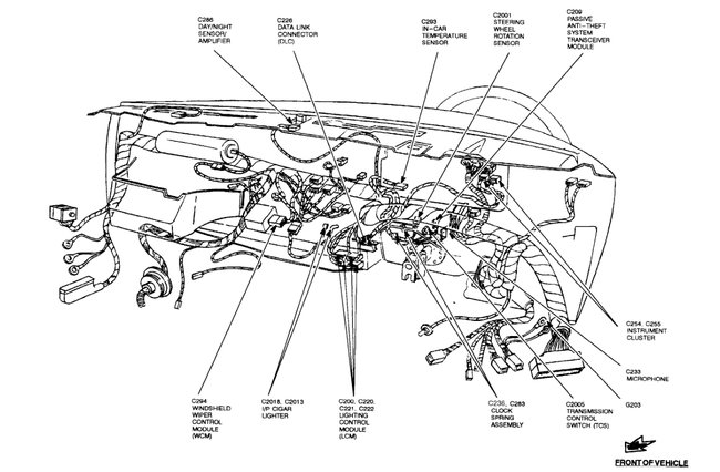

Both turn signals don't work. No turn signal lights on dash or outside front or rear. The left multi switch lever on steering column operates turn signals, emergency warning flashers, wipers and high beams. Wipers, emergency warning flasher, and high beams all work fine from this l same ever, but not either turn signal. Fuse for turn signals checks out okay. Rear back up and brake lights work fine.
Is there a separate flashing unit for turn signals on this car that might be out and if so, where is it on this car? Is the problem the turn signal multi switch, even though other functions for this switch work well?
Sep 7, 2010 at 1:08 PM
  • 55,443 POSTS

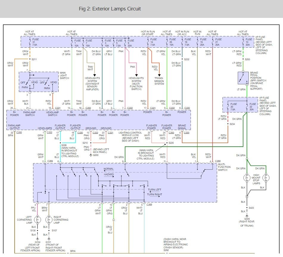

There is a lighting control module that sound like it may have gone out, here is a wiring diagram for the blinkers that you can use for some testing and a guide to show you how. Here is the location of the lighting module so you can change it out:
Please run some tests and get back to us so we can continue helping you.Check out the diagrams (below). Please run this test and get back to us.

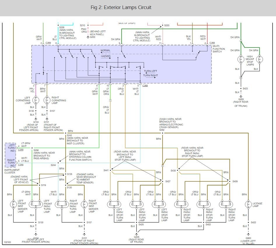

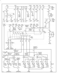

I received a schematic but there is no way for me to read it. Please send a larger jpg schematic I read in Paint. Thanks Bill
Apr 16, 2020 at 3:48 AM (Merged)
MIKE H R
  • 3,094 POSTS
here is a diagram of the exterior lights including the signal lights. Sometimes the diagrams don't come out right. If not save it to your pictures then you can enlarge it. What it sounds like is there is a break in the power to the signals. the multi function switch could be bad.
https://images.2carpros.com/forum/automotive_pictures/54223_lincoln_town_car_exterior_lights_1.jpg
MLAWSON
I had a bad turn signal switch fixed my car I took it to my mechanic that's what he said was wrong.
