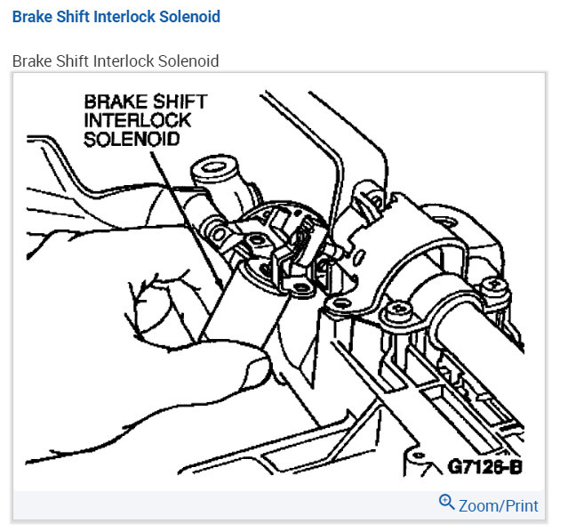

My car will not will not shift out of park. Please help

This sounds like the interlock control solenoid has gone out which is common here is the location so you can confirm its getting power but not working so you can replace it.
Removal
1. Disconnect battery ground cable and air bag backup power supply.
2. Remove lower RH and LH mouldings from instrument panel by pulling up and snapping out of retainer.
3. Remove five retaining screws from instrument panel lower cover and remove cover.
4. Remove instrument panel reinforcement.
5. Disconnect transmission range selector cable from actuator housing by removing one screw.
6. Remove four column attaching nuts and lower column assembly.
7. Remove electrical harness from brake shift interlock (BSI) solenoid assembly.
8. Remove three screws attaching BSI solenoid and insert plate to column assembly and remove solenoid and insert plate. Separate solenoid from insert plate by removing tinnerman clip.
Installation
1. Position BSI solenoid and insert plate in place and attach to column assembly with three screws as shown.
2. Connect electrical harness to BSI solenoid.
3. Attach column assembly to half car beam with four nuts.
4. Connect transmission range selector cable to column assembly with one screw.
5. Attach instrument panel reinforcement brace with three bolts.
6. Attach instrument panel lower trim cover with five bolts.
7. Install RH and LH mouldings on instrument panel.
8. Connect airbag backup power supply and battery ground cable.

1994LINCOLN
Column shift will not shift out of park the steering wheel lock allows the steering wheel to freely turn the ignition without the key in it will rotate 360

Faulty lock cylinder gear possible broken will not be able to releaase shift cable.
