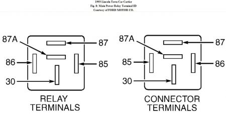

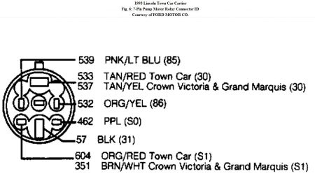

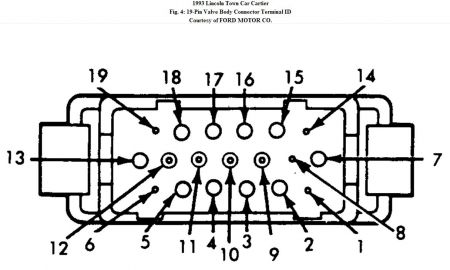

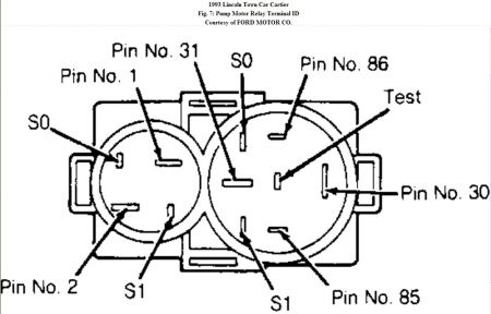

PINPOINT TEST BB - SOLENOID VALVE DIAGNOSIS 1. Code 17 Or 22 Unplug ECU 55-pin connector. Connect breakout box and adapter. Connect jumper wire between breakout box pins No. 19 and No. 34. Measure voltage between pins No. 3 and No. 60. If voltage is at least 10 volts, go to step 2). If voltage is less than 10 volts, repair circuit No. 532 (Orange/Yellow wire), No. 533 (Tan/Red wire) or No. 603 (Dark Green wire) on Town Car, or circuit No. 532 (Orange/Yellow wire), No. 537 (Tan/Yellow wire) or No. 603 (Dark Green wire) on Crown Victoria and Grand Marquis. 2. Measure resistance between breakout box pins No. 3 and No. 20. If resistance is 5-8 ohms, read service codes again. If other codes exist, disregard Code 17 or 22, and service other code (s). If resistance is not 5-8 ohms, go to next step. 3. Unplug valve body 19-pin connector. Measure resistance between pins No. 7 and No. 17. See Fig. 4 . If resistance is 5-8 ohms, repair circuit No. 495 (Tan wire). If resistance is not 5-8 ohms, replace valve body.
https://images.2carpros.com/forum/automotive_pictures/62217_ABS1_1.jpg
https://images.2carpros.com/forum/automotive_pictures/62217_motor_2.jpg
https://images.2carpros.com/forum/automotive_pictures/62217_power_3.jpg
https://images.2carpros.com/forum/automotive_pictures/62217_relay2_2.jpg
https://images.2carpros.com/forum/automotive_pictures/62217_relay_6.jpg
