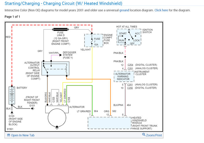

Thank you for your response, however I am unable to read the diagram you sent. It is too small. Also when you say disconnect the harness, there are two plug in type harnesses at the alternator. Which one do I disconnect and them to test the wire would that be at the harness side or at the alternator pins?
Oct 23, 2009 at 7:41 AM
  • 75,992 POSTS
Disconnect the alternator wiring harness and check for power at the light green and red wire do you have it? Below is your charging system wiring diagram.
Oct 23, 2009 at 10:39 AM
  • 75,992 POSTS
Disconnect the one with the light green and red wire-you check at the harness end.
https://images.2carpros.com/forum/automotive_pictures/12900_c1_16.jpg
https://images.2carpros.com/forum/automotive_pictures/12900_c2_14.jpg

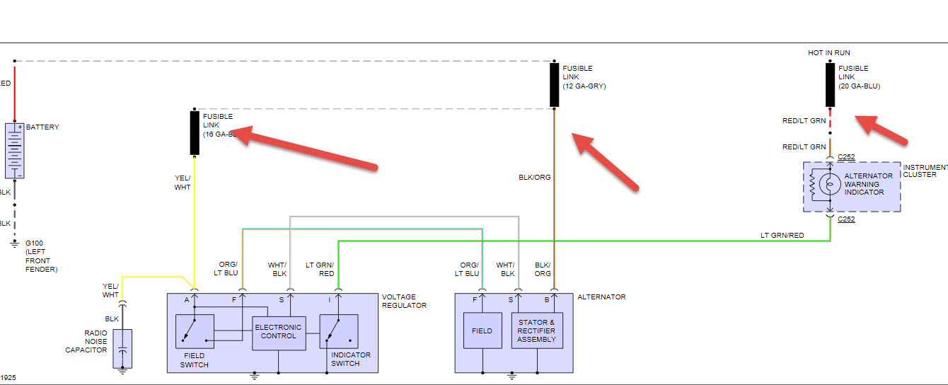

check all the fusible links in picture one or all of them can be blown they will be on starter relay or where positive battery cable hooks up for check engine light, scan for codes. get code get back to us with code. connector is under hood.
