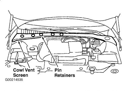

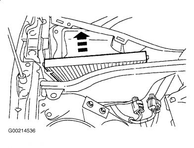

My AC filter light has come on in the the car - It states that it is at 13% (I think) - it beeps at me frequently.
I recently brought my vehicle in and had an oil change and new air filter put on. Is the air filter different from the AC filter?
And is it crucial to have done, if I am not using the AC at this time?
Apr 14, 2009 at 11:44 AM
BMRFIXIT
  • 19,053 POSTS
CABIN AIR FILTER Removal & Installation (2000-2001) Open hood Remove the two part pin-type retainers and separate the velcro attachment of the rubber hinge cover to the rear outboard corner of the cowl vent screen. Pull up on the cowl vent screen to release the lower clips and remove the right side of the cowl vent screen.

https://images.2carpros.com/forum/automotive_pictures/99387_Graphic2_149.jpg
Push on the right corner of the filter to release the clip. Release the left clip and remove the cabin air filter install cabin air filter, reverse removal procedure.
