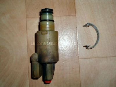

The picture above shows a Town Car vent solenoid removed from the compressor. Notice the corrosion - this is the usual cause of vent solenoid failure. Also notice the broken sealing tip - this occurred when I removed the vent solenoid as it was old and fragile. Vent solenoid testing '96 - '97 Town Cars Switch air suspension off and disconnect the control module connector, next disconnect the compressor connector, then check for battery voltage on the Light Blue/Pink wire, if no voltage check fuse U, if fuse U is okay then you have a wiring fault between the power distribution box and compressor connector. If you had battery voltage, ground the Pink wire on the control module connector, then bridge the Light Blue/Pink and Pink wire of the compressor connector with your voltmeter, you should have battery voltage, if not then there is a fault on the wire between the compressor connector and the control module connector. Next, with the voltmeter still bridging the compressor connector remove the ground from the control module connector, if you still have battery voltage indicated then the Pink wire from the compressor connector to the control module is shorted to ground. NOTE: the wires colors are different on the compressor side of the connector. If the wiring is okay and the previous venting test showed the vent solenoid wasn't venting then you have a bad vent solenoid. TESTING THE HEIGHT SENSOR Wiring colors 1990 - 1994 Pink/White = Power Black/Pink = Ground Orange/Black = Low height input Pink/Black = High height input Wiring colors 1995 - 1997 Purple/Light Green = Power Black/Pink = Ground Orange/Black = Low height input Pink/Black = High height input It is very important to follow these instructions exactly as damage to the height sensor may occur. You will need a REGULATED 3.3volt (+/- 0.3 volts) power supply and a digital ohmmeter (multi-meter) as follows. Connect the positive of the regulated 3.3volt power supply to the Pink/White ('90 - '94) Purple/Light Green ('95 - '97) wire, and the negative to the Black/Pink wire. Connect the RED lead of the ohmmeter (multi-meter on ohms range) onto the Pink/Black OR the Orange/Black wire. Connect the BLACK lead of the ohmmeter (multi-meter on ohms range) onto the negative of the power supply. Observe the reading on the ohmmeter (multi-meter on ohms range) and compare with the table below. AIR LEAKS The most common place for an air leak is the air springs, closely followed by the drier/compressor joint and on early 90s Town Cars on the air line just where the frame goes up over the rear axle. Other suspect places are on the spring solenoids and any place there is an air line joint. To test for an air leak, fill a garden sprayer or spray bottle with a strong soap solution and spray the air springs, air line joints, air lines, or anywhere there is a leak suspected or probable and watch for bubbles. To check if an air spring is leaking, allow the compressor to inflate the air springs to trim height, switch off the air suspension and go for a drive or let sit overnight - if the rear of the cars drops significantly then you can be sure there is an air leak.

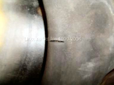

The picture above shows a Town Car air spring with a crack in it that was almost certainly leaking. SOME COMMON FAILURES AND POSSIBLE REASONS Check Suspension light comes on after driving a while: You have an air leak on an air spring that the compressor cannot keep up with. Fuse U keeps blowing: The compressor is being overworked because you have an air leak or the compressor is badly worn and drawing too much current. Rear of car too high: Vent solenoid seized closed so no venting is possible Check Suspension light comes on but the rear height looks okay: The vent solenoid is seized closed so no venting is possible. Moisture is the enemy of the air suspension system and does the most damage to the compressor and vent solenoid usually seizing the vent solenoid closed. The only cure for excess moisture in the system is to replace the compressor/drier assembly, both rear air springs/spring solenoids, and blow through the air lines with compressed air. NOTES ABOUT SAFETY Please observe all proper safety procedures when working on your air suspension. The air suspension on/off switch (in the trunk) should always be turned off before testing or repairing the air suspension, however during certain tests it may be necessary to turn it back on. If you need to gain access to the underside of your car: Only lift your car on firm level ground Only jack on approved jacking points or frame Always engage the parking brake Always put the gear shift into park (or in 1st gear for stick shift) Chock the wheels remaining on the ground Always use jack stands Finally switch off the air suspension If you are working under the hood: Park on firm level ground Always engage the parking brake Always put the gear shift into park (or1st gear if manual) Switch off the air suspension Do not work on an engine that is running Beware of hot components if recently run If you are working on electrical components: Beware of accidental short to ground Beware of accidental short between pins of an harness connector Disconnect the battery during component replacement SUMMARY If you have made it this far you should have tested the fuses, the power feeds, the door open inputs, the compressor, the compressor relay, the vent solenoid, the spring solenoids, the height sensor, all wiring for the previous and for air leaks, so by a process of elimination if a fault still exists it should be with the control module.
