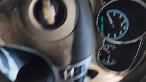

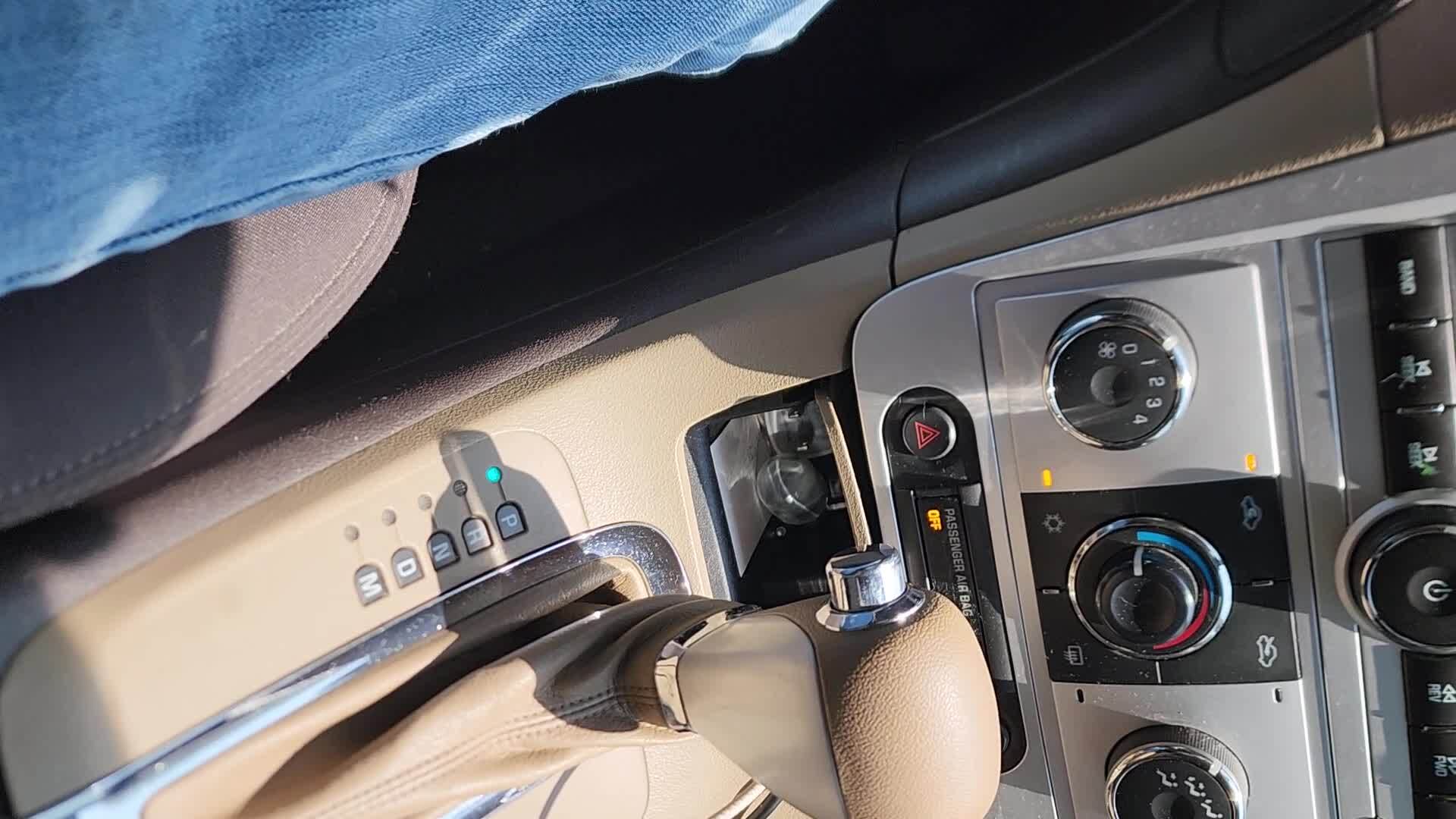

New throttle body and accelerator pedal and the problem still occurs. Car idles fine in park as well as revving. When I go into drive it's fine. It's only when I press the pedal down rapidly in drive it does this. I can very slowly accelerate and it's ok but it's too slow to being pulling out in traffic.

The light that turned on, is that a skid control light? Sorry, it's blurry when I watch it. Also, have you scanned for diagnostic trouble codes? Are there any presents and if so, could you let me know?

Main codes were for throttle body and pedal position sensor. Some for O2 sensors and 1 for emissions (fuel cap). I did a relearn process and nothing changed but someone told me to drive it around and so I did. I probably drove about 10 miles and now it no longer does this, for now. I think it might be fixed. Thank you! And yes, that was the traction and ABS light. It comes on every time a chevy goes into reduce engine power mode.
