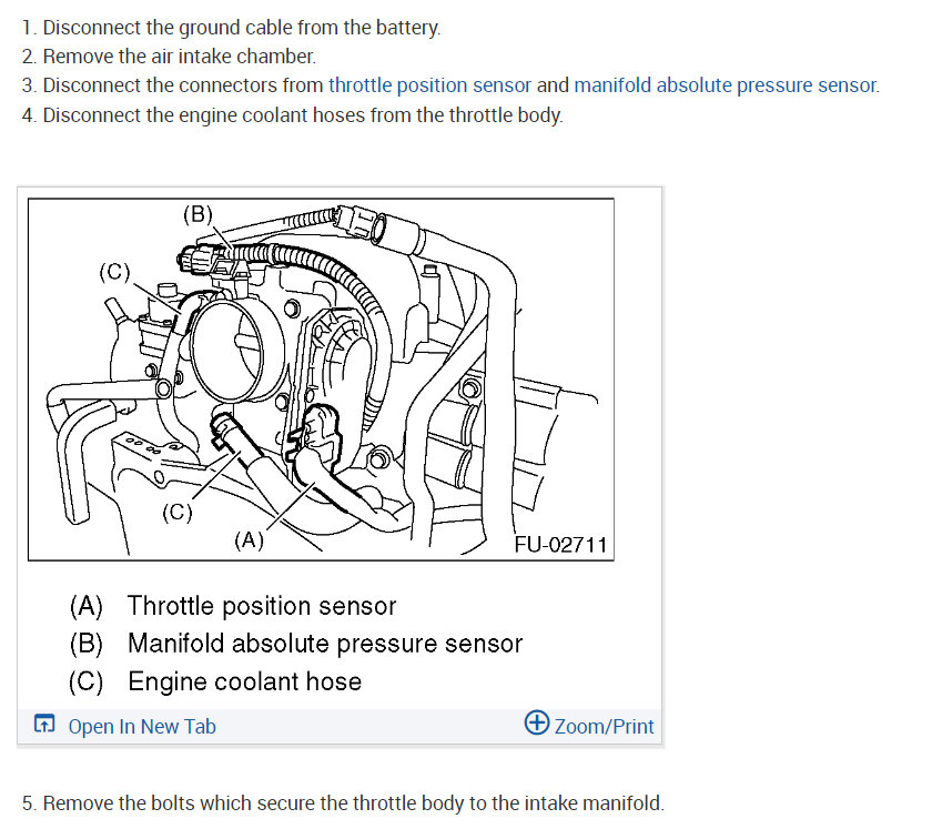

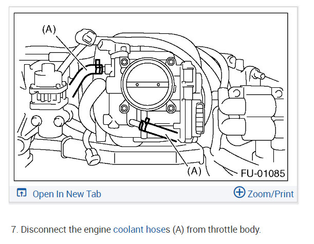

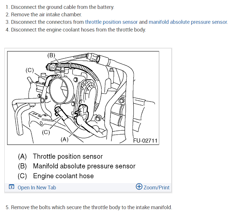

The throttle body actuator control low circuit is the clue, sometimes when a throttle body is that dirt you just need to replace it. Did you clean both sides of the throttle body butterfly and then clear the codes? If so, I would replace the throttle body. This guide can help
This guide can help:
Please go over this guide as well:
https://www.2carpros.com/articles/reduced-power-limp-mode
Here is how to replace the throttle body correctly in case you need it.
INSTALLATION
Install in the reverse order of removal.
NOTE: Use a new gasket.
Tightening torque: 8 N.m (0.8 kgf-m, 5.8 ft-lb)
Check out the images (below). Please upload pictures or videos in your response of any problems so we can see what to help you with.
