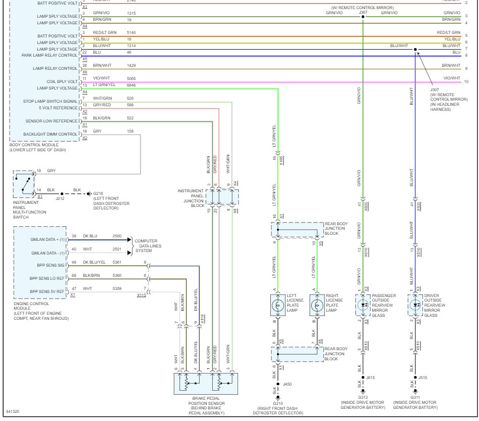

The driver’s side brake and turn signal won’t work and can’t find fuse. Put a new bulb in and still won’t work.
Aug 28, 2023 at 4:11 AM
  • 55,423 POSTS

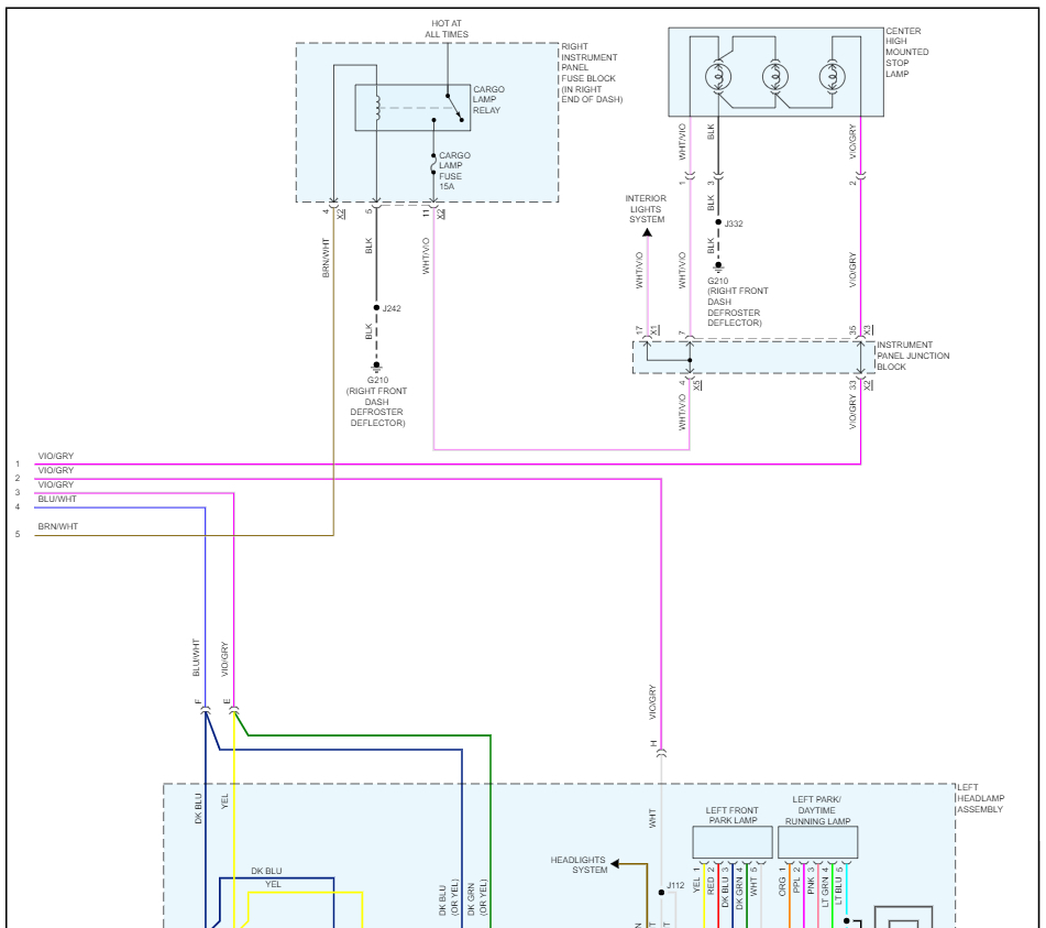

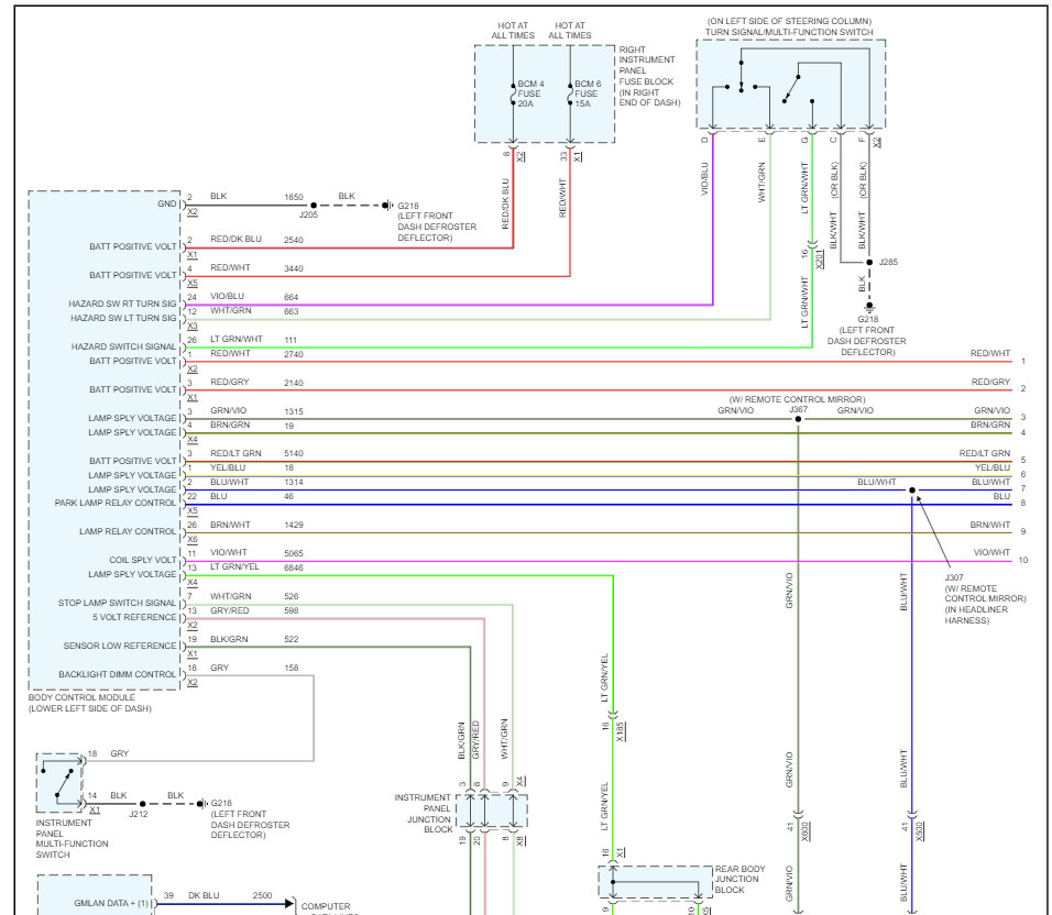

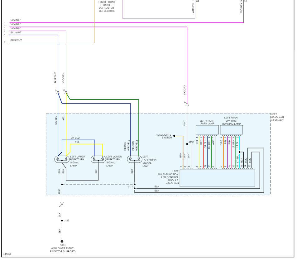

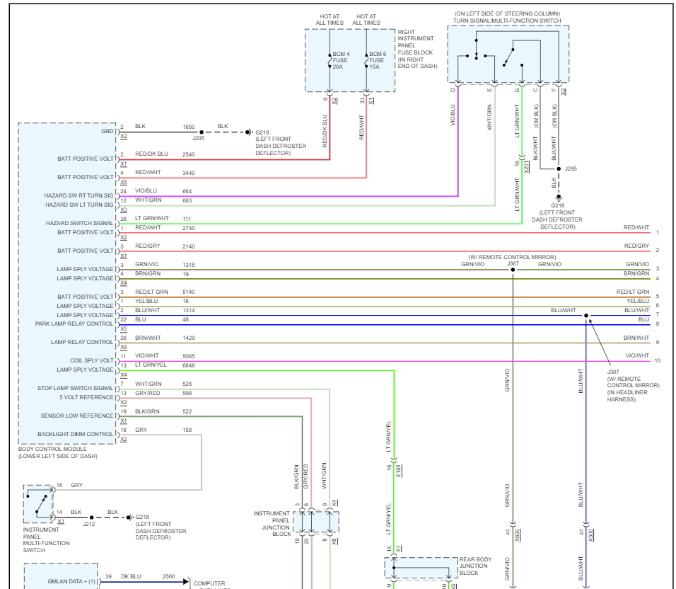

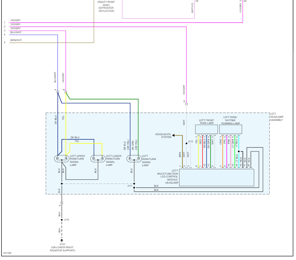

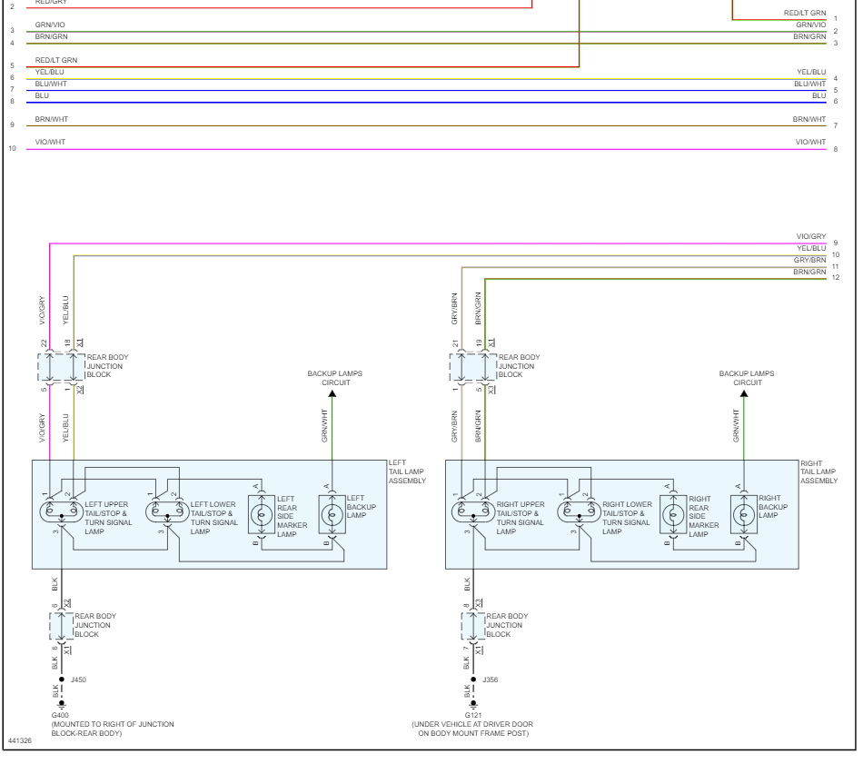

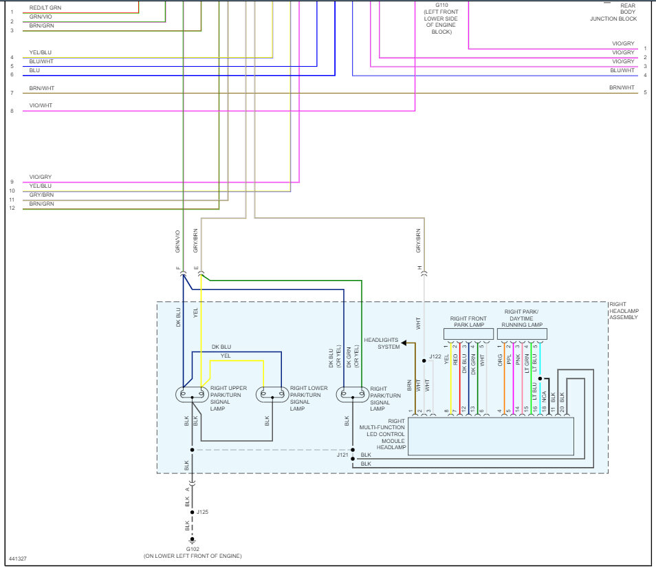

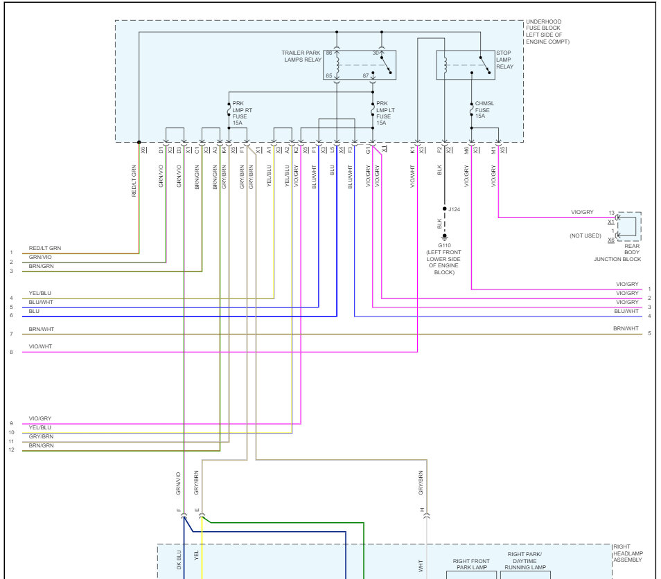

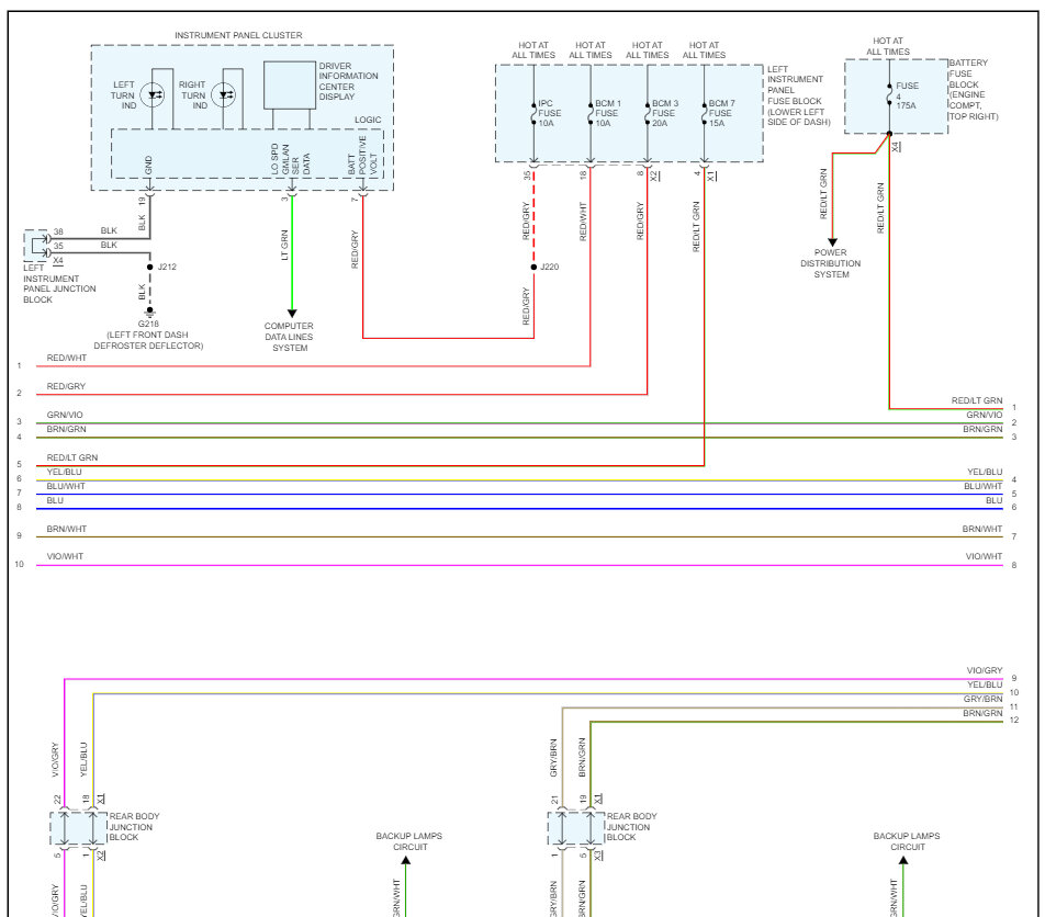

There are many fuses that run the system which need to be checked because the lighting systems are run by the BCM, here is a guide to help and I have included the fuse location as well. If all fuses are good, I would check the ground (g400) for the bulb socket. Here is the blinker and brake light wiring diagrams so you can see which fuses to check plus a guide to help check the ground.
and

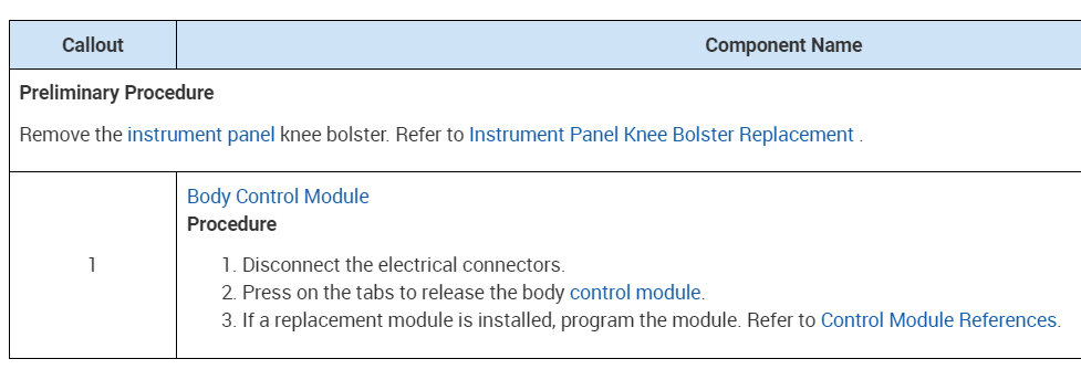

If the fuses and grounds are good the BCM could be out but to be sure let's do a CAN scan. You can get a CAN scanner (Controller Area Network) which will work on most cars from Amazon.
https://youtu.be/u-4syLc-ifQ

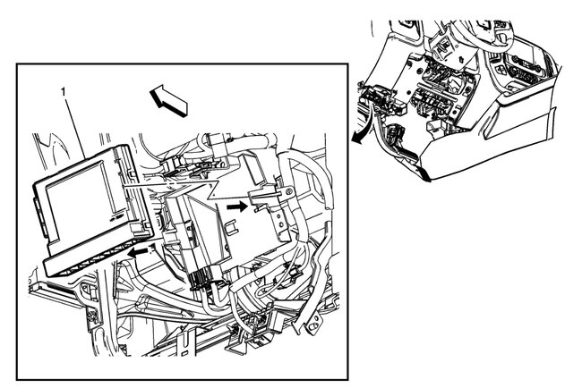

If it comes up with e code for the BCM you can get a preprogrammed unit by searching Google or Ebay. Here is how to change out the BCM as well. Check out the images (below). Please let us know what happens.
