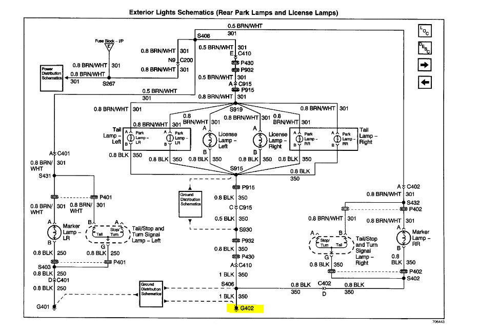

license plate lights no working
2001 BUICK REGAL
1,000,000 MILES • 3.8L • V6 • 2WD • AUTOMATIC
SHREDDER63
The fuse is good, bulbs good. I used a light tester on the socket it has power but does not light them up. it's connected to a center panel on the trunk and none of the lights on the center panel work and that includes the reverse lights.
Oct 21, 2019 at 4:11 PM
SCGRANTURISMO
  • 4,897 POSTS

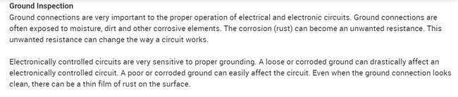

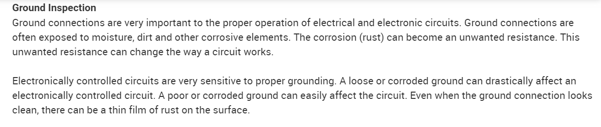

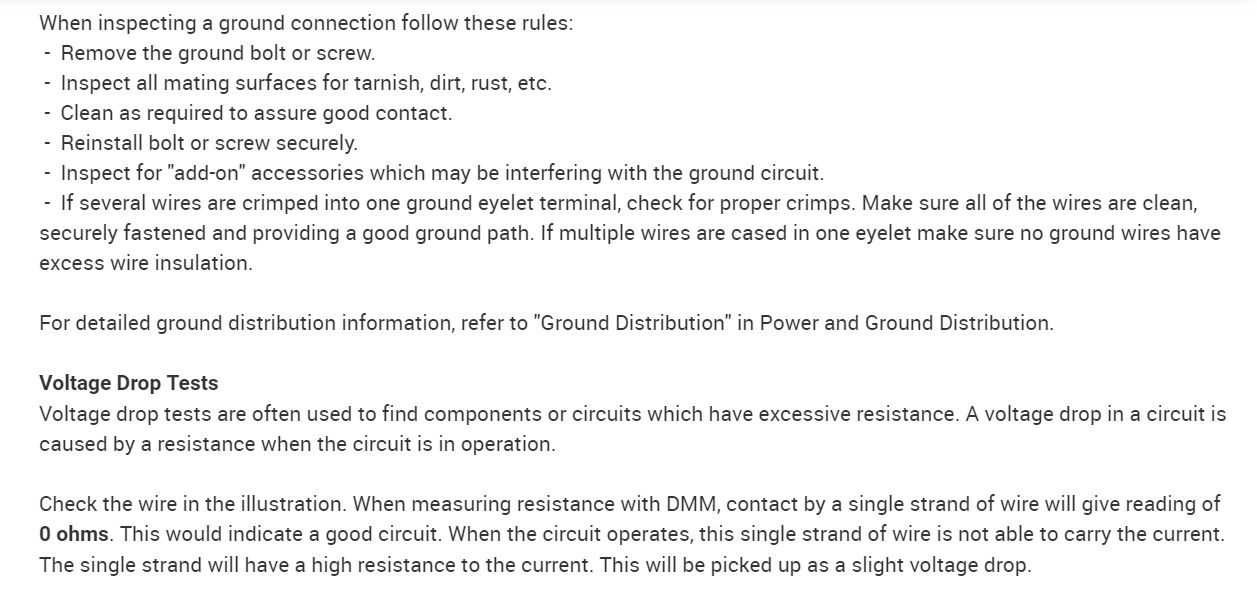

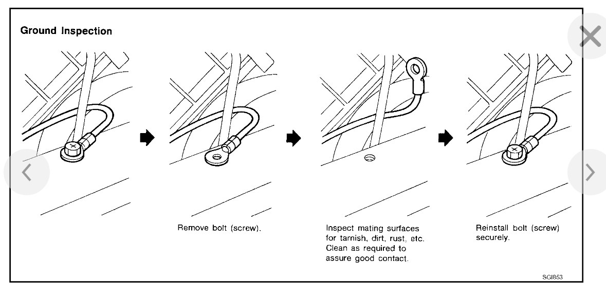

This could be a problem with Ground 402. In the diagrams down below I have included a wiring diagram of the license plate lamps and a guide on how to inspect vehicle grounds. Please go through these guides and get back to us with what you are able to find out.
Thanks,
Alex
